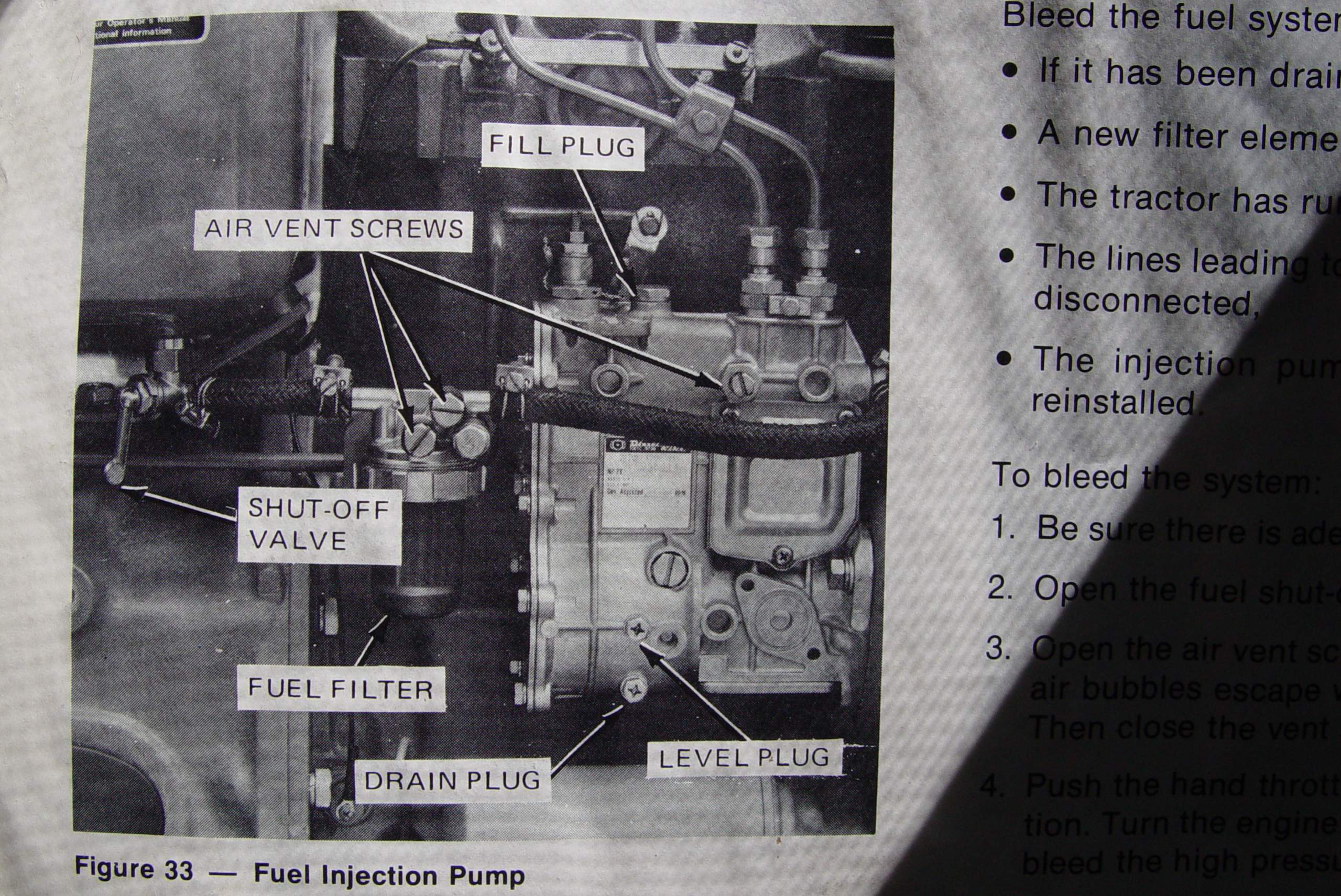

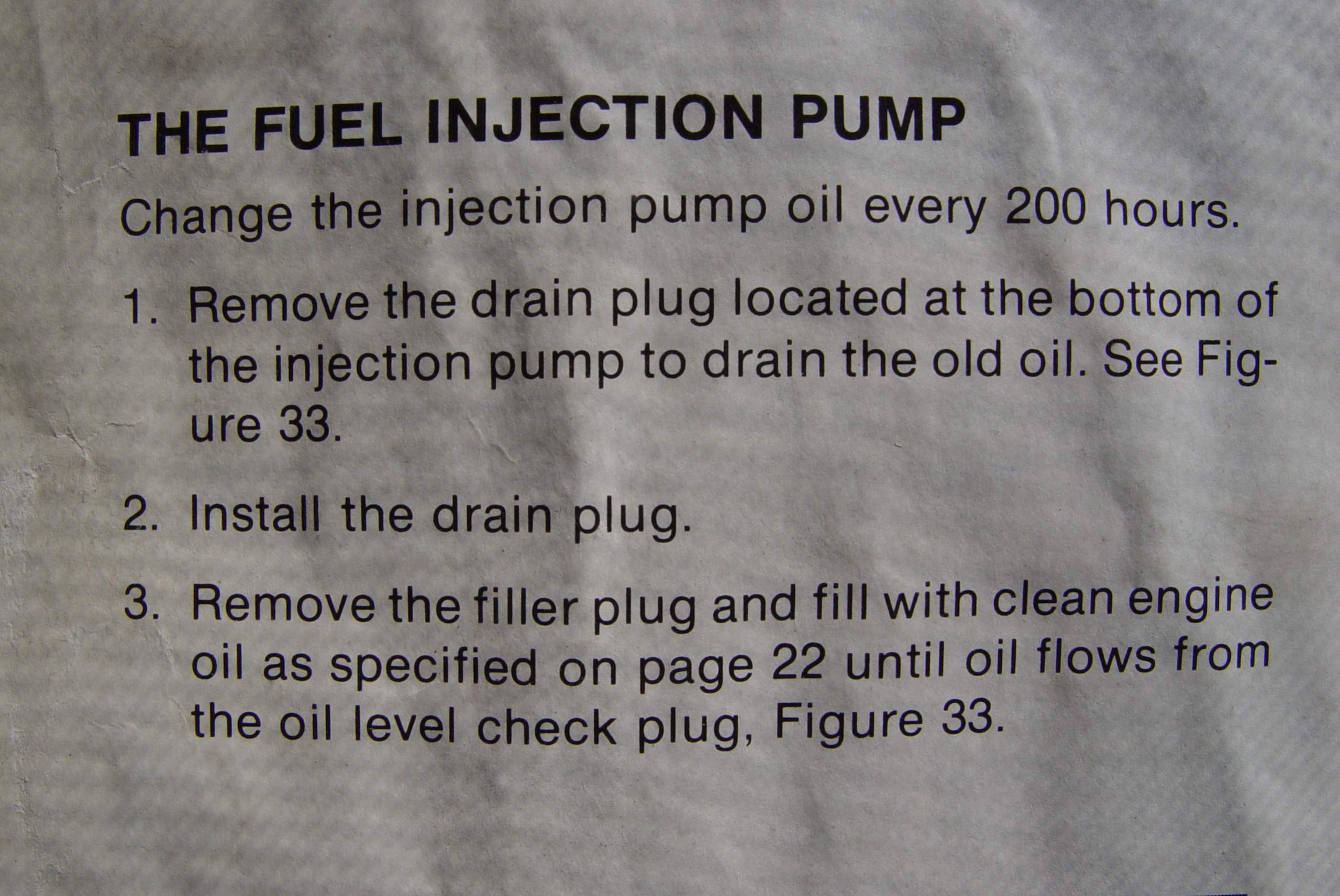

I took these 2 pictures that show where the fill, the level and the drain plugs are on a ford 1700. Second picture has the instructions on it. These photos are from the Ford 1700 owners manual.
/ Ford 1500/1700 injector pump #4
If you need more information let me know, I may be able to provide more pictures and info. When you drain the old oil loosen or remove the fill plug to let old oil drain out completely. As you can see the pump does not hold much oil volume. Use your mouse to click on the pictures above to enlarge them to good viewing size.

Fill with clean engine oil as stated above. My 1700 pump looks ecactly as the one pictured and uses clean engine oil. I would not attempt to drill any holes if there are none already there. See 2nd photo with instructions printed.
