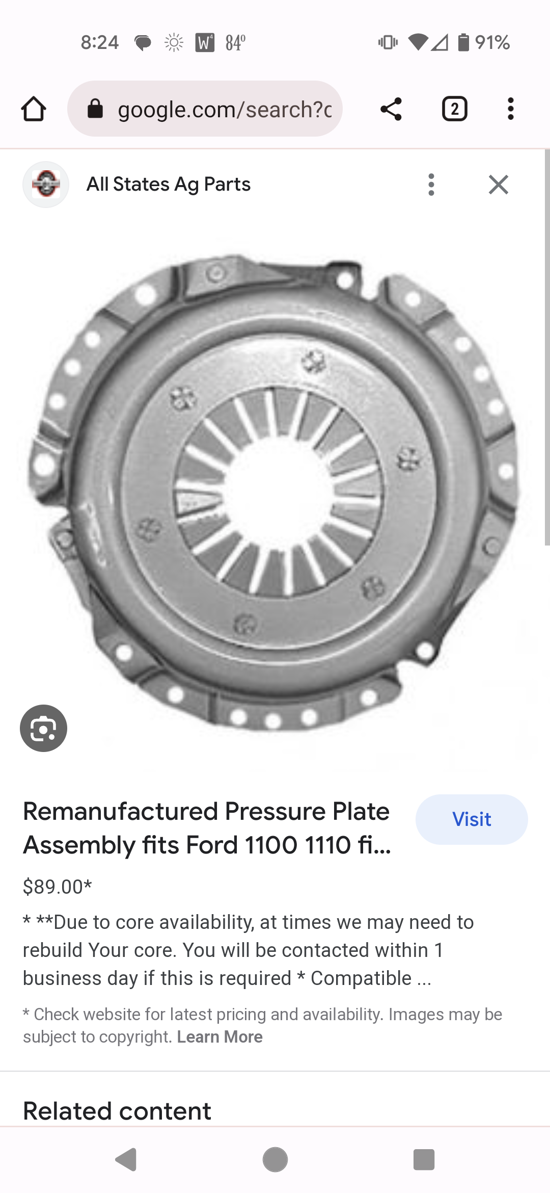

These seem to be made of unobtainium. Sent my core to rebuilder only to be told it wasn't serviceable. I spoke with about every tractor and clutch company in the US. I found a Nissan unit for a 6-1/4" disc that I bought on eBay. I have no idea if it will fit, but am out of options to use the original disc. Anyone else come across this issue? The tractor is sweet other than this! Thank you

I was able to purchase a new disc, it is the plate that has a damaged diaphragm.

This is what I need

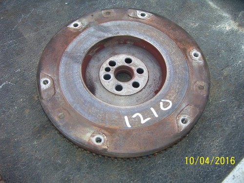

I‘m thinking you may have to change the flywheel to a 1200, 1210, 1220, TC21, but then you have an option. Just too many different sizes to manufacture.

Thanks, I have ordered the Nissan plate off eBay and am awaiting it's arrival. I will let you know if it's even close. I am hoping to avoid the removal and redrilling of the flywheel. I believe the larger clutch assembly would fit in the bell housing if I have to go there. That is plan "B" or "C"😩

Actually, the bell housing is the same on 11, 12, 13, 15, 17, 1900 tractors
