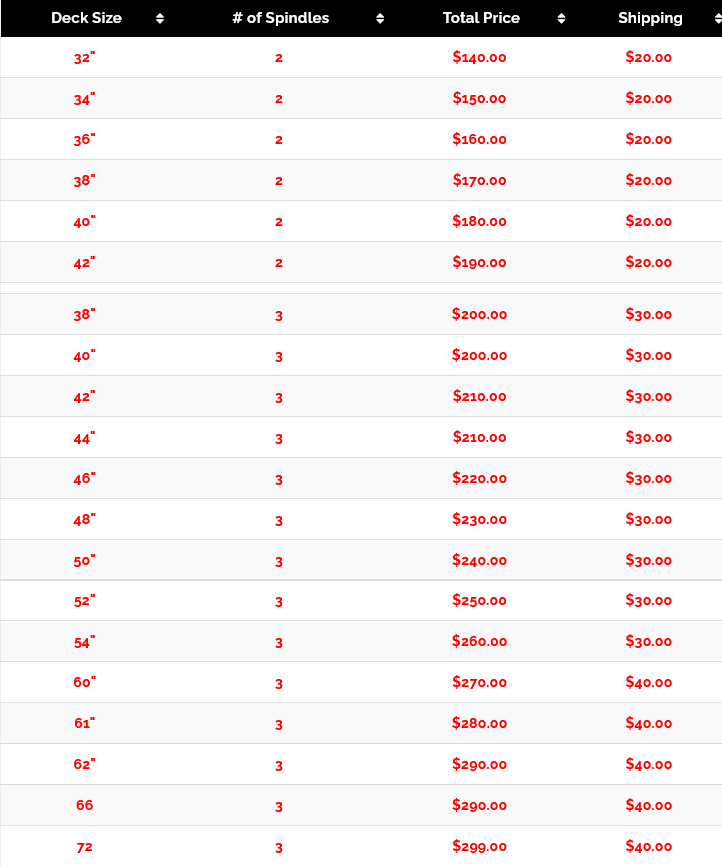

These do not list my brand of tractor and without some assurances that they will actually fit I can't spend nearly $300 for a set of blades that might not even work. They cannot be returned so if I ordered and they did not fit then I will have spent money on scrap metal.

I would buy a set....but I have to pay for them before they can be "made" for my tractor and they do not except returns. Cost is not really an issue, but I don't want to spend $310 and end up with nothing to show for it. I'm guessing that this is likely. If they don't make gator blades for my deck that has been around for at least 8 years then I'm guessing there's some reason for that and that makes me think twice about ordering something for a brand they don't even list in the options.
