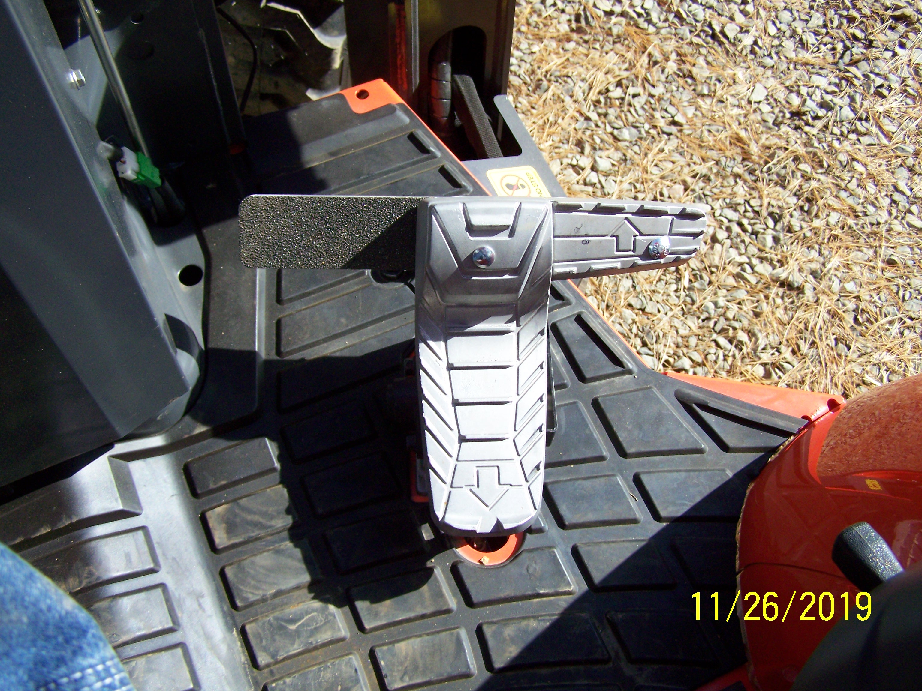

   / For those that hate the treadle pedal on Kubota #77
Because of arthritis in my hip I had a real issue with the treadle pedal. This was my solution. I use my toe for forward and reverse, much like a two pedal system.

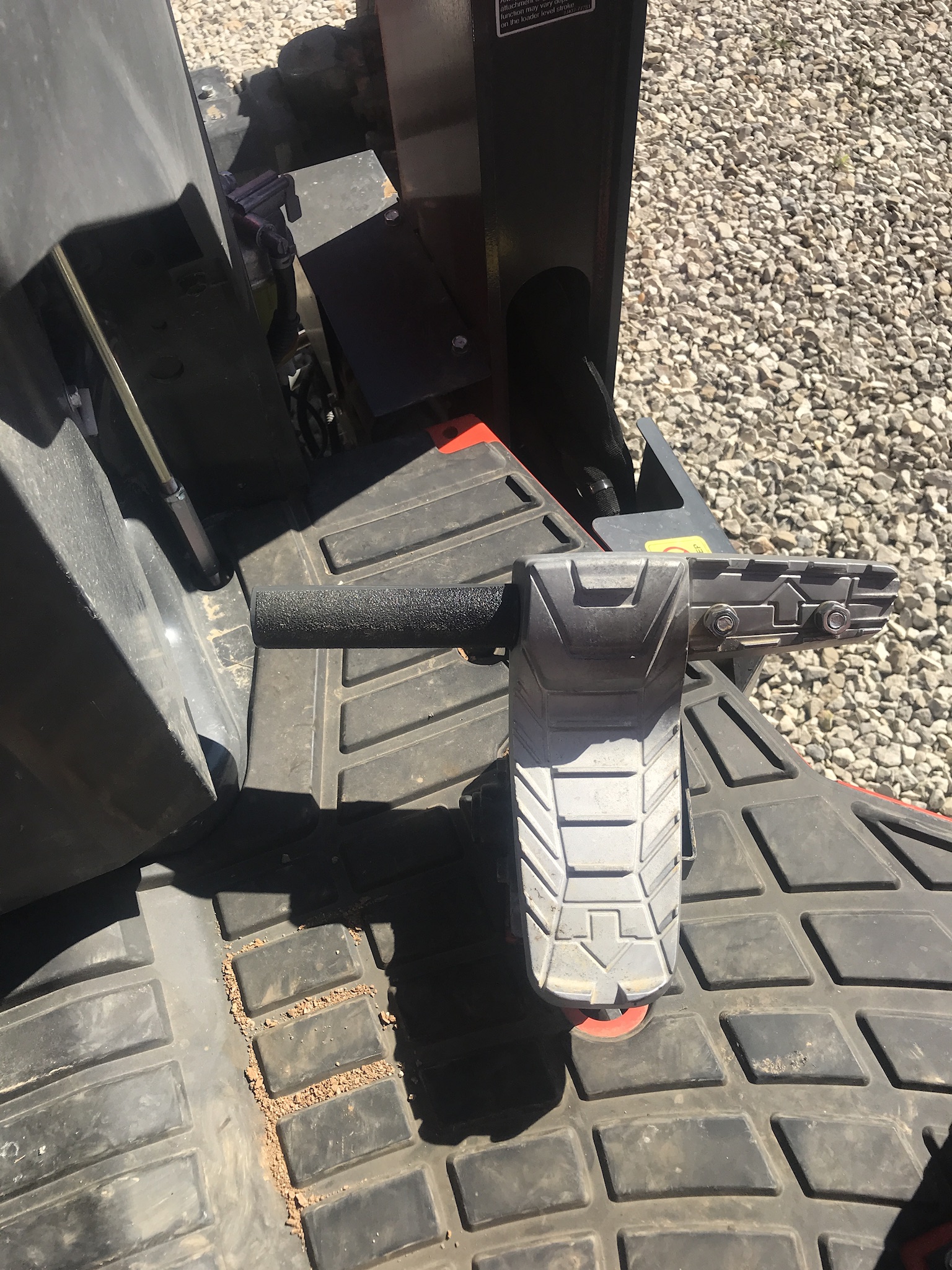

   / For those that hate the treadle pedal on Kubota #78
I can't understand how Kubota thought it was a good idea to put the wing on the right side. most unnatural position for a human leg.
