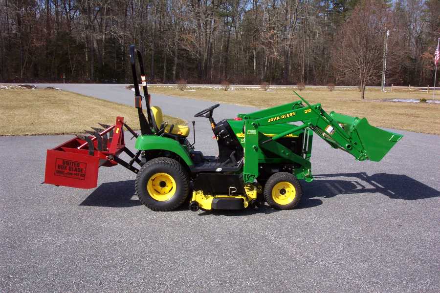

The only other unsolicited advice I will give your is to save you money on the I-Match quick hitch and ballast box and get a quality 48" box scraper instead. My United/Leinbach weighs 325 pound and I can use suitcase weight to get it to 650 pounds for ballast, which is plenty for anything you will be doing with the 210 loader. Here's a quick pic of the rig from deliver day in February.
