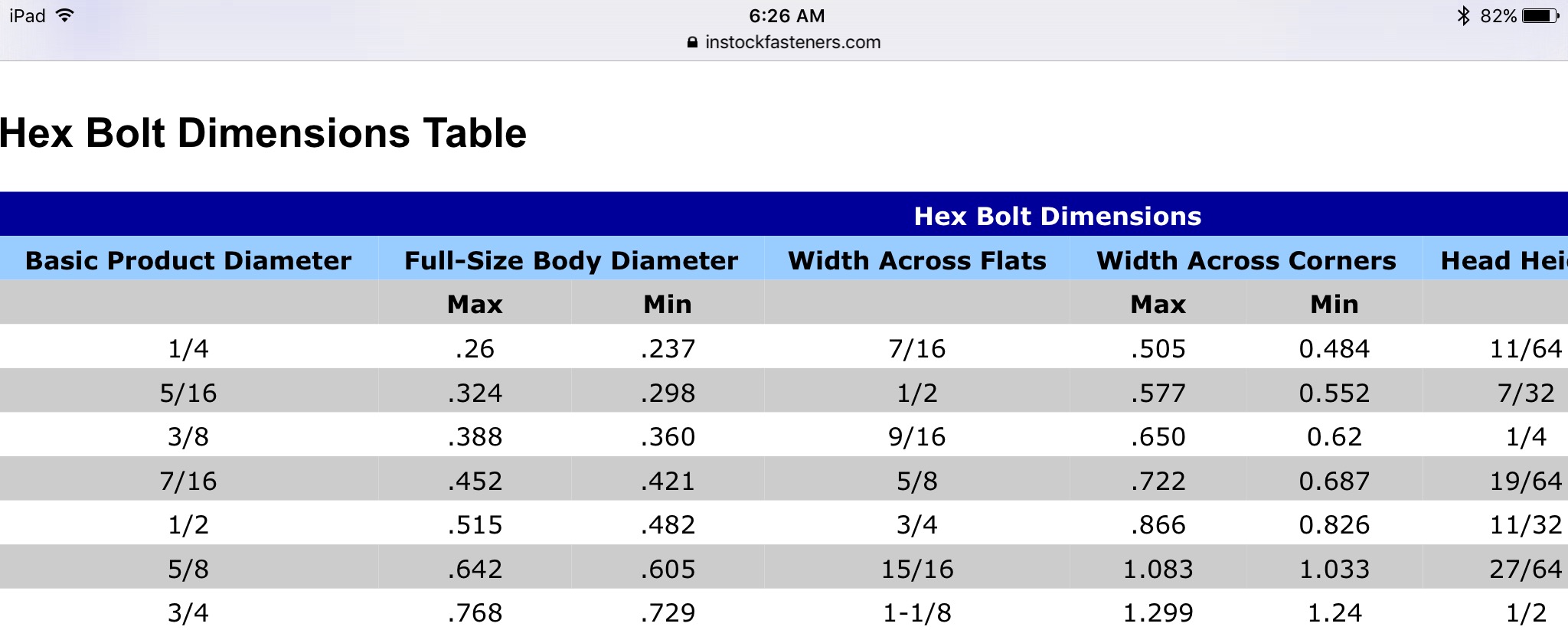

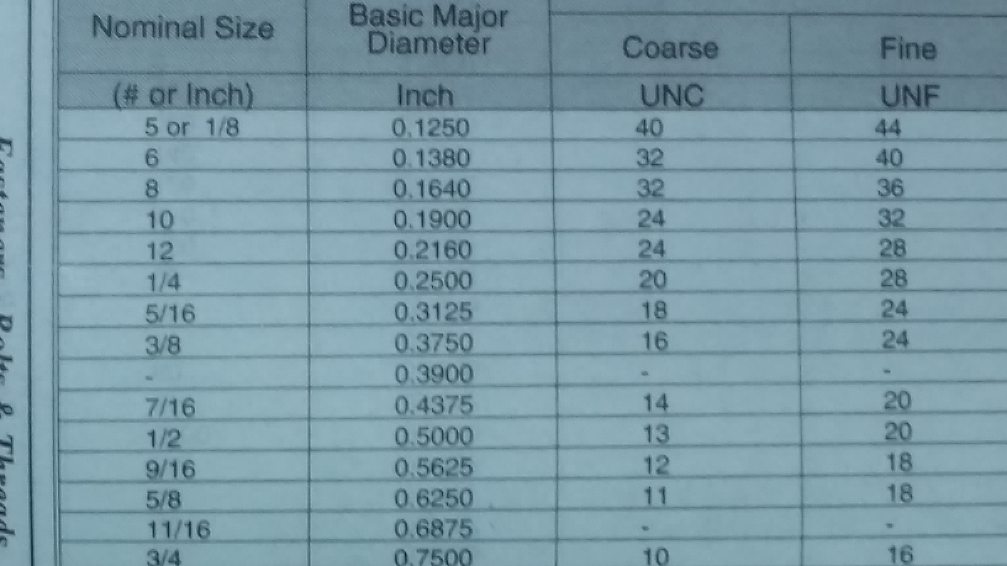

My technical qualifications as a machinist are nonexistent. My father taught me to read a micrometer too many years ago to remember and he was a journeyman machinist. I give that up and in my post above I mentioned I am up to being corrected on my information but here are my references pictured below. I am in the ballpark as they say for the dimensions for a 7/16 bolt. Pitch size and angle degree I don't have that information and I can only say that a US made SAE tap settles into the threads like it was cut for it. I also have a metric thread pitch gauge and the 1.25 gauge was close on my bolt but the SAE 20 settled into the threads perfectly. At least to my old 63 year old eyes and fingers. If I could find the 7/16-20 tapered lug bolts I would put them into my tractor torque them to specs and not give it another thought. But I can not find that these bolts exist. Now, if that metric bolt is that close too and it was threaded to the shoulder I would used it if it threaded in there nicely and torqued up.
The simple fact is none of us like the wrong part for the application and a regular bolt and lock washer against a tapered wheel hole on a rim is the wrong part for that application. We will agree on that and it's that fact that has us all scratching our heads why LS did this. I may offer up that the wheels are stardard off the shelf items. Their engineers, when designing these axles did the calculations and a bolt in "the size range" of a SAE 7/16 fine threaded bolt had the clamping force range to do the job. Then it was discovered that there is no off the shelf bolt in that size range with a tapered shoulder with threads cut to that shoulder. So a standard bold was used as the clamping force is what is truly doing the job. Again I am no expert and again I am easily corrected, but these are just my observations after being in this kind of business all my life as a mechanic. Now I'm an retired old lady. But I love my tractor and I love these discussions and thank you gentlemen for entertaining my thoughts here.

These diameters listed are prior to cutting threads. Is the standard max/mins before cutting. The outer diameter of the threads will be smaller after they are cut. I may cut one on my lathe if I get time. I worked in the shop all day. Dang knee is killing me. Concrete!
