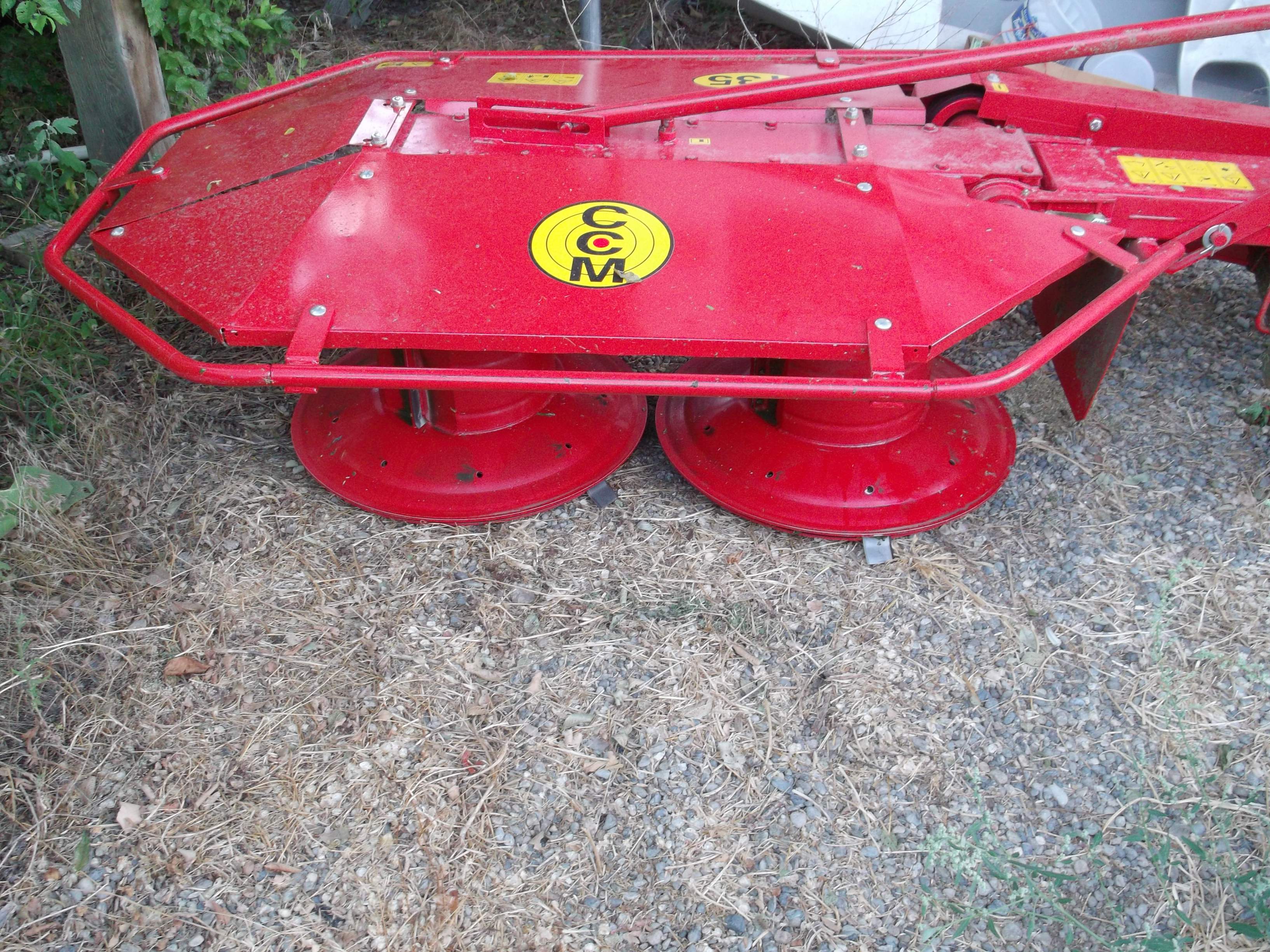

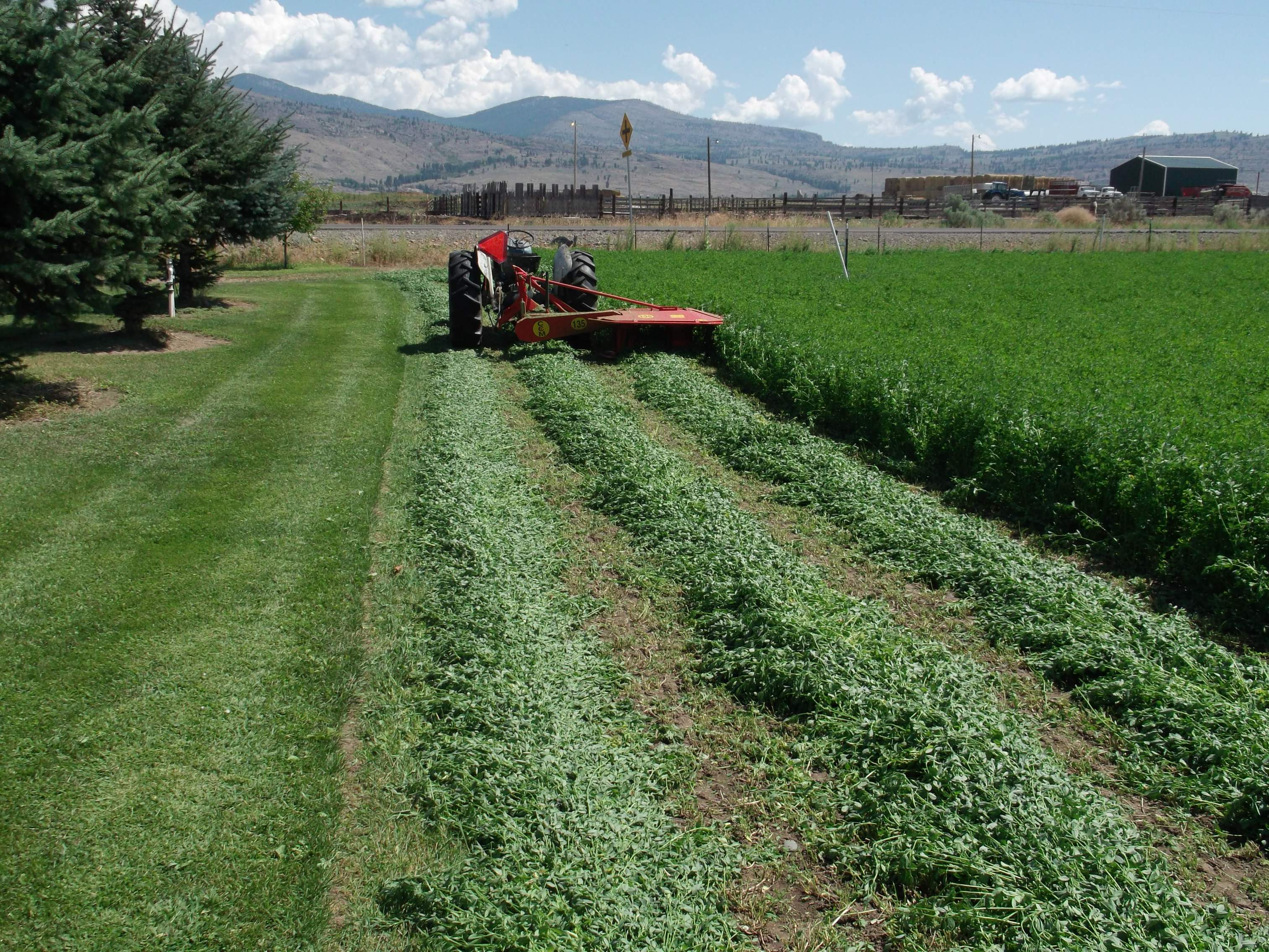

I have gone to a drum mower to mow my alfalfa... The swath is about 50" wide and very thinly piled, which makes for very fast drying... Then I roll it with a wheel rake, which is gentle enough to keep the leaves from being knocked off.... The field has had 30 days of growth....
