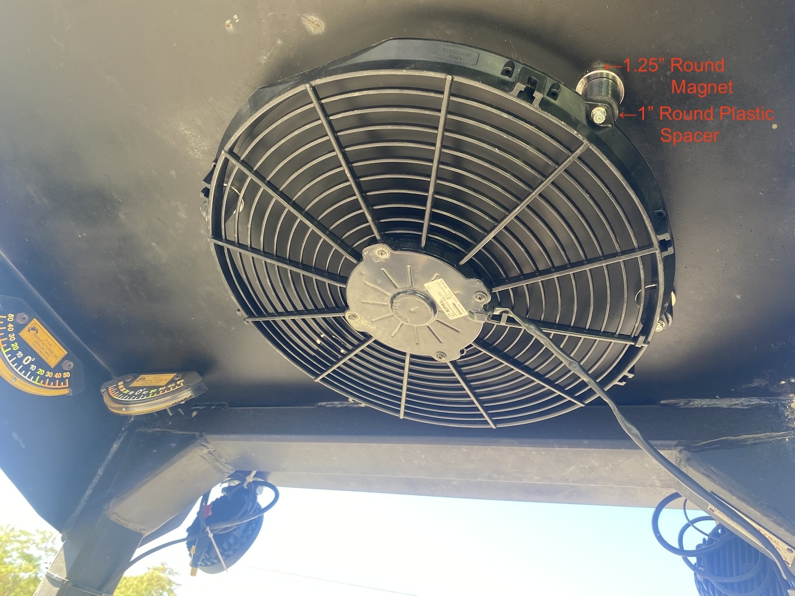

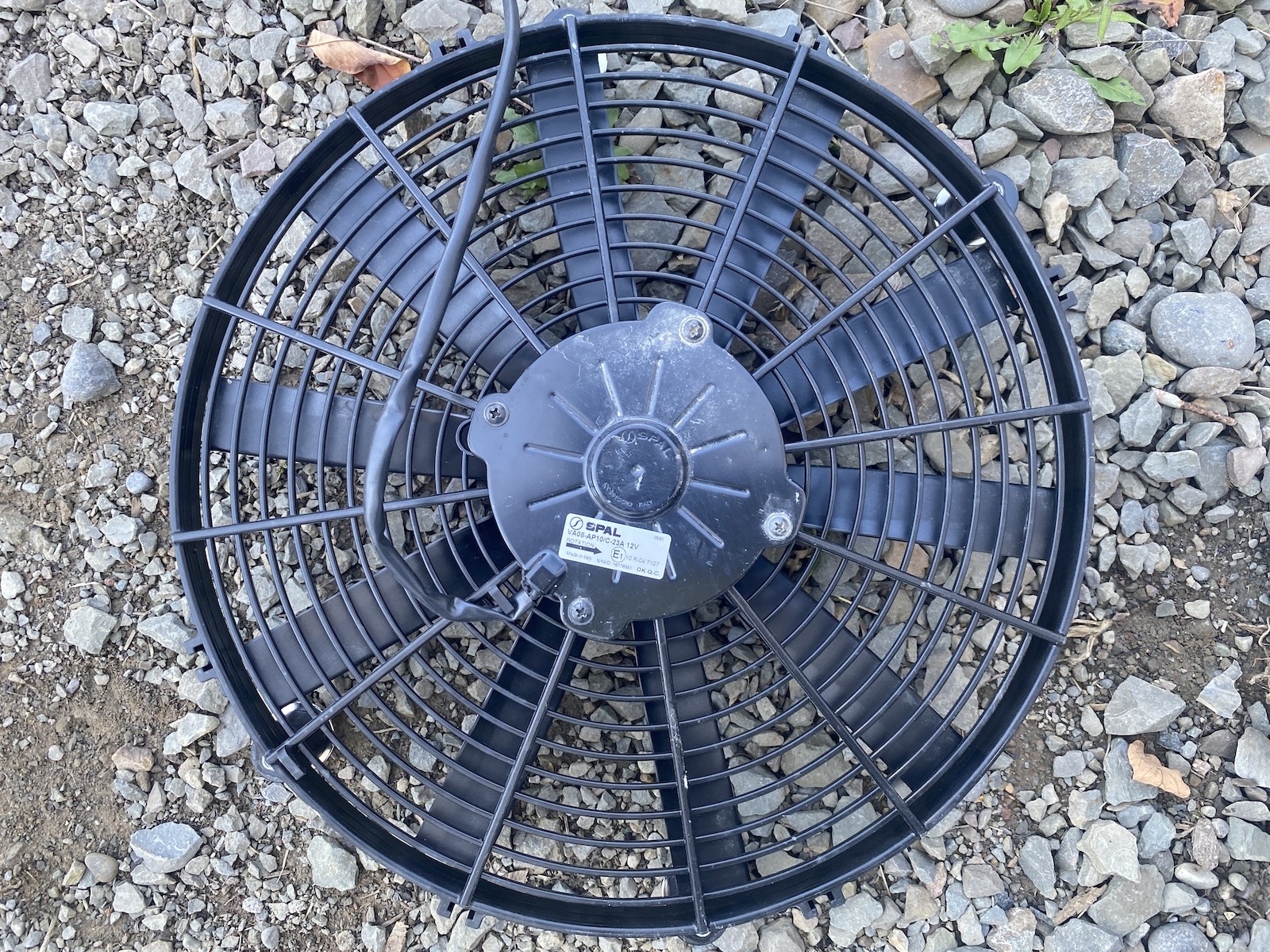

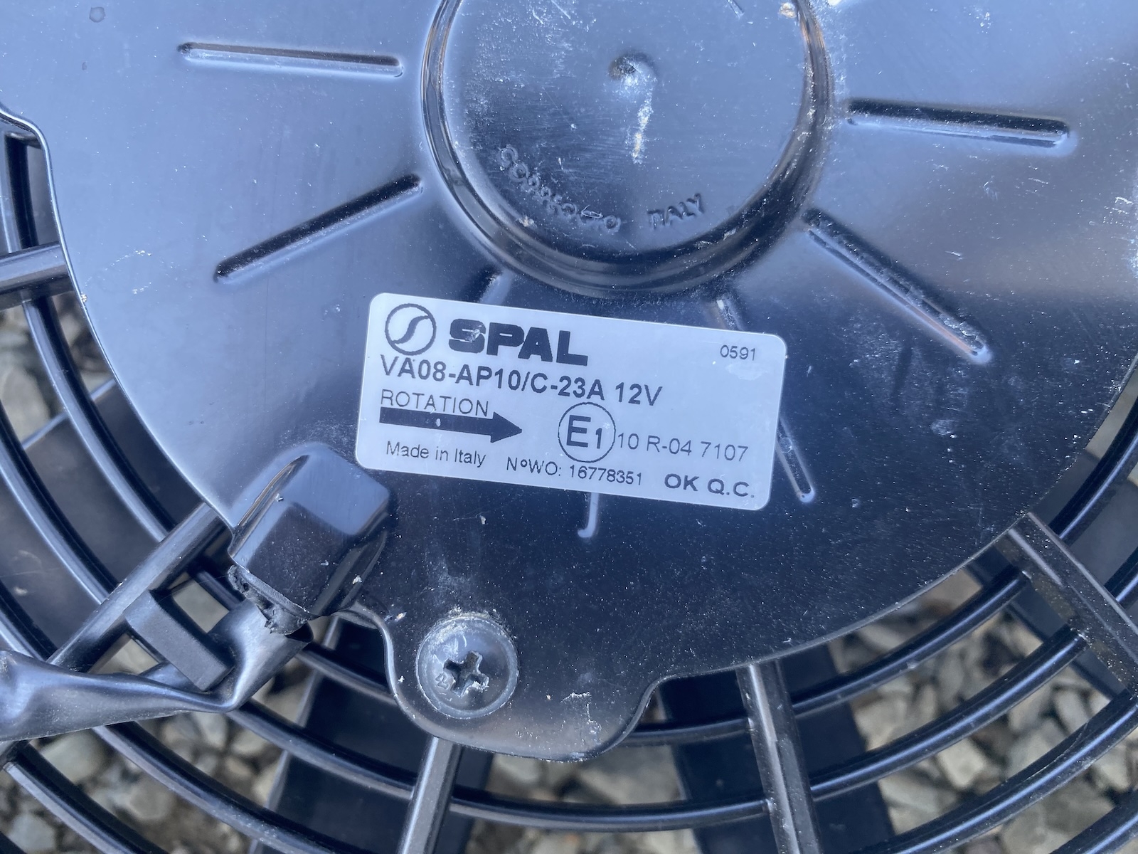

The previous owner of my PT1850 ground off the oil cooler fan mounts so that he could use cheap fans made in China. These fans do not last long and I got tired of replacing them. I 3D printed some adapter brackets so I could use his mounting studs to mount the SPAL fan. A Deutsch style connector was used to wire the fan. I got a good deal on a two pack of SPAL fans so I decided to use the spare fan to cool the operator when desired. Under the FOPS seemed like the best location, so I printed some 1" spacers to allow airflow around the fan. The fan is mounted using magnets. Originally, I tried 1" magnets. They held until a major jarring occurred like going very fast over a large bump or dropping the tractor when it is lifted up by the mini hoe. So I replaced those magnets with 1.25" (1.26) magnets. These make it difficult to remove the fan but it can be done.

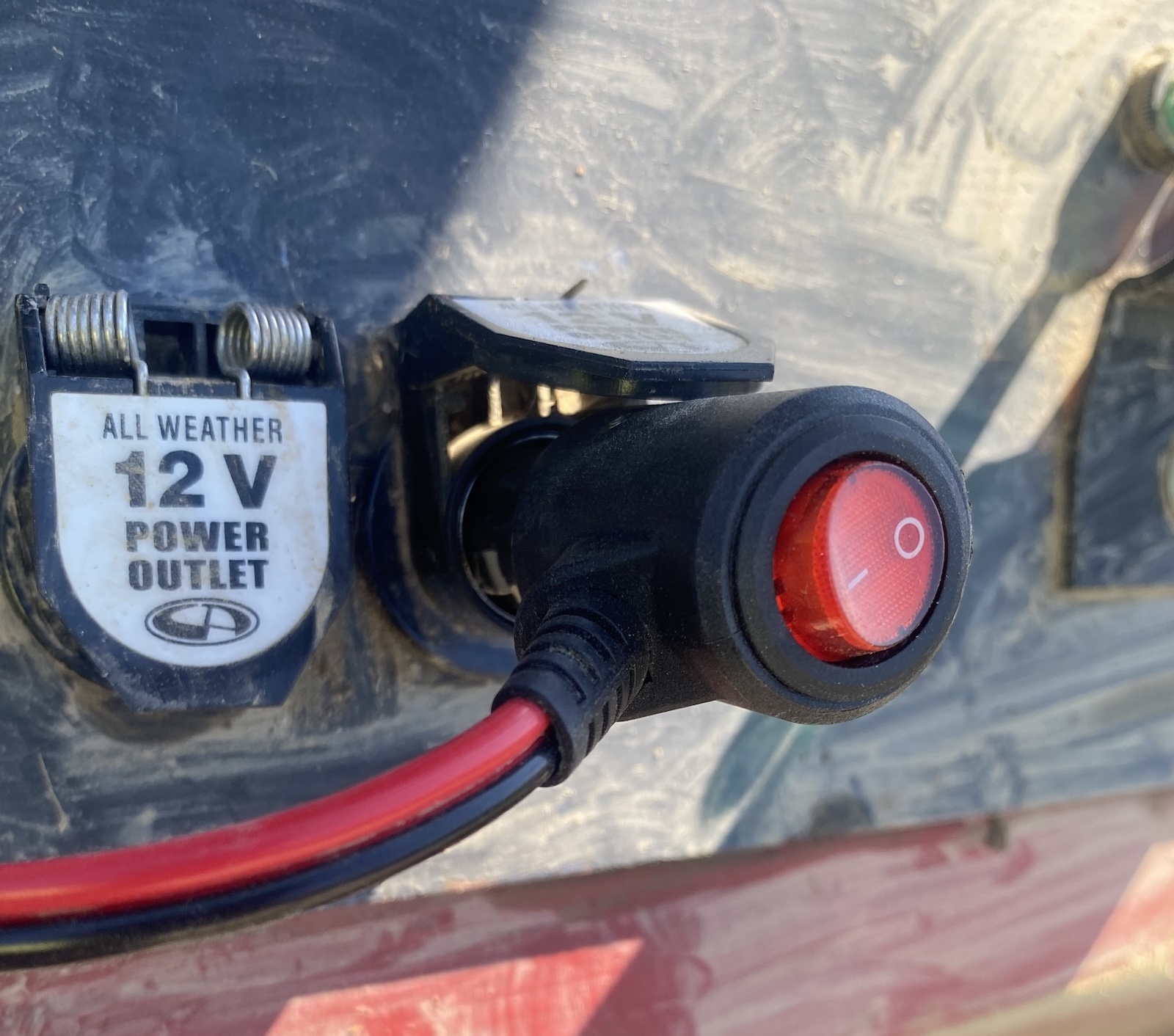

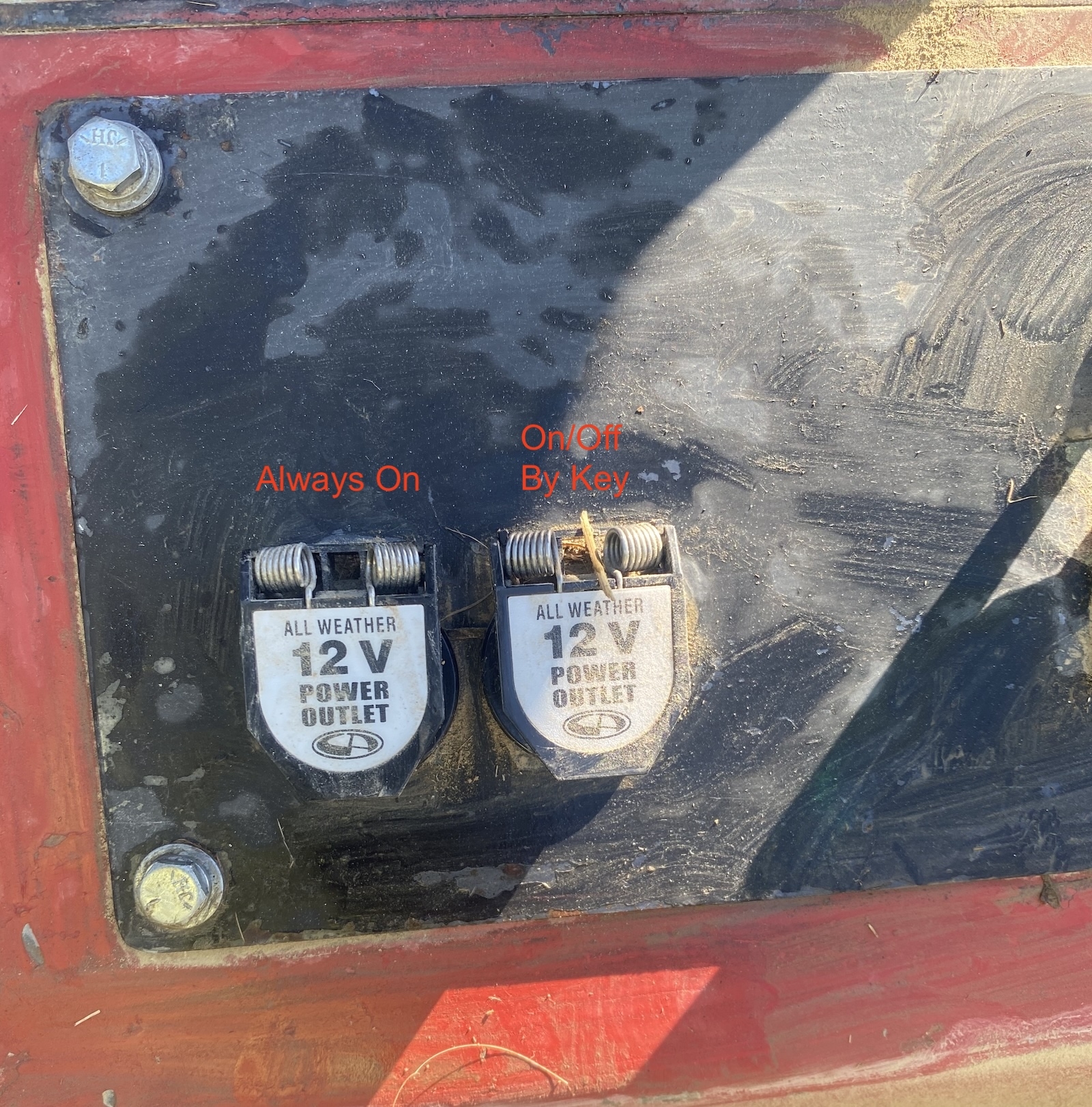

For power, I installed two 12V sockets that are supposedly weather rated. One is always on and the other is controlled by the ignition switch. (Previously, I had added a relay that is controlled by the ignition switch in order to run various accessories.) The plug on the fan has an on/off switch integral to the plug. The fan is p.retty powerful and could become uncomfortable after a while if not wearing a hat. The magnets allow one to move the fan to the best location for the current activity. If doing a lot of driving, forward of the operator might be desired. I have been happy with this setup.
