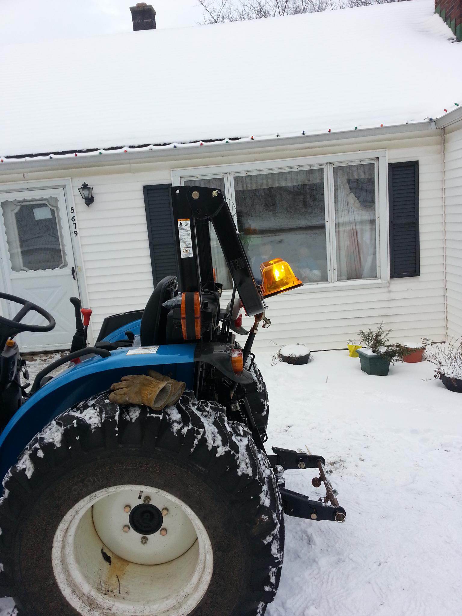

Kenny, it uses pins to hold it up/down, but the pivot bolts are what the manual refers to. They use nylocks on them, so its not like they will vibrate loose. Then there is the 1/4-20ish bolt with a lock nut that appears to help eliminate vibration too??
Not sure if its visible in this picture....

Bah, it doesnt show the 'inside' where the smaller bolt is.
/ Folding ROPS question #5
Sounds like you just need to adjust the large bolt to where it is tight but not so tight that you cant move the ROPS up and down. Then when it is pinned in place if it doesn't rattle then I wouldn't mess with tightening the small anti-rattle bolt especially if putting it up and down.

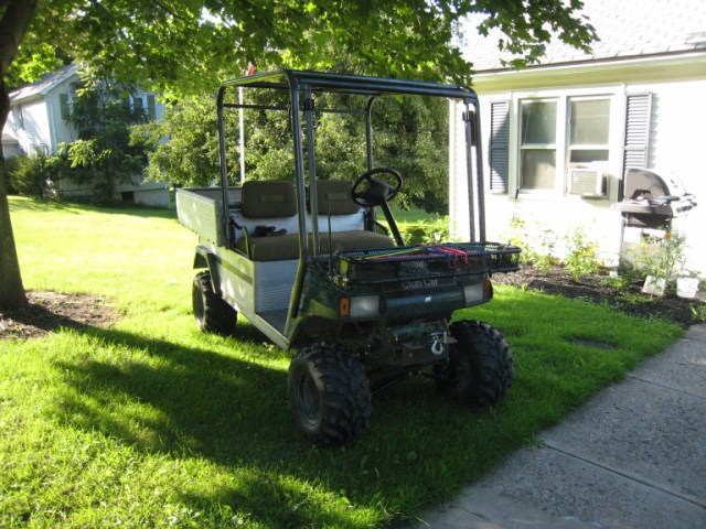

Gary, not positive, but I think my uncle can get his RTV in his garage which I am pretty sure is a 7' door. When I built the 'roll' bar for my golf cart, I made sure to keep it short enough to fit under an 80" man door. The shed I keep it in, has a 6' wide 80" tall french door for its opening.

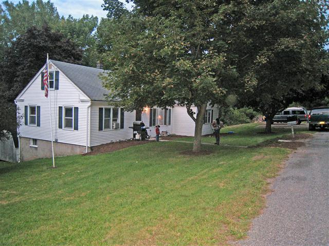

Funny... thats the tree that I am hitting with the ROPS!!
This one shows the view over to the driveway (where the suburban is parked). I push from the driveway to just this side of the sidewalk, and then clear the steps and sidewalk as well with the loader.

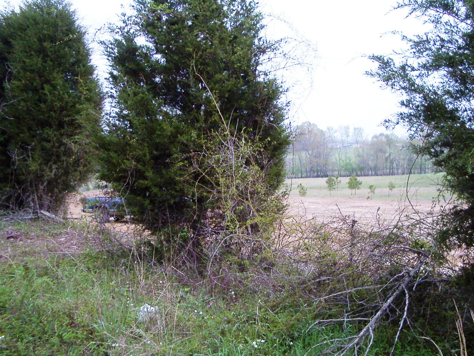

This is about the only photo I can find of the way it was and after clearing out the trash from front road to access the house site
