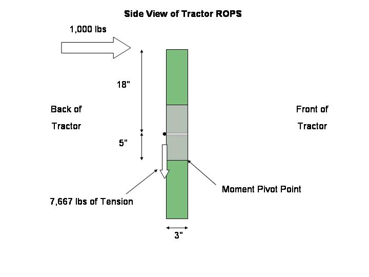

Comparing the sketch and your build. I am no structural engineer so only take this with a grain of salt but, the hinge point on the sketch is a through bolt that goes through the sleeve and ROP's which adds additional strength and rigidity to the entire mechanism. Two points that holds the assembly together versus one point (Pin) per your build (your hinge does not count as you stated earlier). I would really consider matching that design as I feel it is superior to you build. When it comes to safety like this you don't want to skimp. Not criticizing your work here as it looks good but, I would definitely follow the engineered solution on this. I like the JD sketch design more than the factory set up on my MF.
/ Folding ropes.. #19
Picture it this way, hings will be facing to the back of the tractor. So if I flip the tractor to the right or left its going to be on steel.. If i flip it over backwards it will be on steel. If i some how manage to flip my tractor over the front wheels then the pin will take the brunt, but i am pretty sure if I manage to flip it over the front wheels then I just drove off a cliff.. :)
While pretty is nice, functional is what i am going for. Those are some expensive barn hings, set me back 2.79 each.
I won't go down the safety road or endorse what you're doing, but I wanted to clarify what you meant by "on steel." I interpreted it that you figured your bracket tubing against the ROPS tubing would take the brunt of it (not the hinge). That would be mostly accurate for a side rollover although you would still experience some tension on one hinge and compression on the other. However, I think you're grossly underestimating the amount of tension that would be placed on your hinge if flipping over backwards. Let's say for arguements sake that if rolling over backwards the ground hit the top of the roll bar with a force 1,000 pounds (probably conservative). If your hinge is about 18" down from the top of the ROPS and your ROPS is 2"x3" (guessing from the picture), you'll have a tension force of about 7,667 pounds on that $2.79 hinge - 1,000 x 23 / 3. Feel free to swap your dimension and force values, but you may want to find the specification ratings on those hinges if functional is what your really after... especially when functional means life saving in this case (ok so I did go down the safety road after all):rolleyes:
