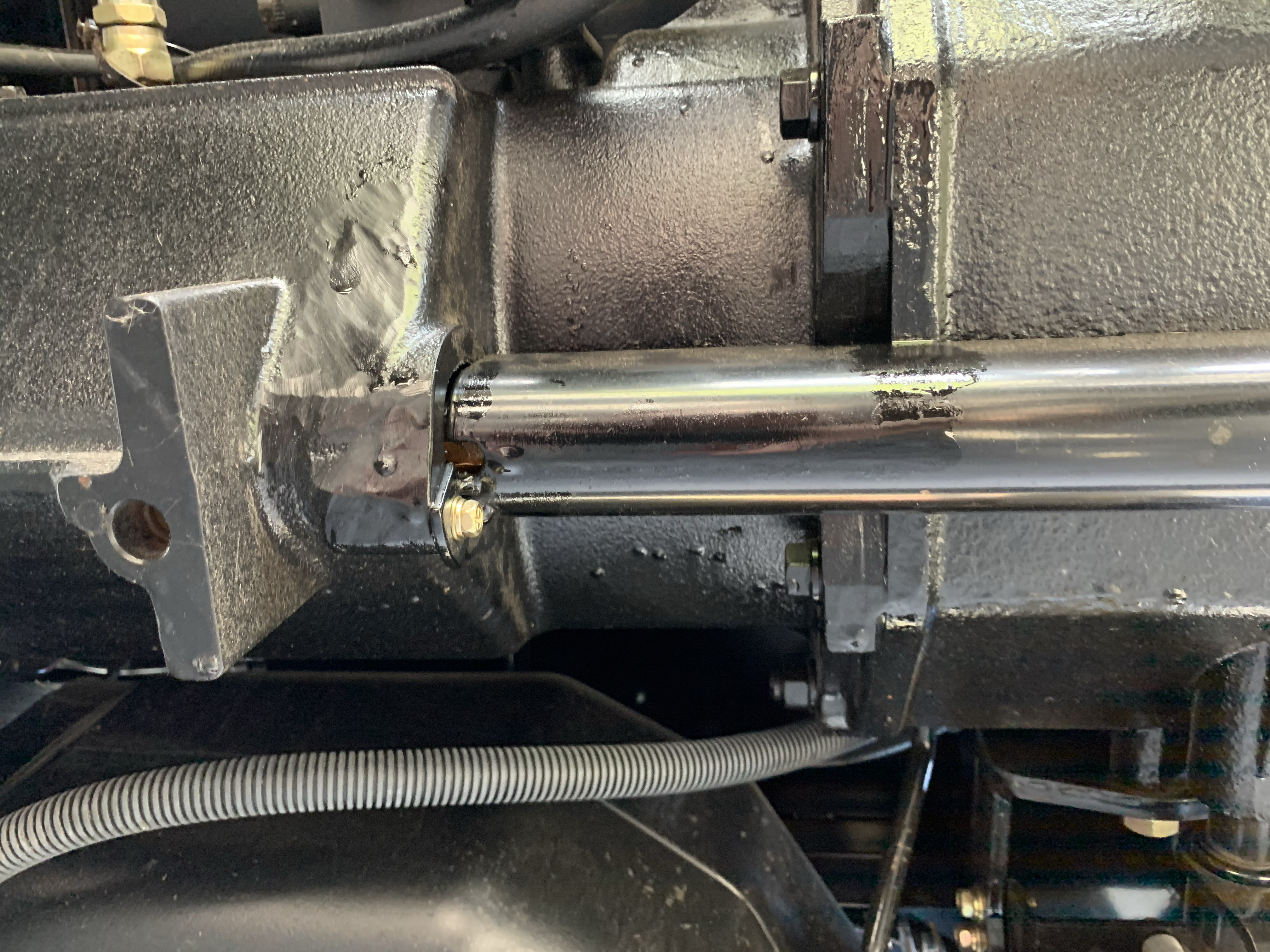

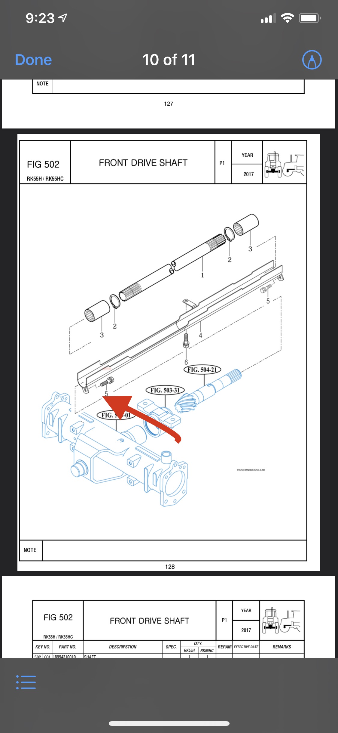

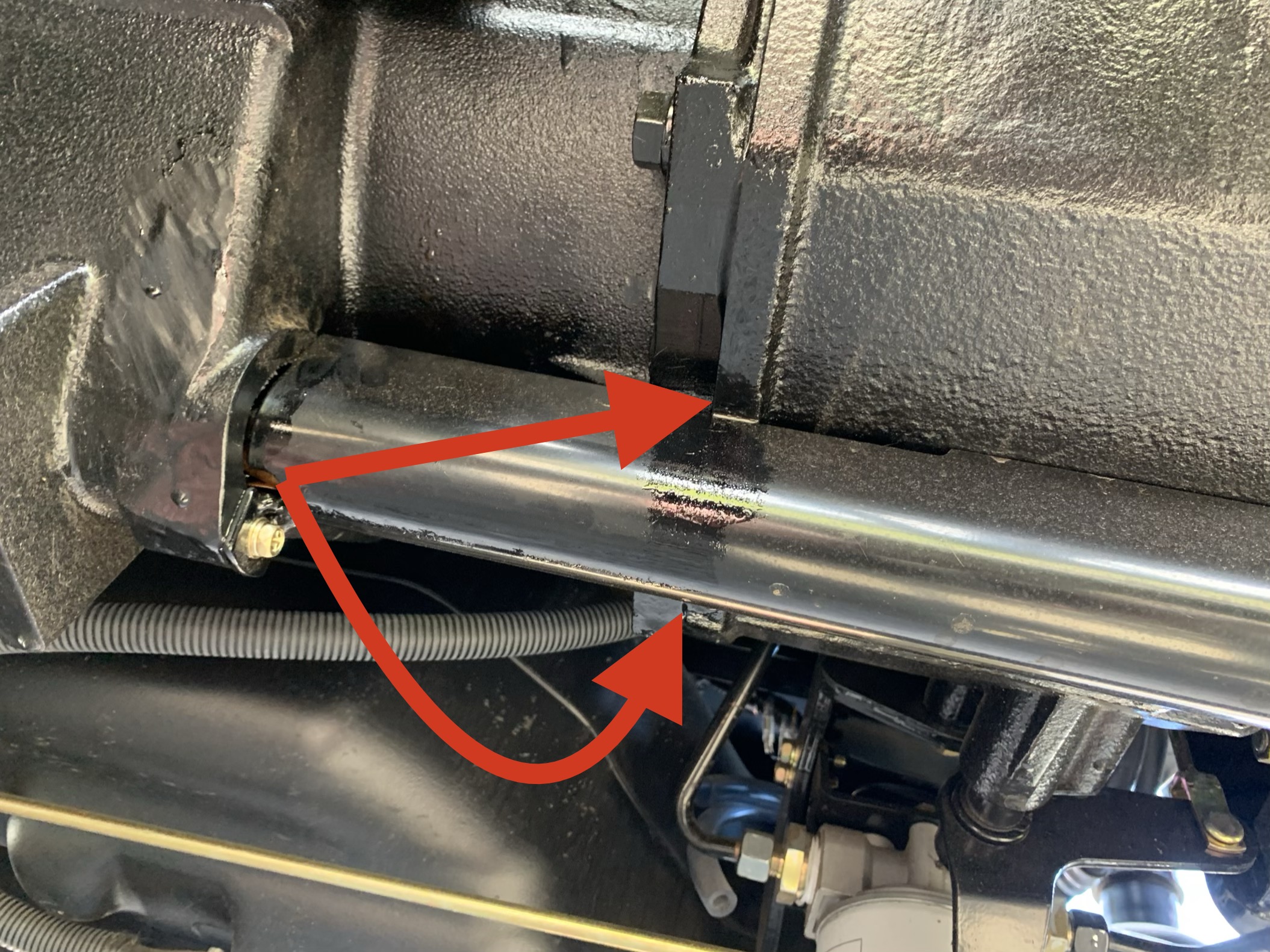

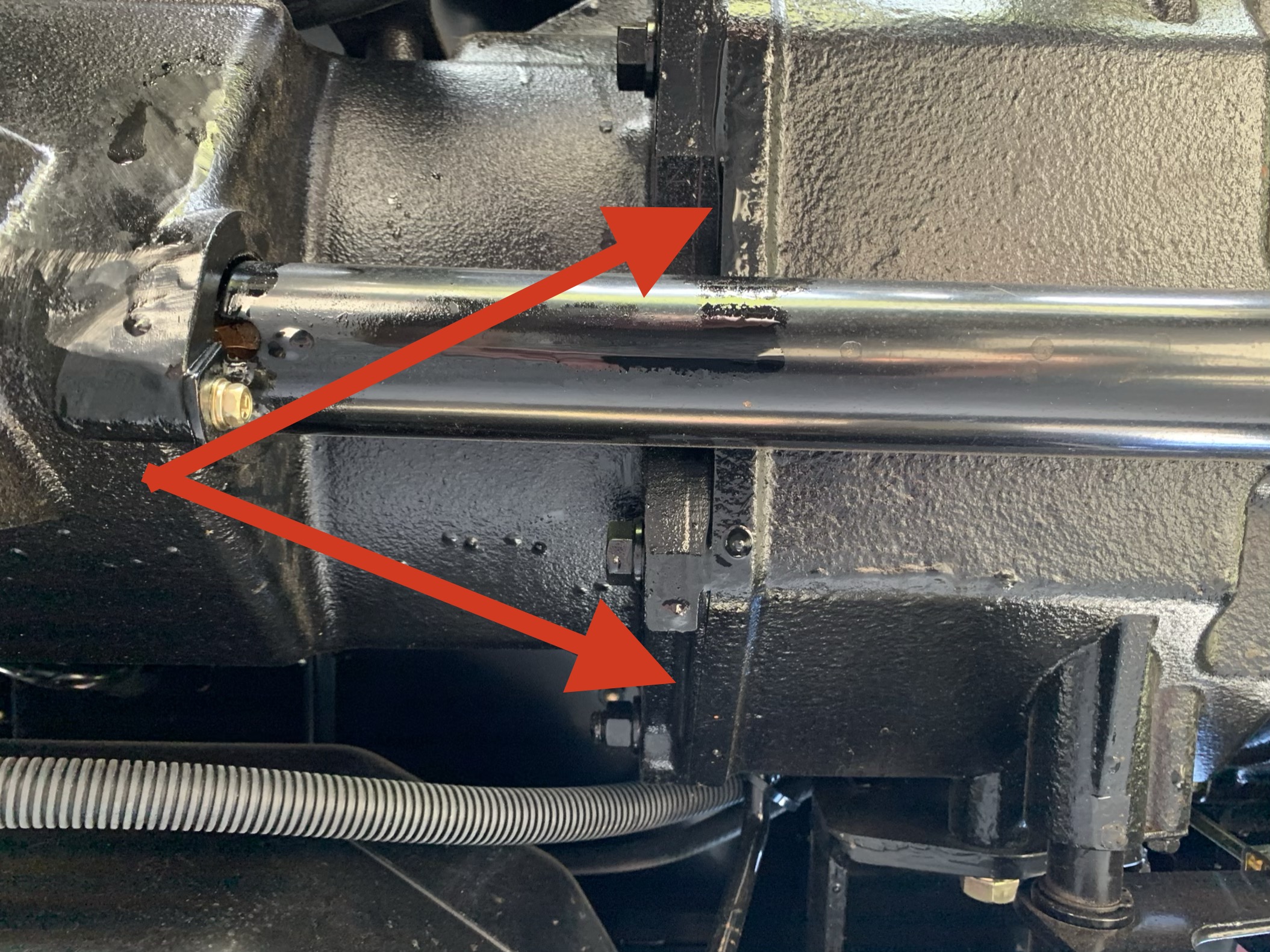

So I just got home from church and pulled it out and looked and it looks like it’s coming from the big case that the driveshaft is going into. Here’s some pictures. It’s still wet but doesn’t seem to be actively leaking. It’s clear fluid like hydraulic fluid.

It’s toward the front of the tractor and I checked and I didn’t see fluid dripping down from anywhere. It’s seems to be coming out from the seam at that case.
/ Fluid leak RK55HC #10
Clean it off completely then run it again. You want to be sure it isnt leaking down from another spot. However it looks like a warranty repair so I would go ahead and put a call into RK. Now you get to test their service!

Looks like it's leaking from where the both transmission cases bolt together.
Either way, time to call the dealer.
