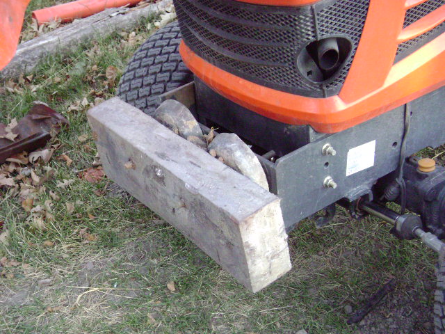

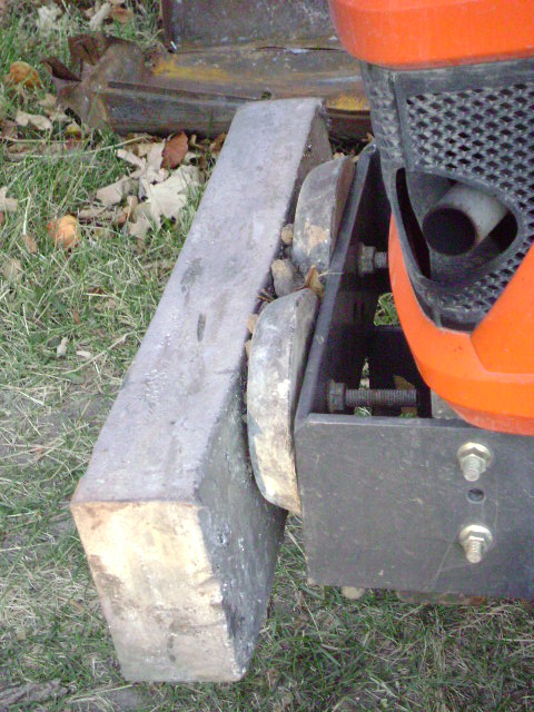

I have already posted on another thread what I have done as far as rear wheel weights go but for the front end what I did was scrounge a bunch of old car ,truck and tractor batteries from neighboring farmers melted them down and poured the lead into an old tool box with a couple of pieces of 1/2" all thread cast in place. Then I pealed of the tool box and mounted the weight on the front end. The tool box mold warped a bit and it wasn't quite level so the weight came out sorta ugly but it's heavy, compact and it works really well but most importantly it was CHEAP as in Free. The difference it makes for loader work is truly amazing.
This Free block of lead weighs in at 225 pounds so is 50 pounds under max for a Bx2350 but I have a five gallon bucket of used wheel balancing weights to pick up at the local tire shop so one of these days I'll just melt the whole bunch down and re-pour it into a proper mold.
