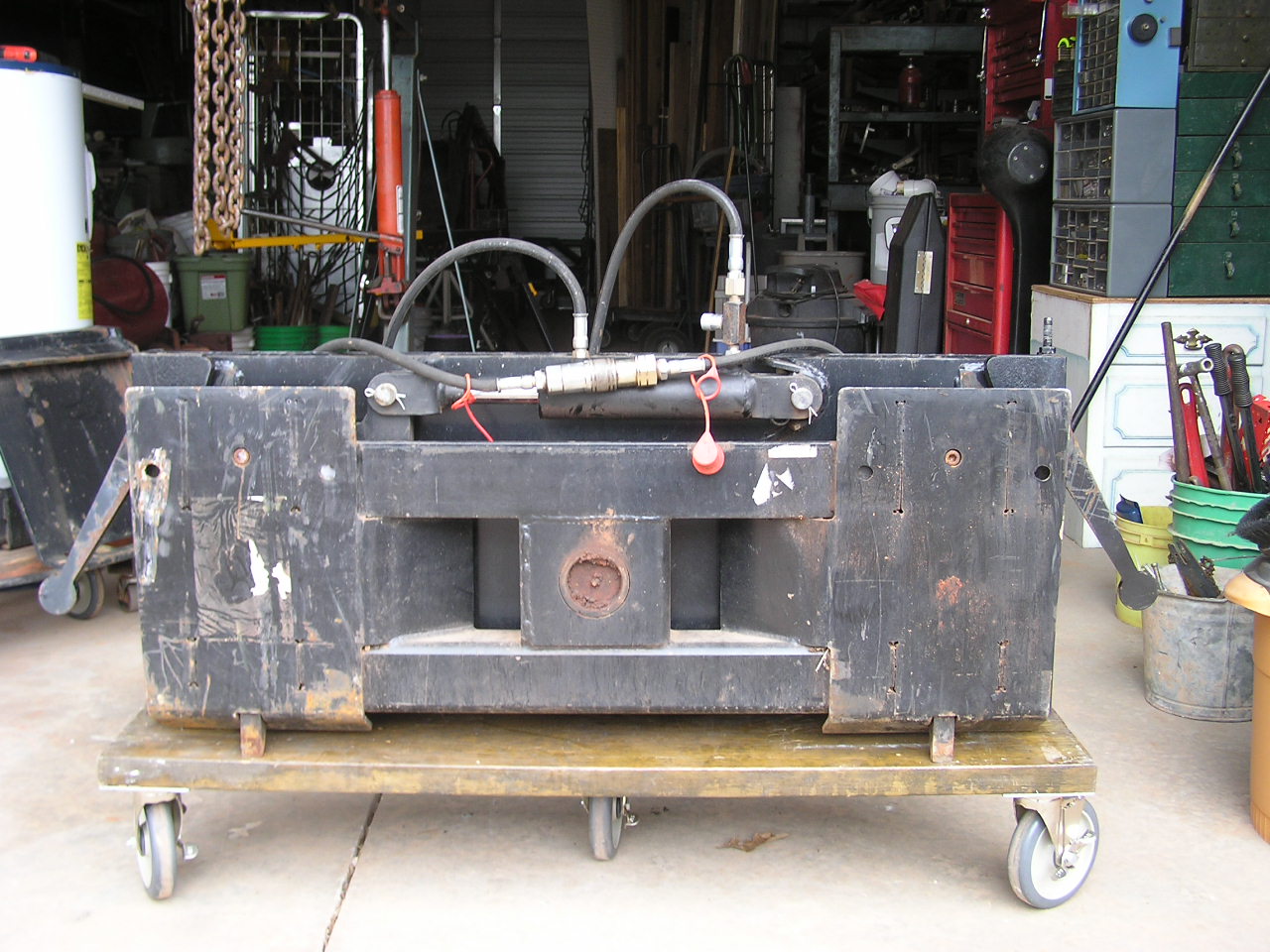

Decided to put a cylinder on my drum mower to lift the tip. Had a 2" diameter cylinder on a Ford 3910, ⅜" hoses. Thought about a fixed restrictor fitting but couldn't find much and what I did find was really pricy. I decided on a variable 2 way needle valve from All States Ag. Parts for like $27, had it in a couple of days. Just now forget the total turns, at least 3 full turns lock to lock, but wound up with it set 90* open (quarter turn) from fully closed. Really glad I didn't go for a fixed one as whatever I would have ordered would have been way too big.
   / Flow restrictors #3
I added an adjustable flow control to my Tilt-Tach. It moved too quick and too far without it.
That is it on the hose on the right side of the cylinder in the picture:
