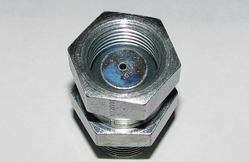

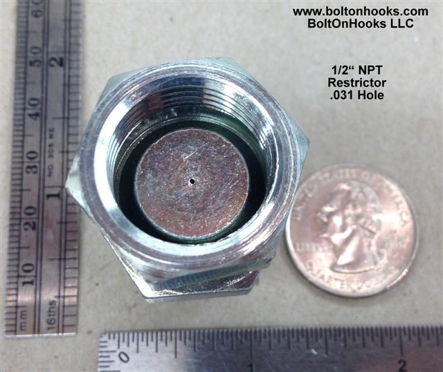

If the tie arm is controlled by a hydraulic cylinder, you can restrict the flow at the cylinder.
I had a backhoe that had a small hole washer dropped in under the hose at the valve, but you could put it at the cylinder.
http://www.tractorbynet.com/forums/hydraulics/183356-slowing-down-hydraulics.html
