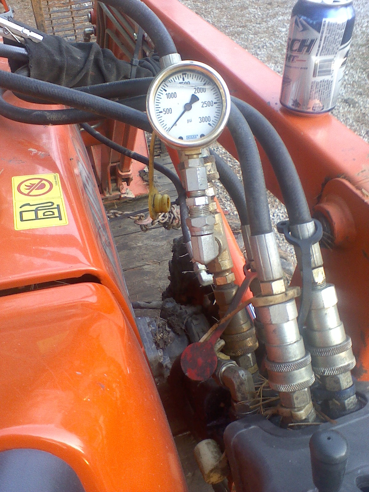

I would install the gage in a tee in the IN port of the valve that is controlling the sickle bar mower.

OK, a 'T' at the inlet to the motor of the sickle.
   / Flow control or not, for sickle bar: Samuri/Sabre #56
Actually, if you have a loader, I would put the gage in a tee in the IN port of the FEL and mount it so you can see it at all times.
That way, you can use the gage to monitor every hyd action and troubleshoot the hyd system.
