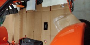

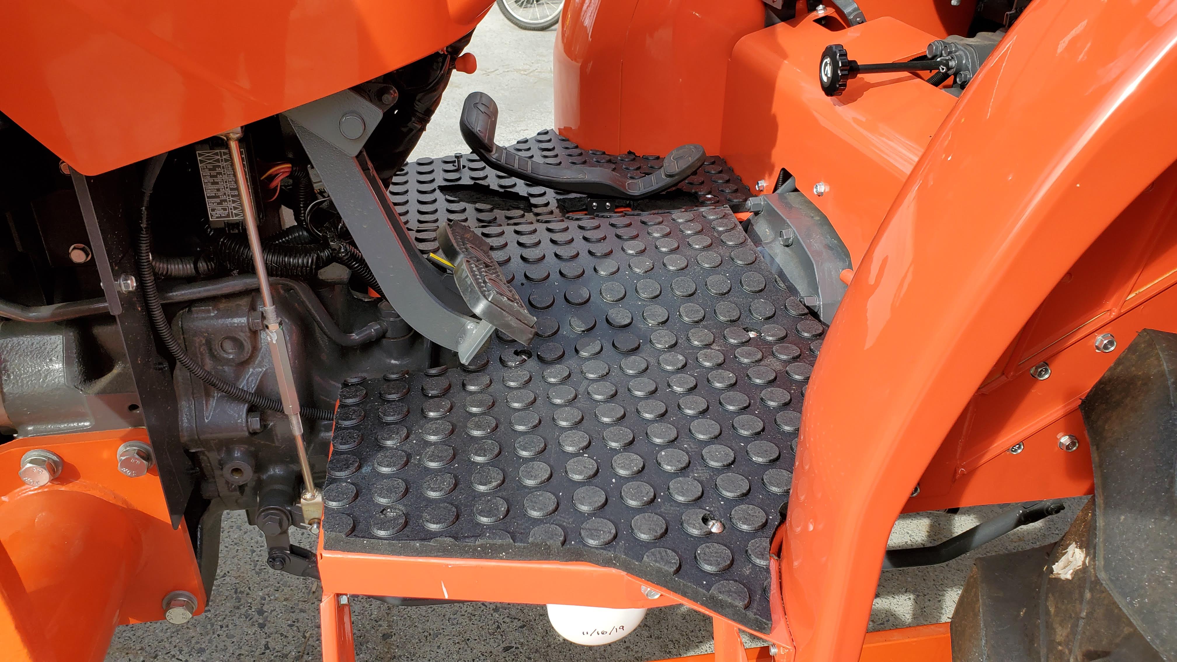

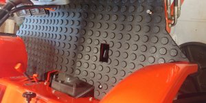

Got tired of the slipperiness of the bare steel floor on my MX5200, so decided to make a floor mat from it. I got a 3'x4' by 3/4" mat from Tractor Supply, and used a cardboard template and then an oscillating tool and router with spiral upcut bit to fit it. Here are the results:

Did the router or the multitool cut better?
   / Floor mat for Kubota MX5200
The multitool definitely cut faster and cleaner, the router was necessary for the non-through cuts like the recess under the pedal for clearance. No burning or smoke with the router, but made a pretty good mess of black shavings.

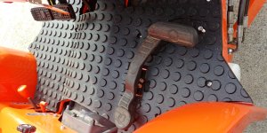

   / Floor mat for Kubota MX5200 #5
Did the mat make any difference with HST pedal travel ?
Because it was so thick, it did limit HST pedal travel until I cut out a recess under the pedal to allow it to tilt fully forward/backward.
