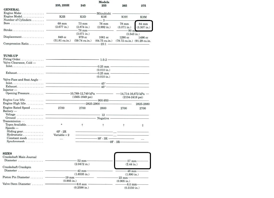

I just returned from the machine shop and they need more accurate machining clearances for the crankshaft and cylinder bore.
The service manual - attached - is not accurate to the level they need to turn the crankshaft.
They said it will be quoted as two numbers out to 4 digits, i.e. 2.3345/2.4343 or something similar.
Does anyone know where I can get this data?
