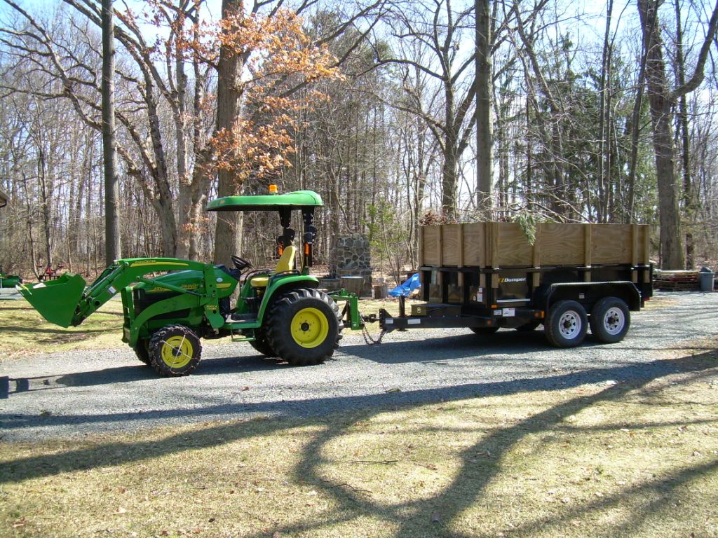

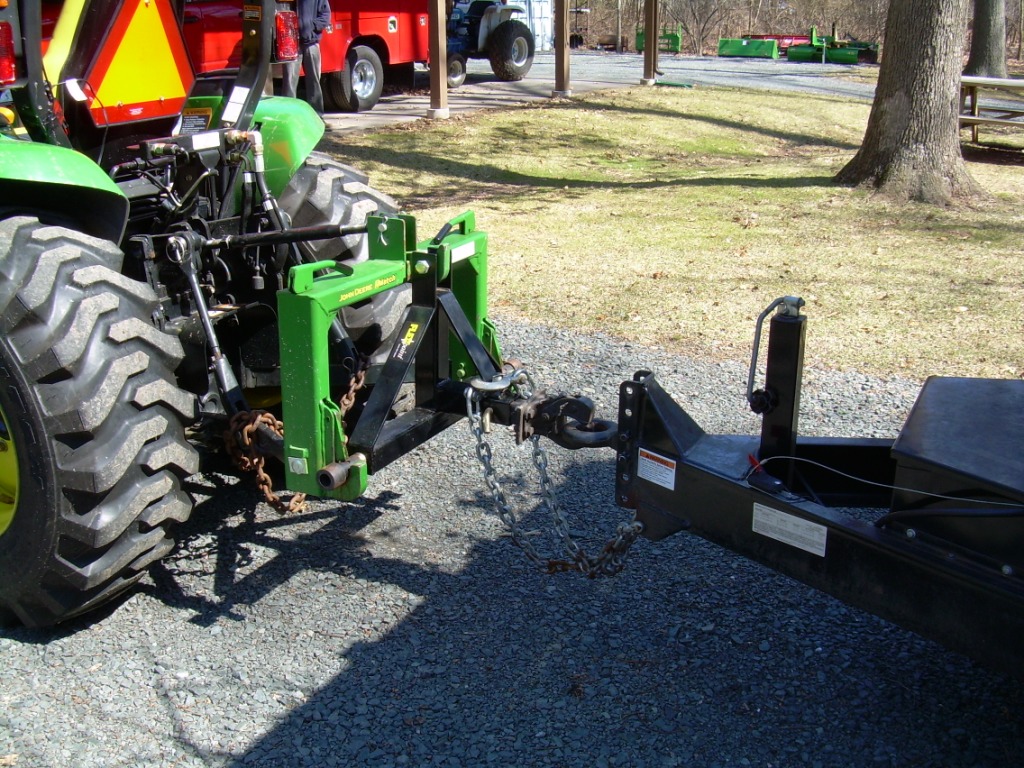

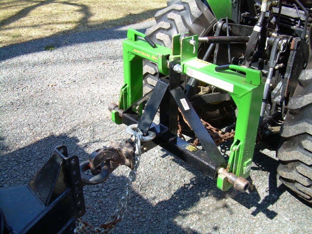

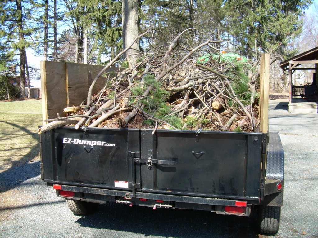

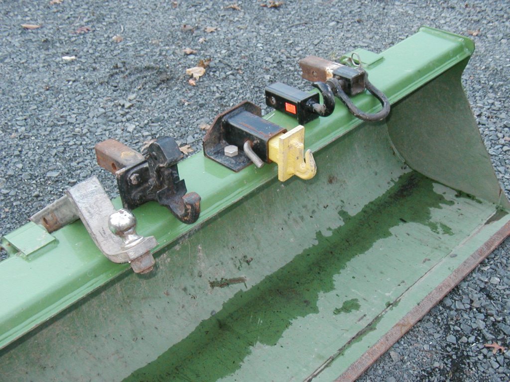

I went all out and bought the flexpoint a couple of years ago, haven't used it much but had a chance the other day and snapped a few pictures.
I do like the EZmover but wanted to use the draw bar for other things so I spent the extra money and got the Flexpoint, they also sent me the extra outer receiver tube welded to a piece of angle iron (to my specs) that I used to make my "bucket buddy" something I couldn't live with out now.
The trailer I was pulling is a 5 ton dumper with a lot of tongue weight but I still put a chain on it to prevent it from rising to far, as I was going down some steep slopes, it has all the clearance to do some tight maneuvers.

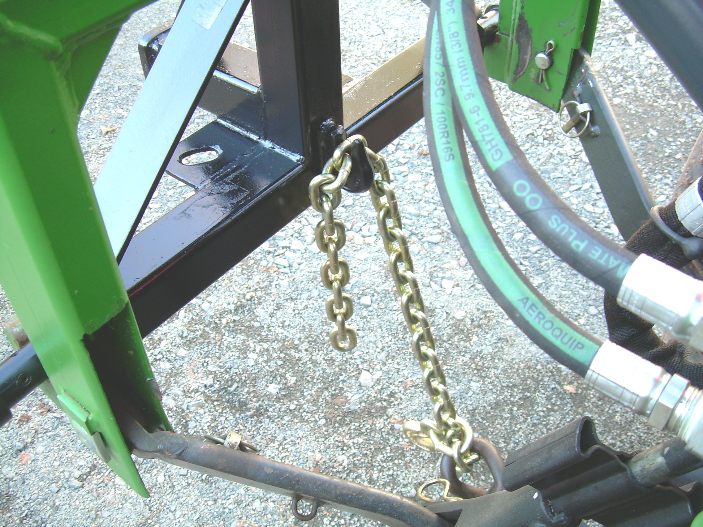

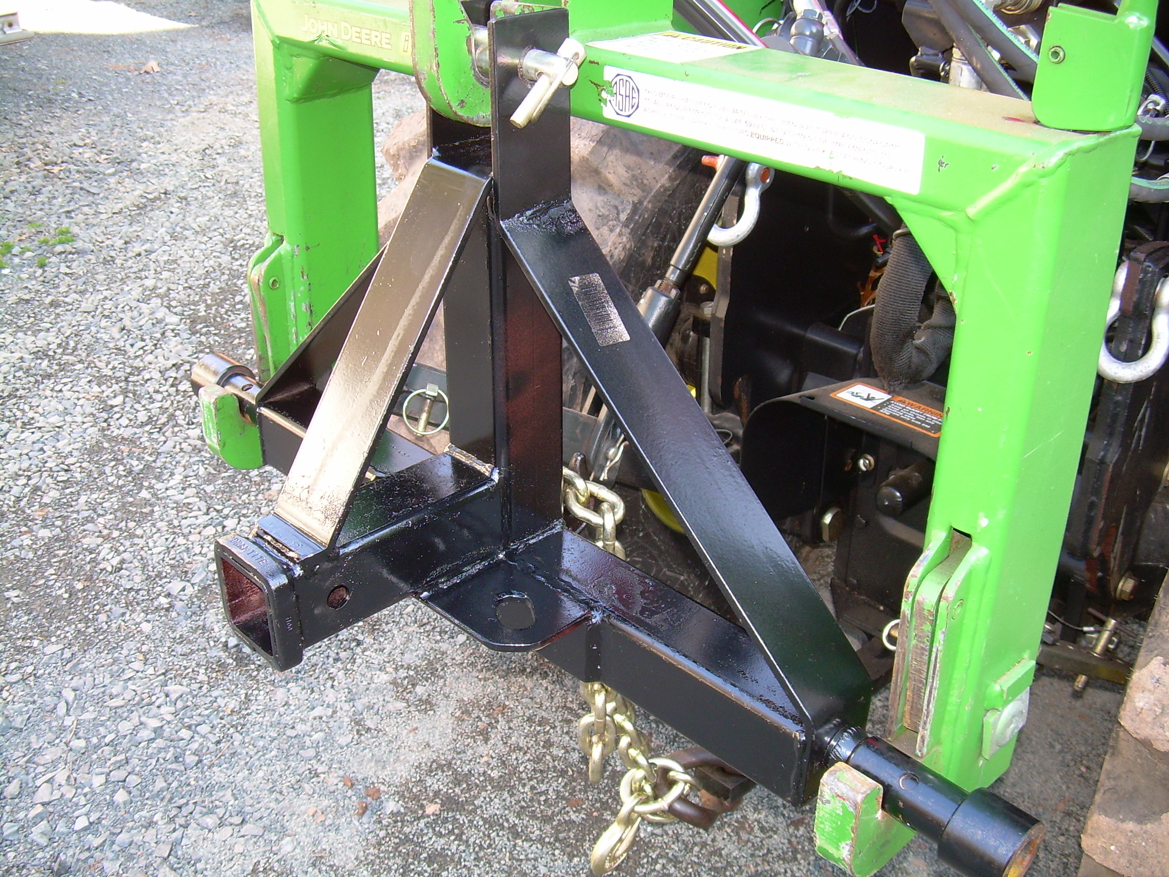

Just a little update on my Flexpoint, finally took the time to put a trailer safety chain rings and a grab hook on the back for a limiter chain, also put a collar on the receiver tube front that came off an old tube.
I have been using my 5 ton dump trailer with the tractor, I have a steep driveway so was worried about the trailer getting away, also want to be able to dump the trailer. With a heavy load in the trailer, before it slides out when the bed is way up it puts a forceful upward pressure on the hitch, which could cause trouble for the 3PT system, the chain to draw bar should prevent that.

Great Job. that restraining chain you have there is just what many here need to see. Thats how I have mine setup also. adjustable and snug.
