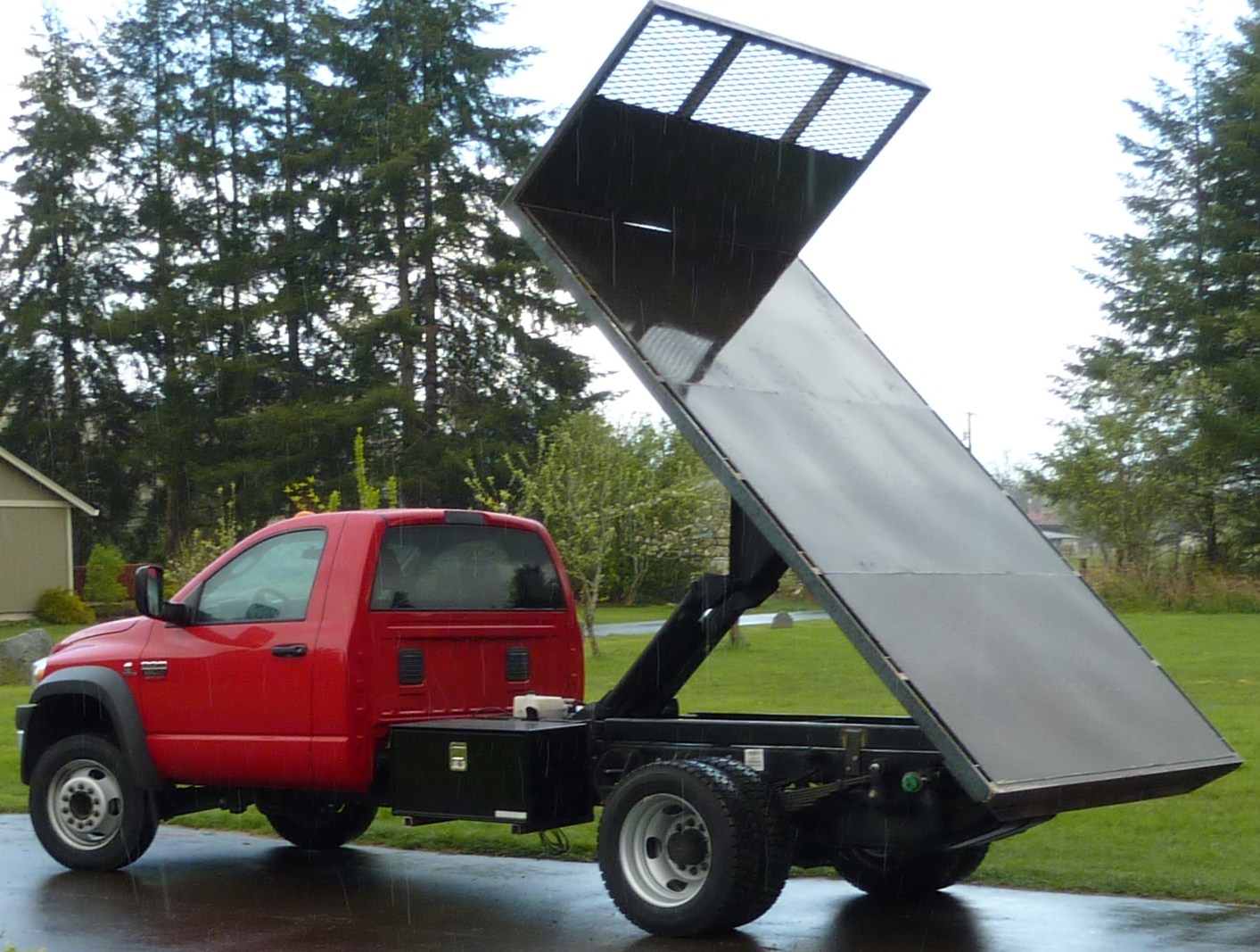

I too have built several flatbeds, some with hoists, others without. As you are building for a Ranger, it doesn't have to be built with heavy material.
I would take some 2x2 square tube for the two long runs on the frame. Use about 6, 3 on either side of 2x2x3/8 flatbar from the 2x2 down and bolt to the frame on the sides, not the flanges. Use 2inch angle iron for cross pieces. I/8in should be heavy enough. on the outside I like to use 2x4x1/8th tubing for stake pockets. They let you use a 2x4 for stakes. By tying the 2x4 into the crosspieces and to the outside piece that runs the length of the bed like a 1/4x3in flatbar, it ties up the sides and crossmembers really well. Making a headboard is just a matter of tying it into the front of the bed.
If you want to put a hoist in, I would get the one you want before starting this project as you will need to know clearances in your frame and height between frames.
This bed is of course a lot more than you need, but if you look close it will give you an idea of how the stakes tie in the crossmembers and the outside rail.
When putting the pockets in, take care to think of the thickness of the material of the deck so you can adjust the height of the pockets on the crossmembers so they will be flush with the finished deck.
Have fun
