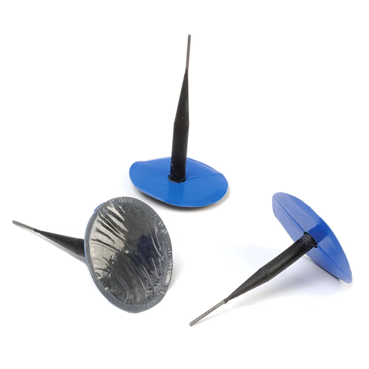

I usually put tubes in. But a another way is this
I bought it to carry on my motorcycle for trips, but it works great for lawn mower tires it will sometimes even seal a side wall on a mower tire if it’s a round puncture and not a tear.
This is similar to a mushroom plug system we used when I worked in a gas station over 50 years ago. We plugged lots of tires, it only took a few minutes and I never saw one fail. I always wondered why I never see it now.
   / Flat fixers, Slime vs Fix-a-Flat vs others. #16
Well i think in Texas the DOT mandated what's a 'legal' tire repair, because now in the public community college i teach automotive in, we are only 'allowed' to teach combination patch/plug units.
Never used the mushroom plug myself but ive heard of it and and everything i've heard is good.
