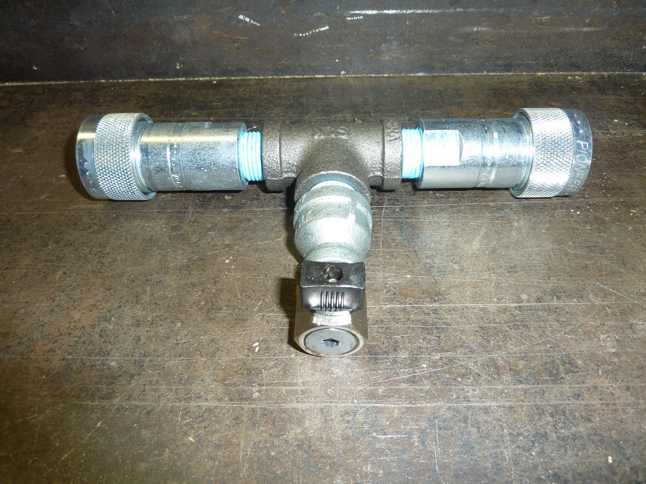

The pressure on the tractor side can usually be relieved fairly easily. There is no doubt most of the problem is on the implement side. It isn't just temperature change that causes pressure binding in these implement couplers. Moving the implement and cylinder bleed down also contribute to the issue. Connecting the hoses together can often make them difficult to separate when pressure bound. This can sometimes double the effort when connecting an implement to the tractor.

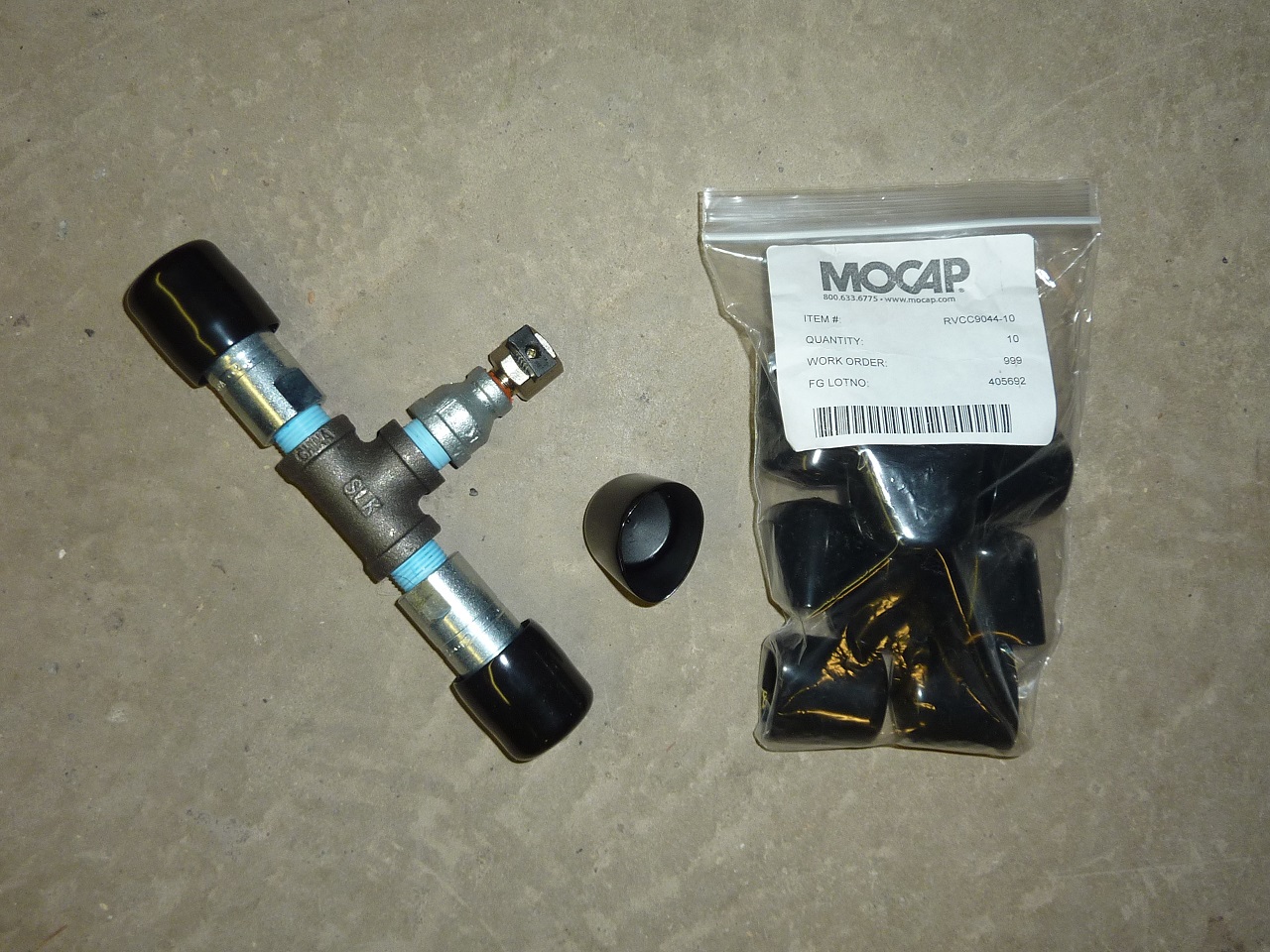

All female QR couplers with sliding collars can bind up when dirt gets between the collar and barrel. Once in there, it can be difficult to clean. Ordinary female coupler plugs protect the inside of the lock chamber but not the barrel itself. I've had good luck with these simple vinyl caps which slip on the outside of the female coupler:
They aren't perfect but they do help keep the coupler barrel clean. The one shown is for a Pioneer ag type coupler with an OD of 1.5 inches. Other diameters are available and cost about $1.
