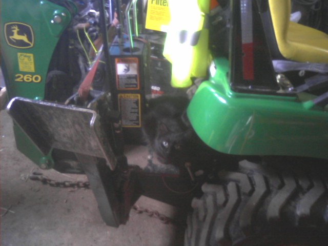

flashers/turn signal lights wouldnt come on today. worked fine yesterday,didnt do anything different. here's what I checked:
1. fuses- all good
2. headlight and running lights work in their 2 switch pos. flashers dont in any switch pos.
3.have power to the rear work/aux wire taps( no lights intalled off them) no power at hazard light bulb fixture;little run lights have power.
4. have power coming into light switch
5. can hear flasher clicking when switch turned on,but no lights.
did search on here,found little; some worked again when dried out, some were switch problem. any other ideas where else to look? is flasher sep unit on this model or built into turn signal switch? Greenie is 2305 tlb 156 hrs, :confused:

oops didnt list that. I checked both bulbs the running light in the 2305 is an actual seperate little bulb . they work but socket base for the large bulb (flasher) has no power to them when switch is on. thats why Im thinking either flasher unit or somewhere from flasher to light base is the problem. :confused::confused:
   / Flashies no flashie
warmer today so spent time with Greenie. got into wiring harness and apparently problem is the flasher relay unit itself. jumped terminals in plug to flasher and lights came on steady,so not a break in wiring from flasher to rear lights. ordered a new one, won't be in for week. So guess I cant go on street till get my flashers back to work
