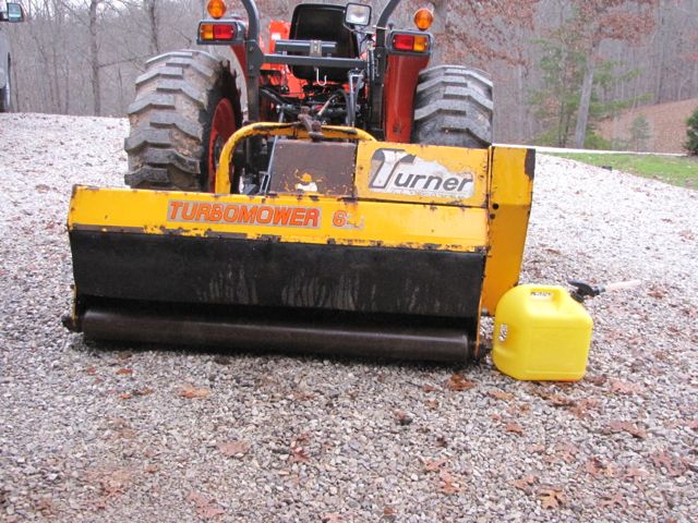

My question is should a flail mower have a slip clutch or a sheer pin? The one I recently got does not and I am not sure if there should be one. One idea what that there is in internal clutch or the idea is the belts just slip if something jams up?
(mine is a Taylor Turbomower 64 if that matters)

Here is a photo to help explain what I am talking about - it is a little bigger than most of the ones I have seen s far.....
