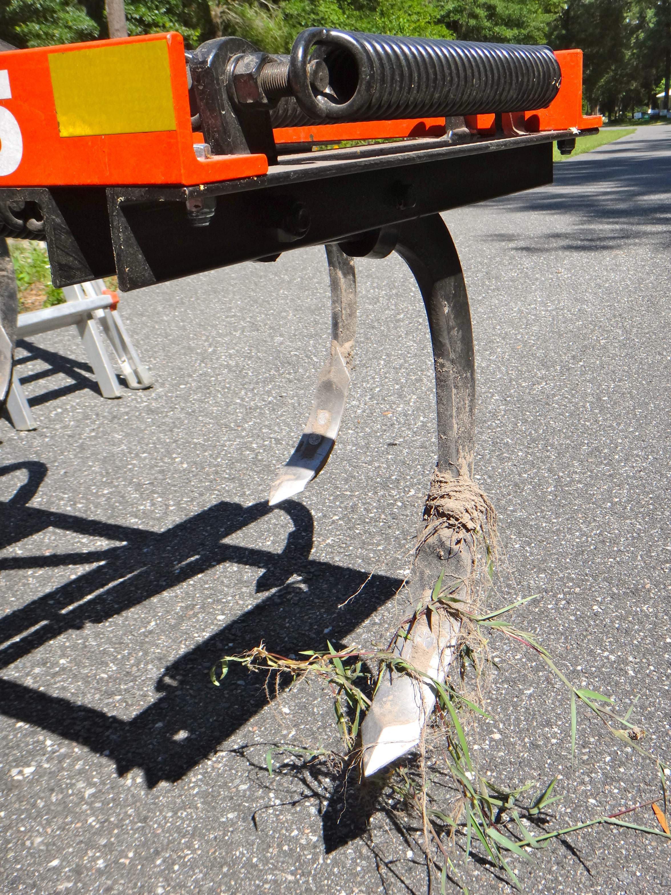

Here is a thread on my search for an implement to clear vines, multiflora rose and honeysuckle: http://www.tractorbynet.com/forums/...ement-vine-root-removal-woods.html?highlight=
