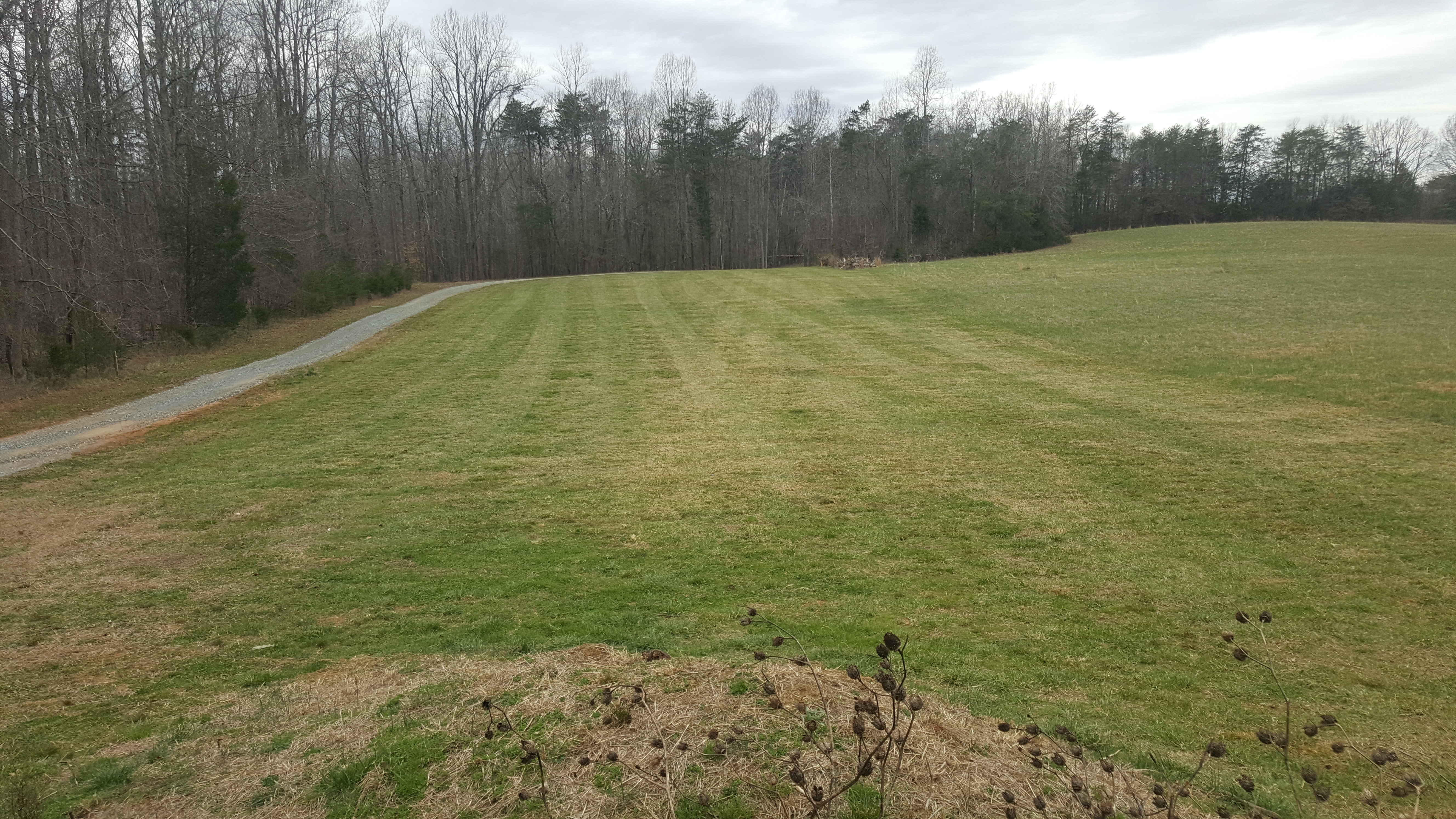

I ran across a Rhino RHD88 which looks like a rebadged Alamo super heavy duty 88" mower. The seller has it listed for a fair price and I'm wondering how the Rhino/Alamo would cut compared to my Deere 25A. I don't have any complaints with the Deere. It's runs smooth and cuts well. The Alamo has a wider cutting swath which would be nice for trimming fields. My Deere has the duck foot style flails and the Rhino has Y shaped cutters. Will there be a noticeable difference in cut quality. I mainly cut tall grass and very light brush no trees. Would it be worthwhile to trade up?

The Deere 25A has a 78" cut. Even with worn out duck foot blades it cuts pretty well. Mowed some of this field today grass was about 6" high. The Deere flail always stripes really nice. Not sure if the Alamo will cut like that.
