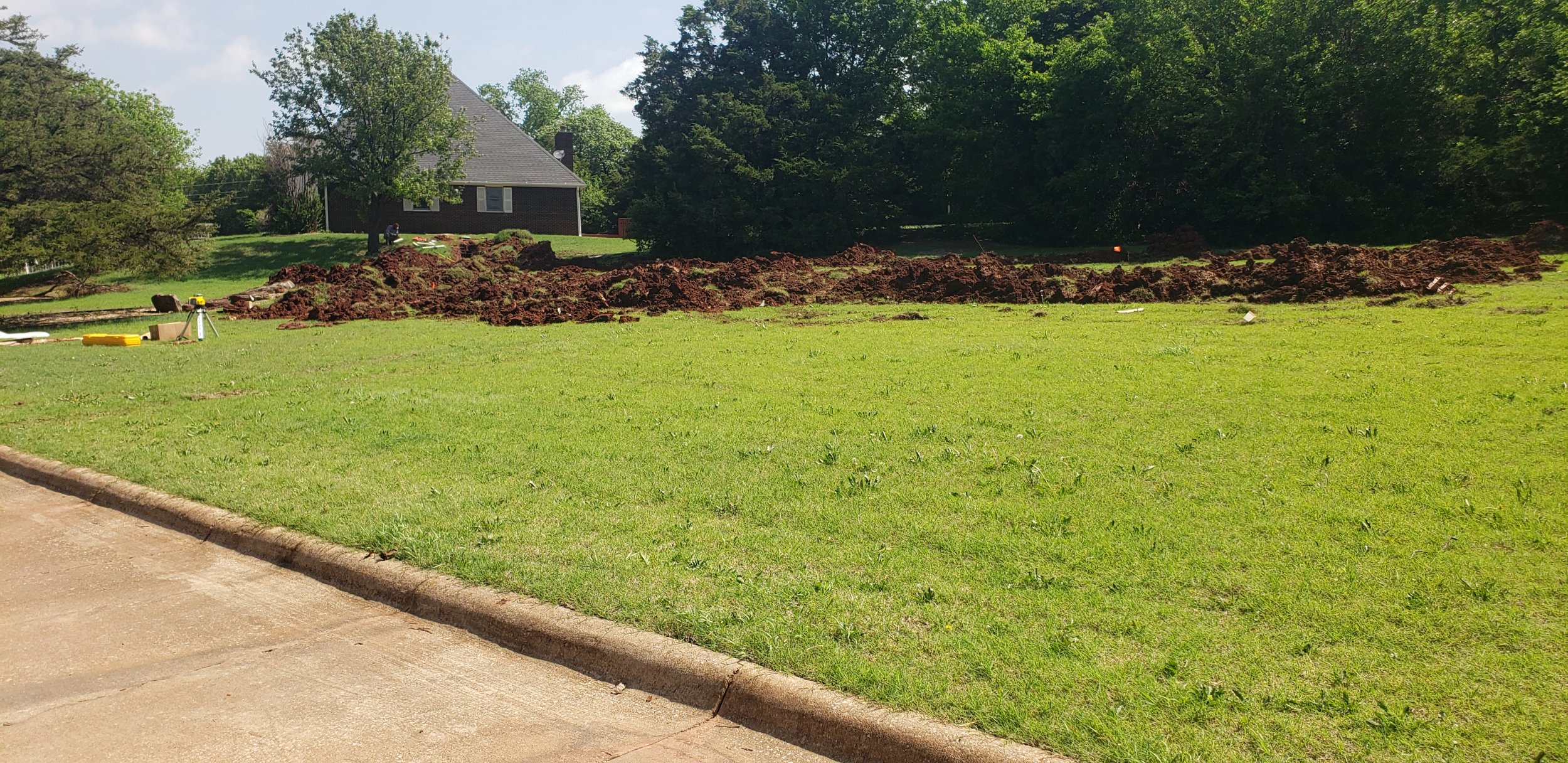

If you can get your hands on a harley rake that would be the way to go. Ive been finish grading for 17 years and I don't bother with killing or cutting grass. You just need to run the dirt over that you pull in to the ruts quite a bit so it doesn't settle. I think I spent maybe 30 minutes fixing these concrete truck ruts where a customer had a pool installed.
