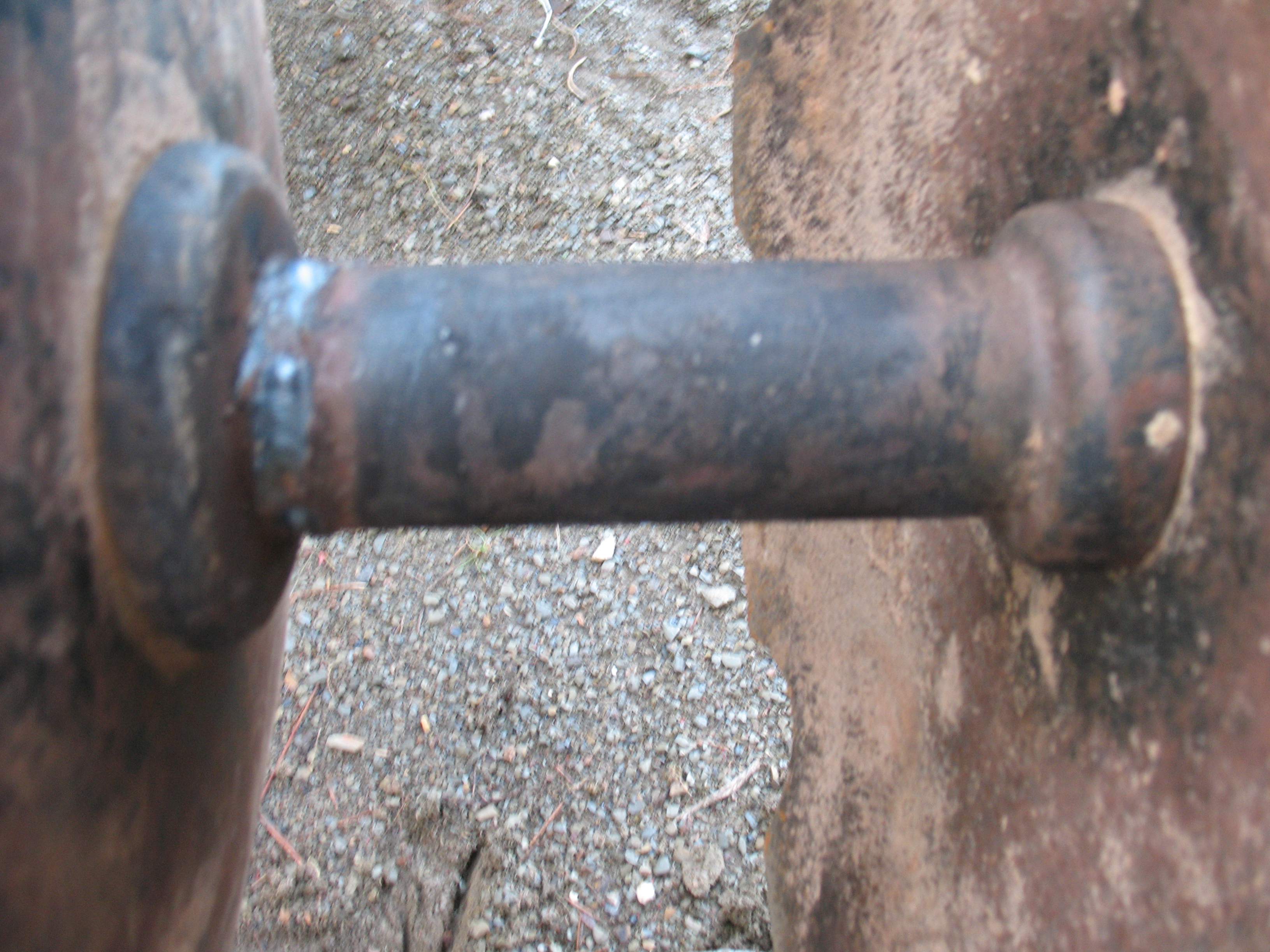

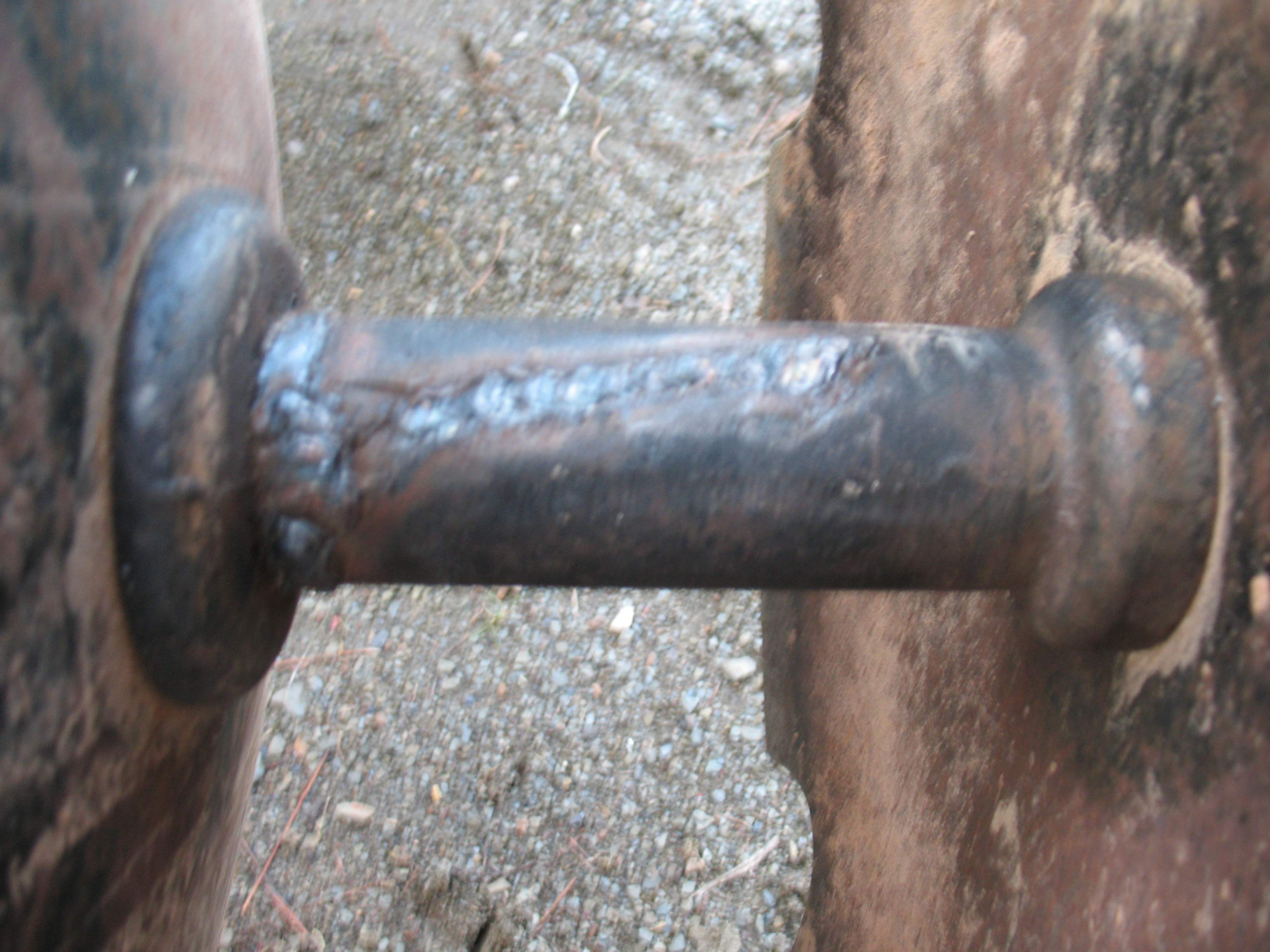

I guess I backed into too many trees because I have two bent axles on my disc. Today I decided to take it apart and straighten out the axles. I got my impact gun and took out the bolts holding the bearing carries for both rear gangs and lifted the 3PH up and neither gang fell. Looked under the bracket and the previous owner had welded all the bearing carriers to the gang support tubing. So first I tried to grind out the weld and got one on the inside but couldn't reach the other 3 welds even with a 9" blade, it was time to break out the oxy torch. I got one gang cut loose and decided it was time to disassemble it. I got all the parts off till I got to the bend and then the spacer spool wouldn't go by the bend. Well I did a little hammering on it and sure enough I was able to get it off, but it broke the end off the spacer (cast iron you know). I said what the heck, see if it will weld back. I put a bevel on one side and stuck both pieces back on the axle to assure alignment and put 2 passes of 7018 on it. It had a little magnetic arc blow and welded a little like metal with dirt on top of it, but it stuck together. I have it soaking in my 350F rod oven for a few hours then I will put it on the outside edge just in case it breaks, it will be easier to take off.

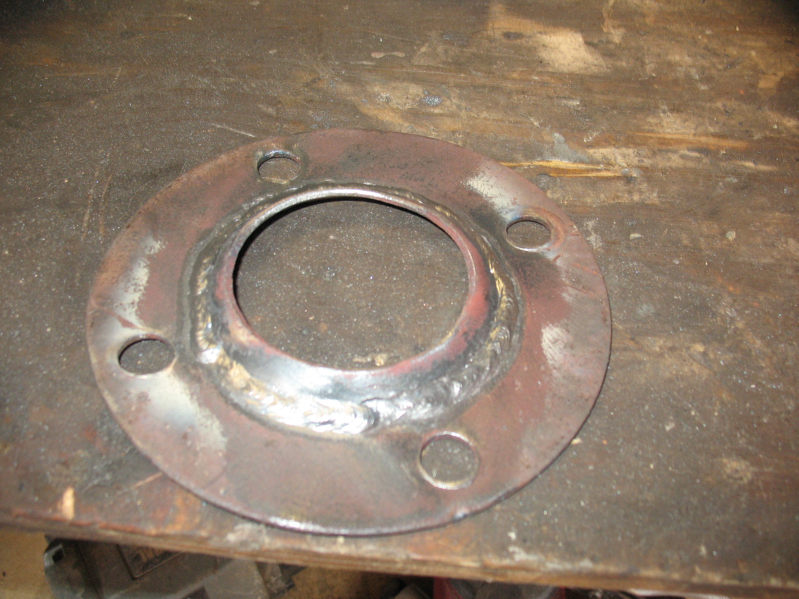

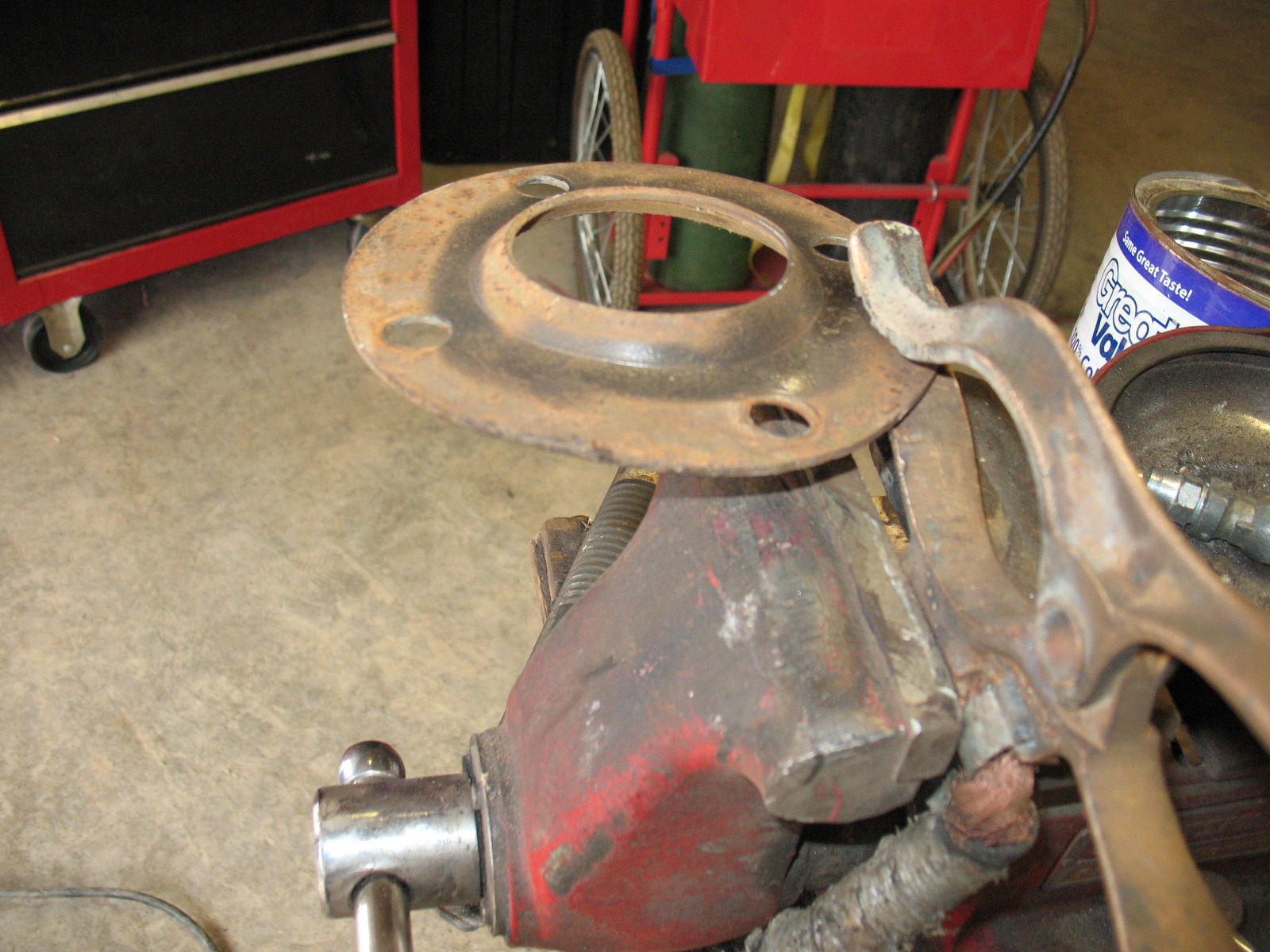

While I had it all apart, I looked at the bearing holders and all of them had at least one side torn about half way out. This is the little 1/16" thick plate with 4 bolts that holds the sealed bearings in the carrier. I got them all straightened and welded up the broken spot plus the rest of it. Each one has a pressure mark that is a slight scribe line where the press tool left a line around it when they put the lip on it. All of them break right in that press mark. The bearing are old old, so while I had it apart, I took my little needle bearing greaser and put in about 10 shots of grease in each bearing. I drilled a 1/16" hole in the steel seal, and pumped grease till it came out around the seal, rolled it several rounds and pumped more grease. It should be better than new now. I know it has more grease than new. Now to get it all back together then tackle the other gang.

I will see what pictures I can get of the spool. I didn't try to make it pretty, just to hold together till I could put it own.
   / fixing my disc.
I got no before pictures. I have to admire you guys that carry a camera around with you and take time to photograph everything. Anyway here is what the spool looks like after I did a quick and dirty weld on it. I beveled the edges on the long side and left it in the as broken condition on the hub side. There was one long crack running linear which I ground a groove in and welded it up also. Might have been more but I didn't take a lot of time with it. Figured if it broke, I could maybe get a replacement at TSC or Agrisupply. Sorry the camera didn't want to work very well this morning. They looked good in small size but get fuzzy when full size. Anyway, welding it was kinda like welding on potmetal as it just kinda dissolved as the rod passed over it. Main thing is it didn't crack when I put the impact to the axle nut.

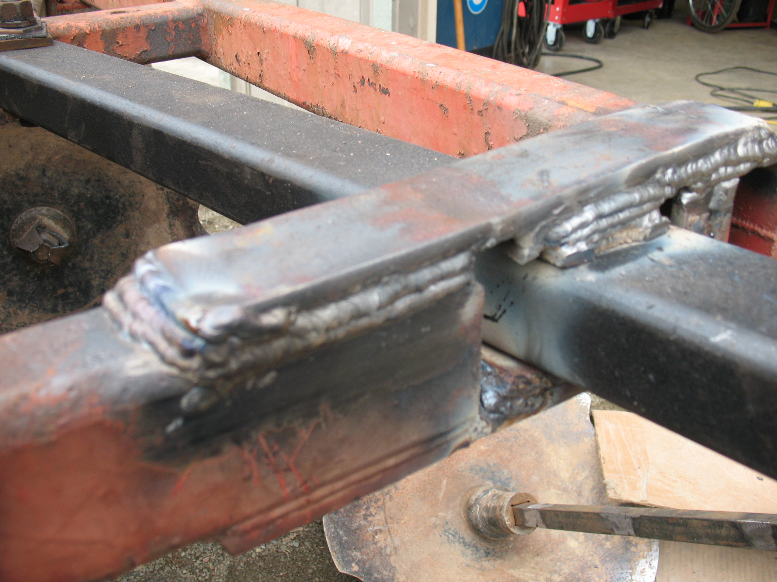

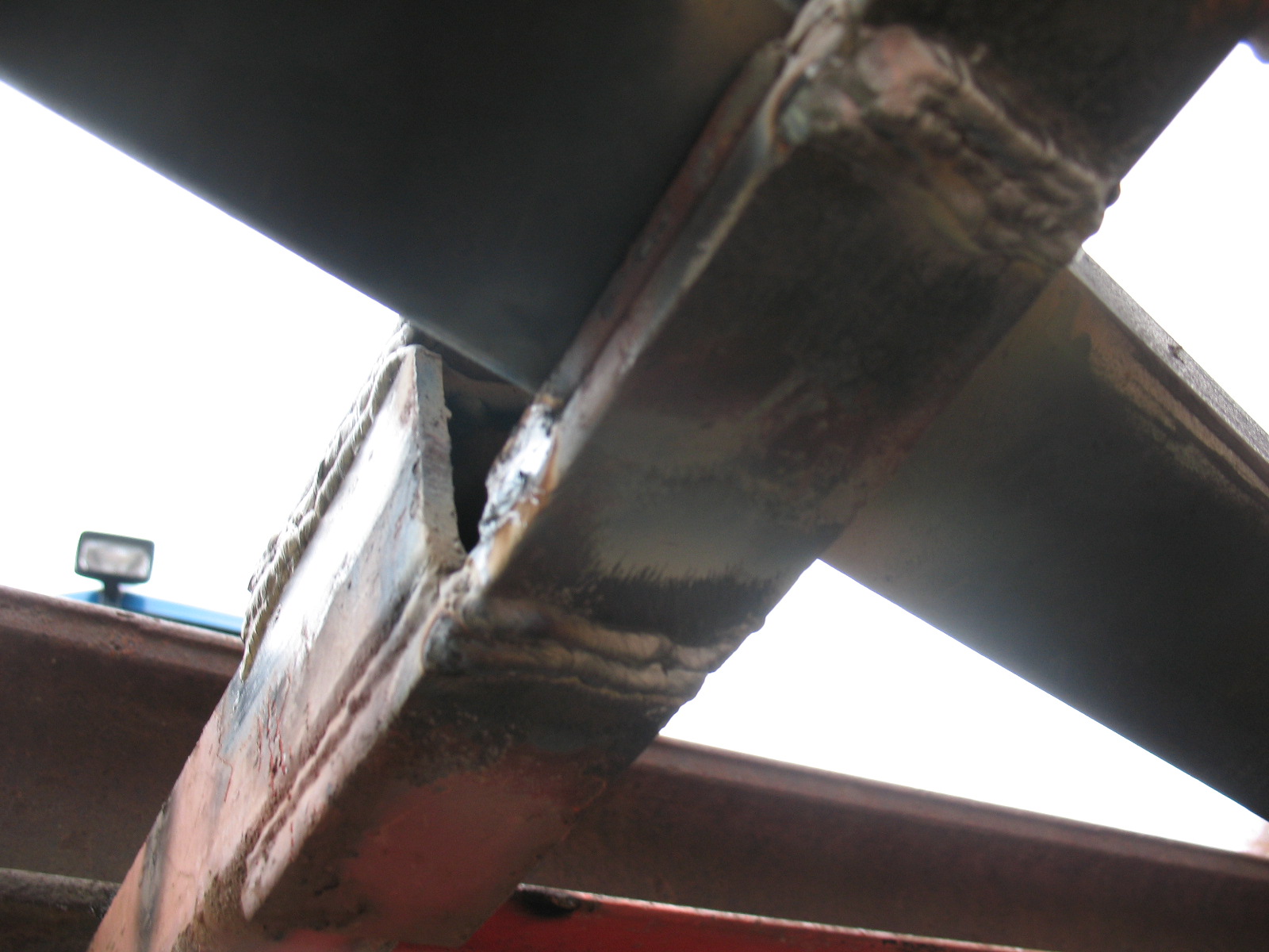

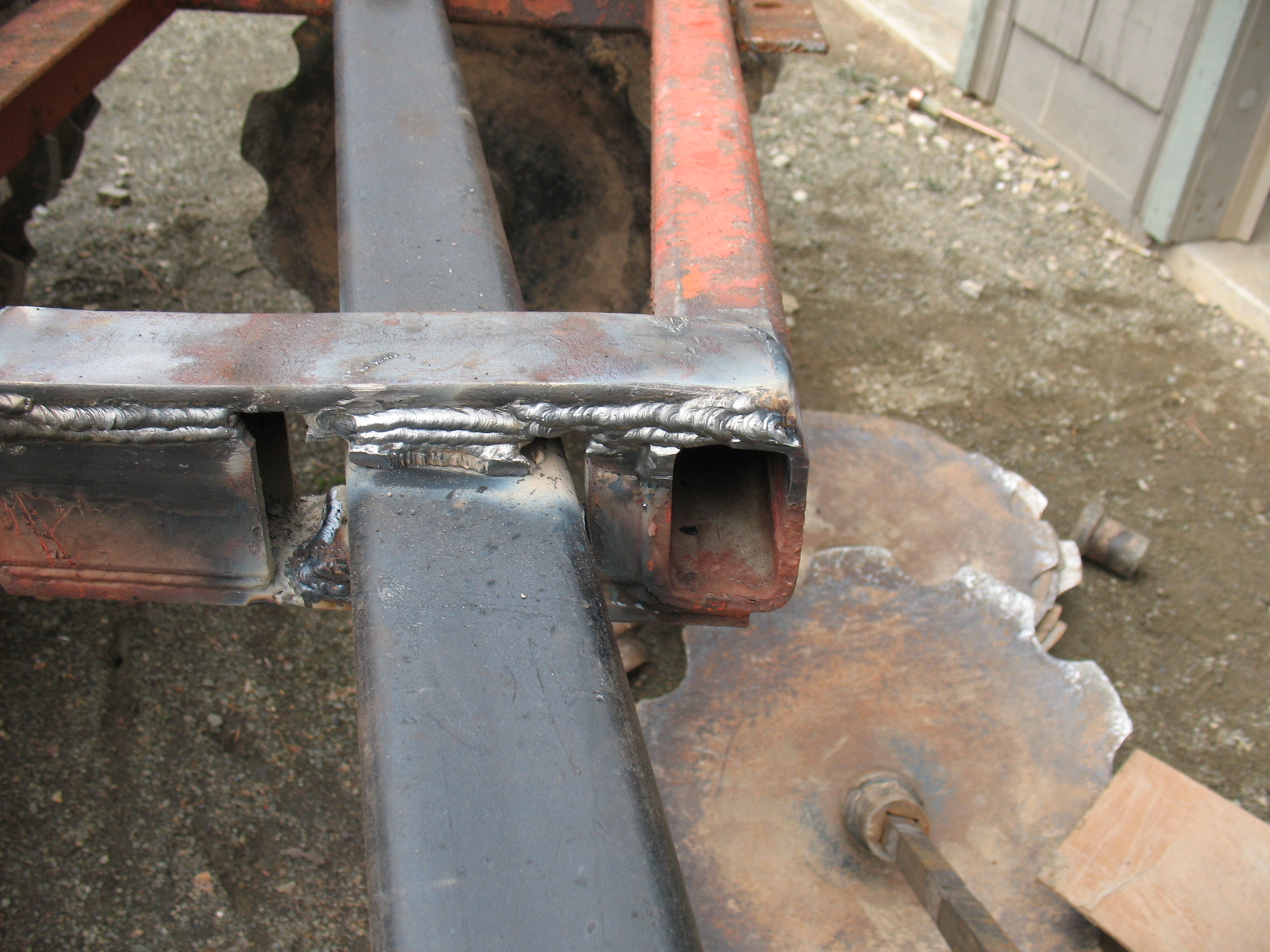

IMG_1168.JPGIMG_1169.JPGIMG_1171.JPGIMG_1172.JPGIMG_1173.JPGI finally finished all the welding, just have to put the gang back under the gang support. I found some 3/16" scrap plate that was just right to take up the slack in the outside support so the gang will not rock back and forth so much now. Even repaint the gang support.
Overhead weld is kinda crappy looking gorilla weld, ugly but strong. I just couldn't get my tri-focals to get in the right position to see it so it was welding blind practically and looking right into the afternoon sun so I couldn't even see the weld area prior to striking an arc.
The bearing holder photos, you can see the scratch in the metal from the press when they formed it which eventually caused them to split right at the line so I put a light bead around them all. Also drilled a small hole in the sealed bearings and using a little needle apparatus pumped them full of grease so now they should last another 20 years. The bearings were all tight but I could tell they were dry of grease. About 10 pumps per bearing with my pneumatic gun. I would pump it then roll them and pump some more till it started coming out on both sides of the grease seal.
