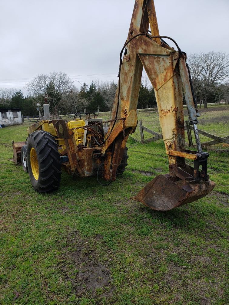

Subscribing for this. Need to repair the ones on a loader/backhoe I bought.
Ford 3500 diesel

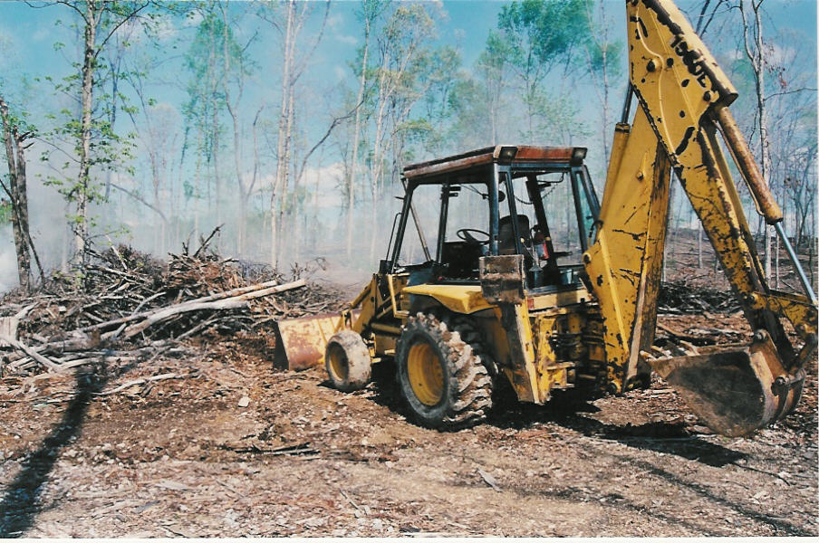

I had to fix my boom cylinder (biggest one on my backhoe) and it's buried INSIDE the boom section of the backhoe. They say you have to dig a hole, then plant the hoe into the hole to allow you to crane it vertically.....then reverse process to put back in.
Not going to happen here.
I had recently had shoulder surgery so was still a "one armed bandet"
We have a dry pond. Backed up to it, layed hoe down into it and it looked like the angle was enough to pull cylinder out (probably weighs 200+ pounds?? but I have no idea. It IS the biggest/heaviest on machine and the backhoe will dig down to 15 1/2 feet deep so it's a big machine.
Layed hoe into dry pond, loosened things, took a bunch of ratchet straps, mounted them to the loader bucket, draped OVER the cab. Using them to winch/hold, slowly got cylinder pulled out of there (with one arm). Then, using more ratchet straps, pulled the hanging end over to truck and as I tightened those in truck, loosened those on loader bucket, worked it into the bed of truck.
I had crawled all over this thing like a monkey moving things inches at a time...
Literally, 2 minutes AFTER I got it into the bed of the truck, my wife's cousin (next door neighbor) came out and asked how he could help..... me...... then with a puzzled look on his face, he sees cylinder in truck, my arm still in a sling and just stops and asks "how in the H... did you do that???"
I just smiled and said "I'm a persistent little bulldog"

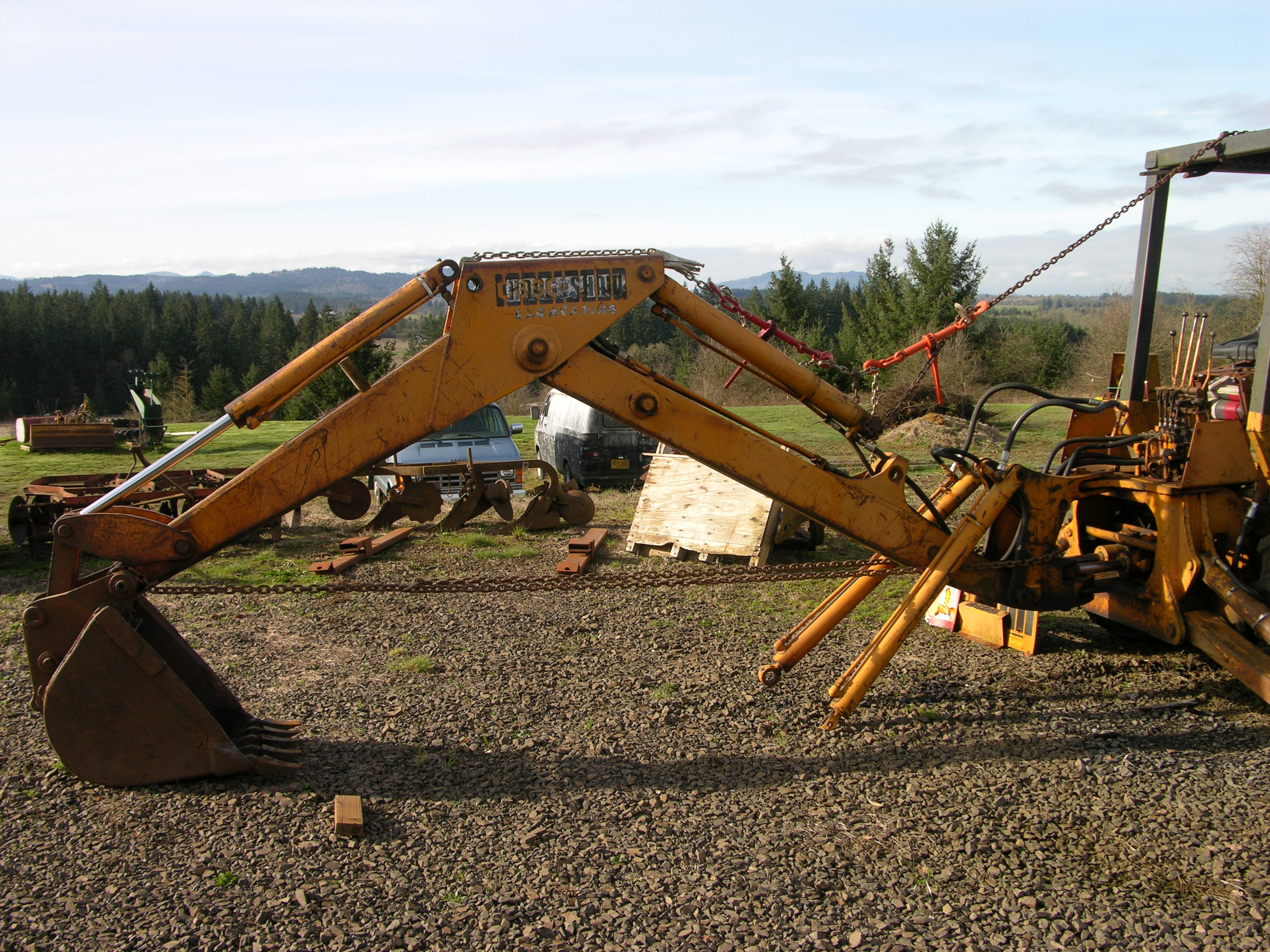

Boom cylinder is buried inside the boom. Clean appearance but more difficult to reach. The two you see are for the bucket and dipperstick (I realize most probably know this)
   / Fix your own cylinders #8
"I realize most probably know this"
Not necessarily Richard - I think each brand of full size backhoe has their own "gotcha's" - My old Case 580B cylinders are (almost) reasonable to work on
But the brakes are ANOTHER story :rolleyes:
And the above pic is about to be "revisited", that was about 12 years ago and only a "re-hose" job; now, every cylinder on the hoe itself is a good way to dump hydraulic fluid on the ground, just move the lever :eek: ... Steve
