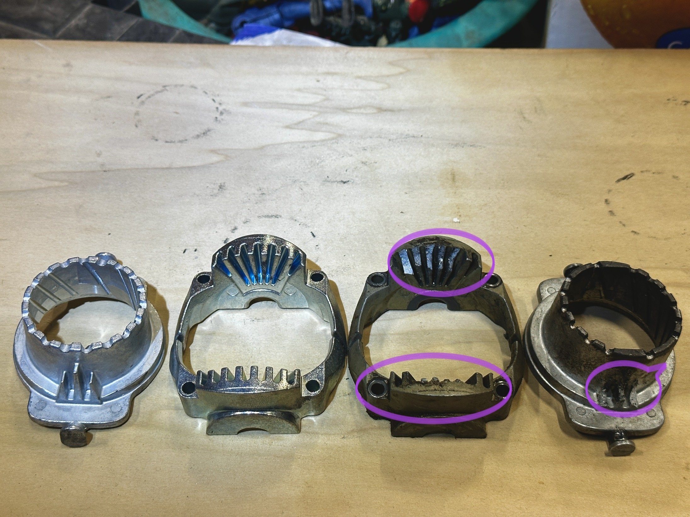

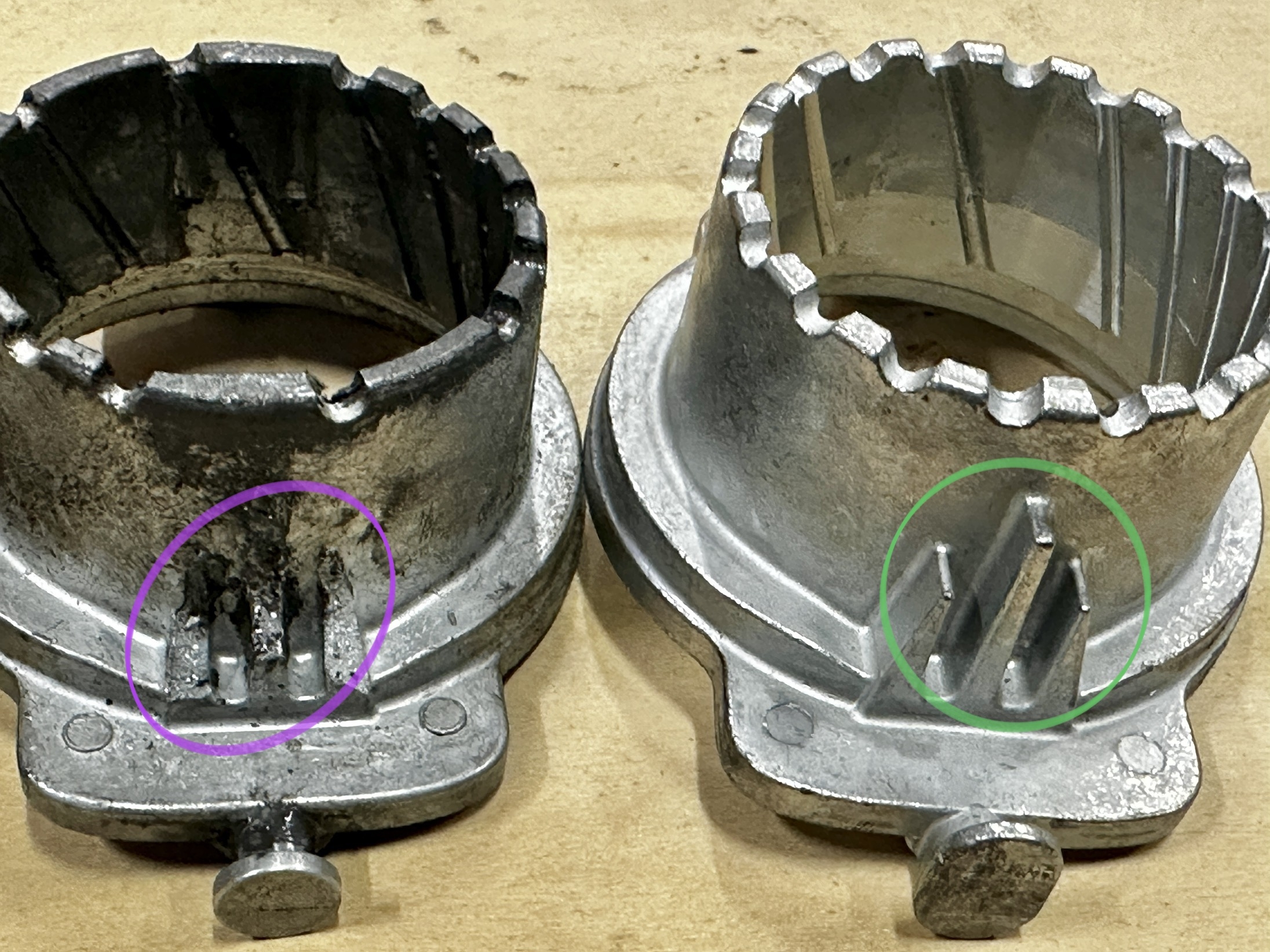

(Apologies for the Necro post, but still a relevant problem and this is a good thread on the topic). :p

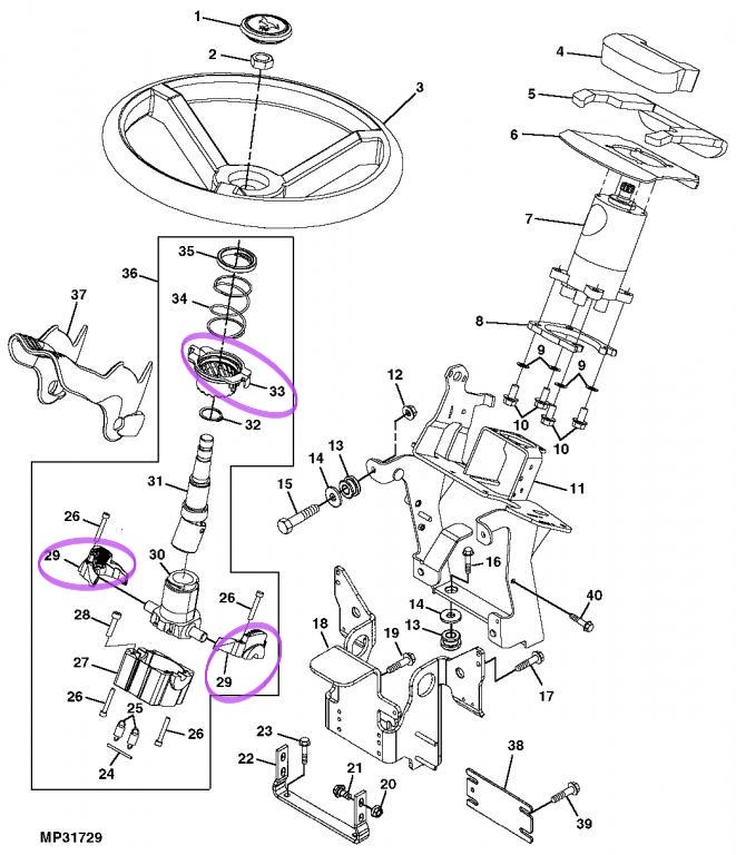

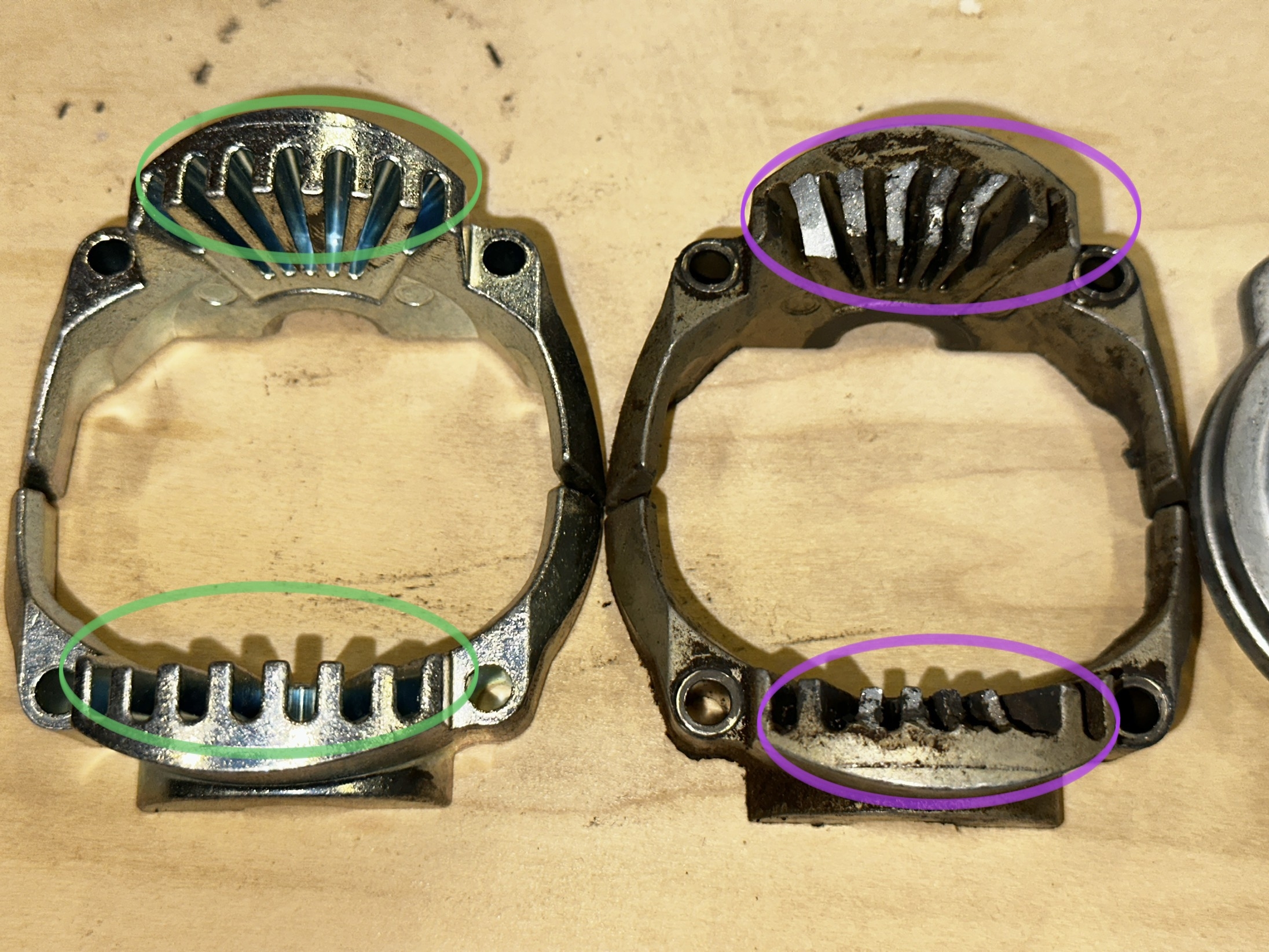

Bought our 4310 NEW in '04, LOVE this little tractor. Within the first year we started experiencing the Tilt wheel lock loosing teeth, finally down to the only catch is the very bottom which we cant use as our legs wont fit under the steering wheel that low and the seat suspension height adjusted proper, so today disassembled the cowling to see exactly what is amiss and per exploded parts view, (thank you Randy), #33 (part# LVU 16996) busted its teeth on each side, AND #29 (part# LVU 11559), had busted all but the final bottom catch on both sides. Quick search online was able to find the exact John Deere parts numbers listed then on eBay was able to find those components. At the time this is being posted price for #33 the collar is $95.30, and #29 the lower guide bases, (#29 is a paired set, sold as pair), $53.94.
Parts arrived, installed, oh so happy to have my steering wheel not flop around. :cool:
Now if I can break the bad habit of using the steering wheel as a grab-handle when I get on and off the tractor I shouldn't have to replace these components again.

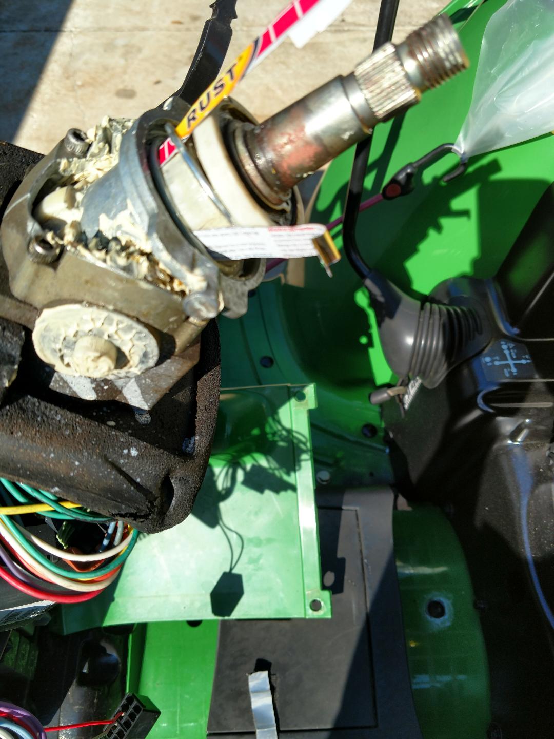

The work is fairly straight forward getting the steering system disassembled and reassembled, though getting the tilt handle lever reengaged on the collar during assembly!? :oops::mad: ...took a little bit and a few a colorful metaphors. Didn't find any real "trick" to it, just back and forth side to side with flashlights, mirrors, a borescope camera and mostly just lucky working it in Braille.
Hope this helps someone experiencing the same issue with these weak tilt-wheel mechanisms.
