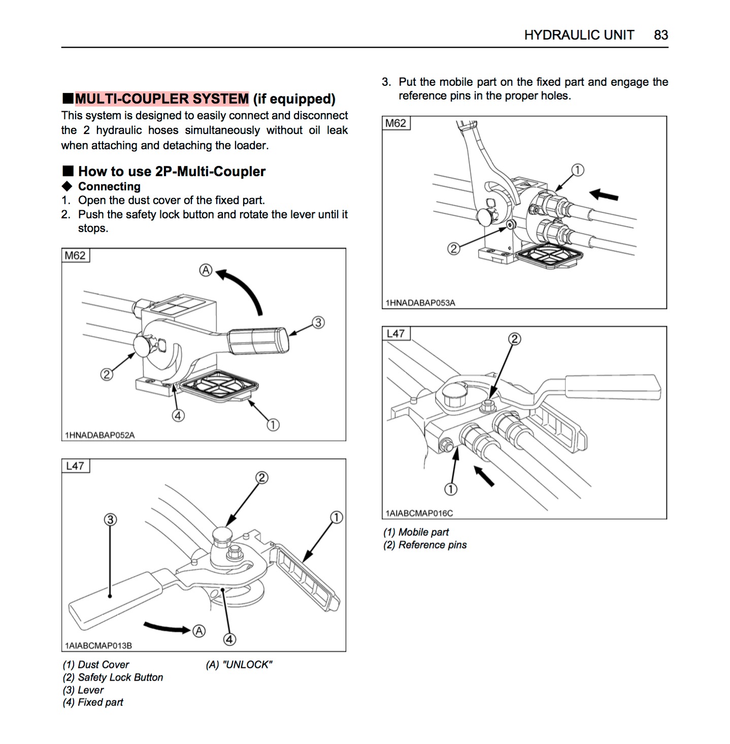

Has anyone tried the new M62 MULTI-COUPLER SYSTEM?
