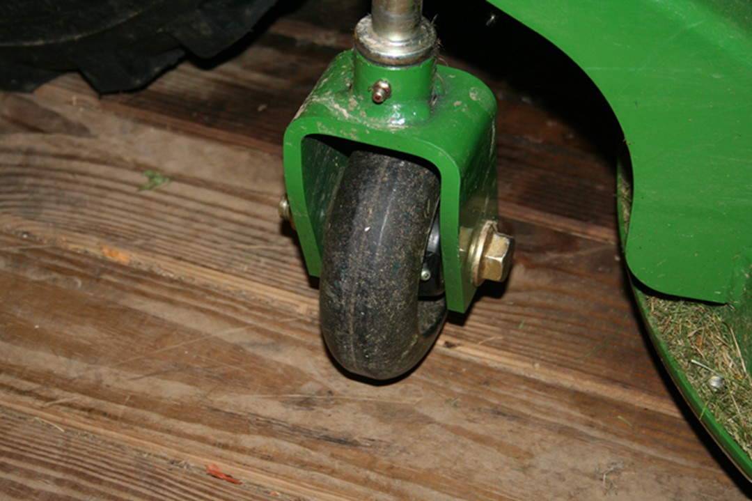

I believe I have come up with a fix for this problem.
I added grease zerks to the pivot points. The wheel bracket now spin very well on the shaft.
I also rounded off both the square edges of both wheels. I used a 1 1/2" radius router bit to round the wheels. It makes a mess. The dust that comes off the wheels is very fine.
I mowed tonight for the first time after making the fix & the wheels did not dig in one time. It raind today so I was not expecting it to work so well.

Sorry Chris,
I have been working to much. I was lucky to get the mod done & the yard mowed.
   / Fix for 62D MMM Creating Divots with Front Wheels #8
chevy said:
Sorry Chris,
Chevy , read my reply to the other thread about the problem. the wheel is not offset enough to work right. it was a design mistake. you need to brake out the plasma torch and welder. its a easy fix...:) Maybe i should get all of you to send your wheels to me for fixing. i could get rich. :D 3 inch offset. and it will never dig in the yard again....;)
#9
Thanks Chris.
Now I feel like a moron. John Deere had the idea first.
I should have read more about the problem here.
