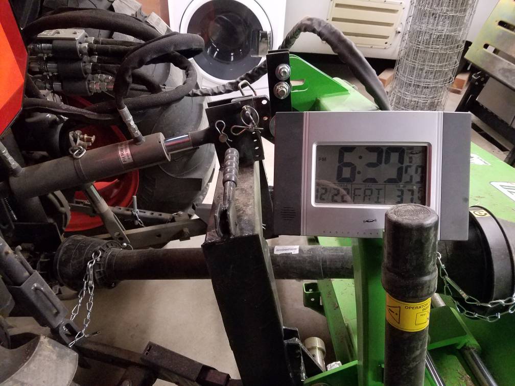

Brian, what is your "std retainer"?
Simply a hose clamp with the band covered in heat shrink wrap holding 2 links of chain. The chain typically will hook onto most std top link retainers. This does not work for some of the bigger tractors that actually have a rod that latches from the top link back onto the tractor. But could easily accommodate hooking a rubber strap from the tractor to the cylinder on those tractors that have the rod that I had mentioned.
   / Fit Rite vs HayTools Hydraulic Top Links #22
Some kind of clamp (hose clamp maybe) with some chain on it. I debated even putting it on as it's useless to me because the Quick Hitch means the cylinder is never unmounted on 1 end. Seemed solid enough so I attached it anyway rather than find it on s shelf in a few years with no clue what for.
Clock is there in the photo as I was measuring how fast the Kubota rear valves leaked down (an inch an hour or more on the sidelink now after their 3rd repair). Leakdown is not from Brian's TnT cylinders at all. The cylinders took forever to get but were worth it. My 1st set along with valves & other plumbing from Fit Rite ran off with the old L3200. 20171222_182931.jpeg
