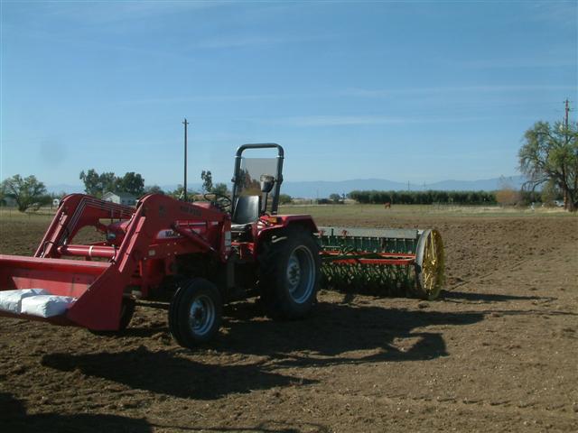

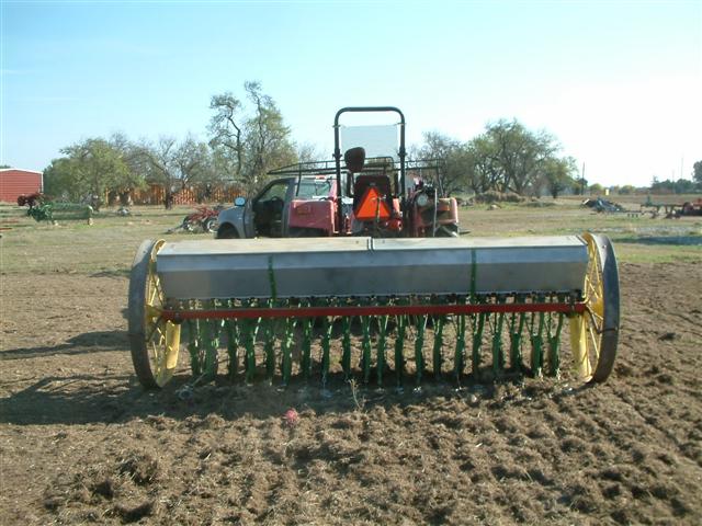

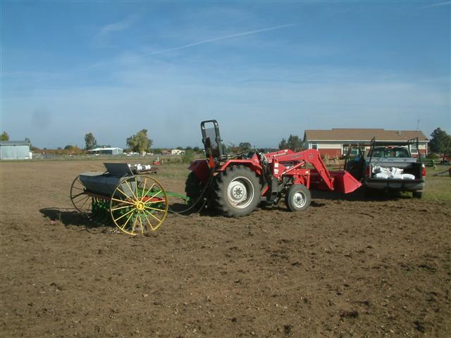

I have 10 acres also. I use a 2008 Mahindra 5525 tractor (54 hp engine, 45 hp pto, 2WD, gear tranny 8F/2R, power steering) with the ML250 FEL (6-ft wide bucket, 2950 lb lift to 10.5 ft height). Mower is a Massey Ferguson 31 sicklebar (7ft cutter bar, $550 at auction, rebuilt several times, about $250 in new parts). Rake is a John Deere 350 side delivery rake (10 ft wide, 5 bars, $800). Baler is a Massey Ferguson 124 (two twine, small square bales, $2000).
