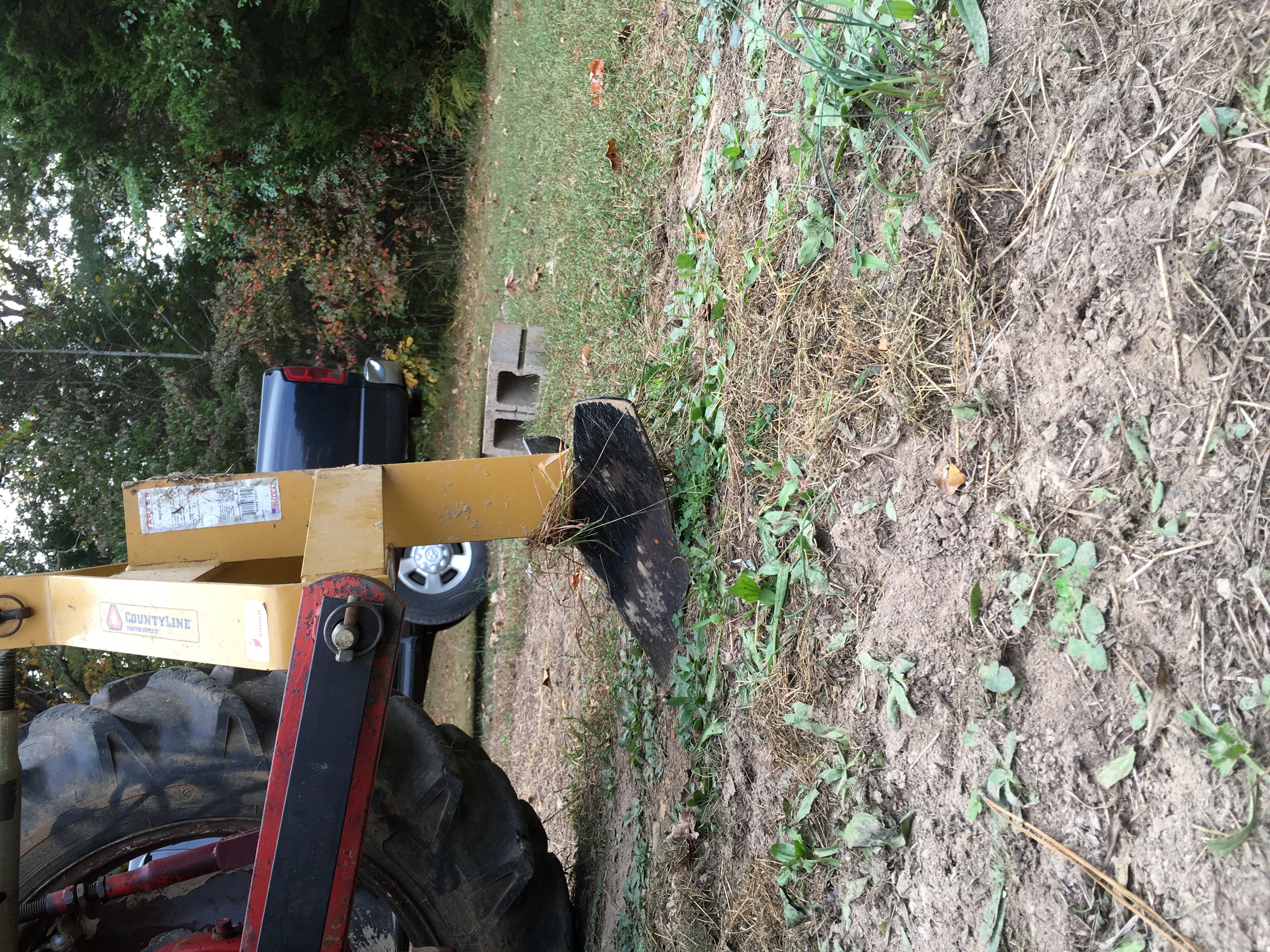

I did some adjusting as was previously mentioned in this thread but it didn't seem to help much perhaps my ground is too hard and I need the sub soiler first. I made a couple passes about 20 ft long and it only went below the sod. I went over it again and it just pushed up what was loose and skimmed across the top.

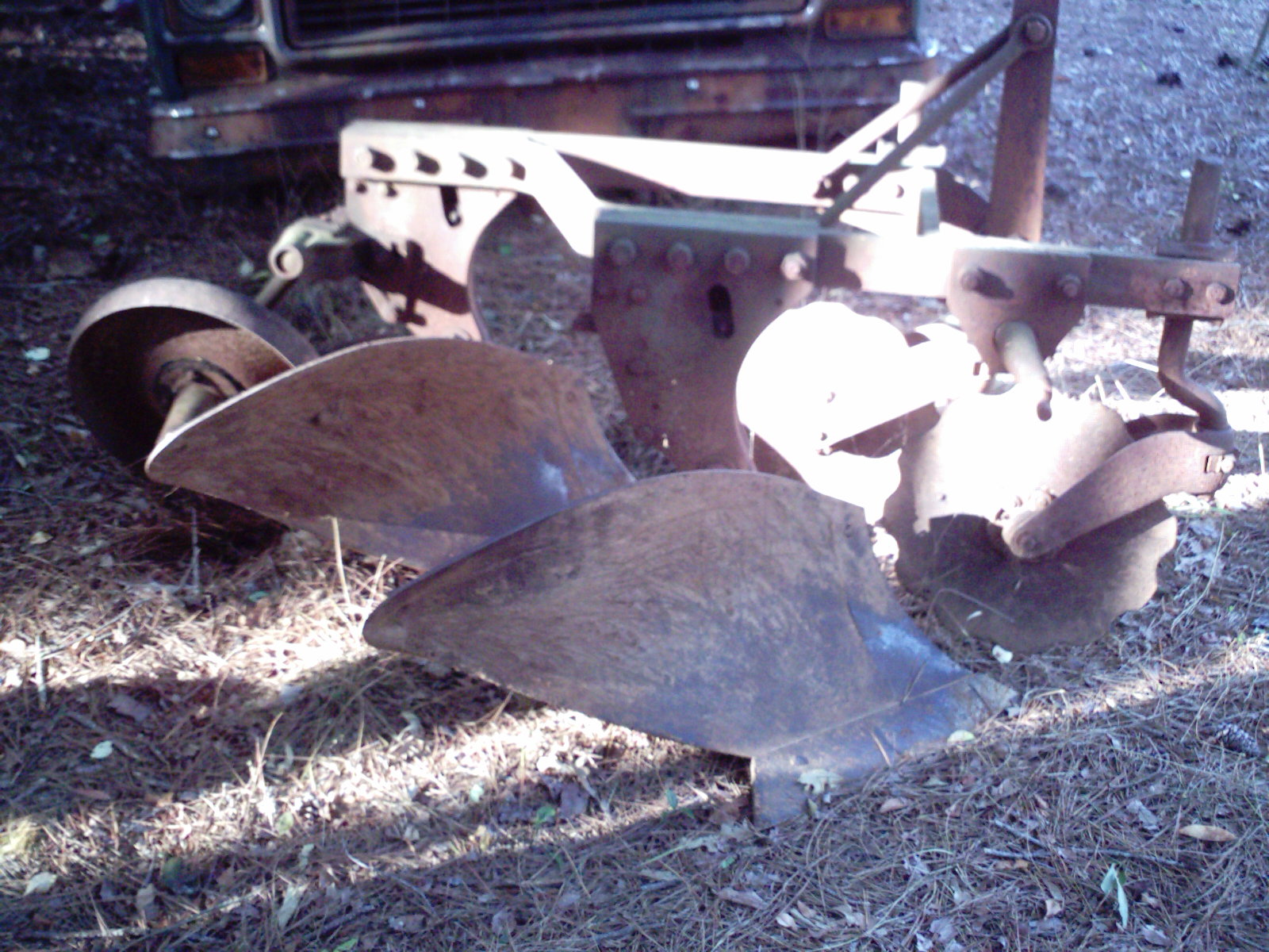

Your ground needs to be turned under or over with a plow whether it's a moldboard type or disc turner or maybe a chisel plow then run a disc harrow over it to bust up the clods. You can find these plows on Craig List for cheap usually. A single moldboard or a double would work. Then you need a disc harrow probably a 5 footer or a 6 footer would work. On the disc it would be better to find a double row but you could live with a single you'd just have to run it a lot more. Double row works better.
The stabilizer bars are used when you need to keep your implement straight behind you instead of it drifting from side to side. You need them while laying off rows or pulling a planter to keep the rows straight. You got to have them when you're pulling a cultivator to get rid a weeds and loosen the ground between rows in your garden. If the cultivator drifts it'll wipe out your veggie's. You don't need the stabilizer bars when you're pulling a turn plow but you do have to have the plow set up right. There's some good information on this site about setting up whatever kind you decide to get.

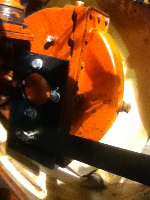

I finally built my stabilizer hook up while not as custom looking as yours it works. It's built from 3/8" plate and maybe it'll be stiff enough not to bend we'll see. Thanks again for the idea.
