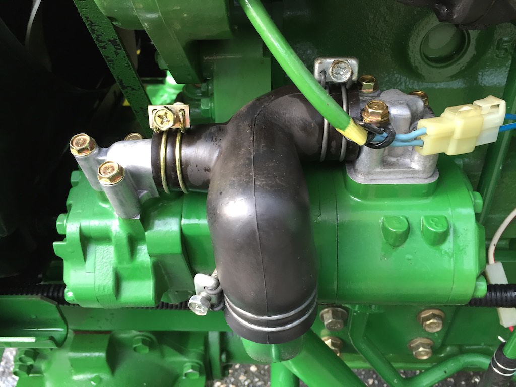

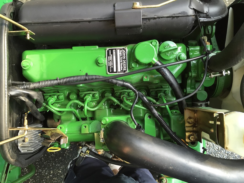

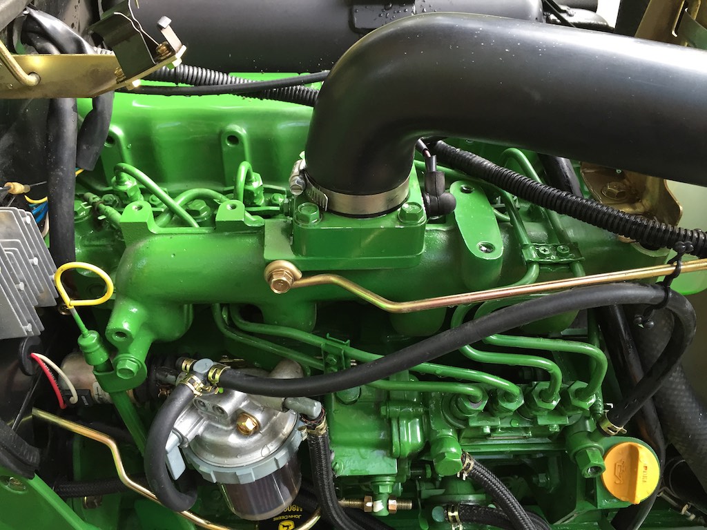

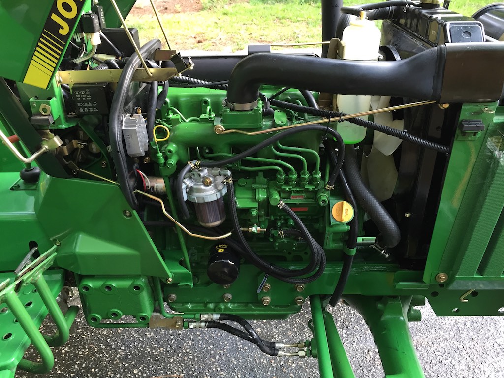

Here are a few more shots I took:

With respect to the tractor, I changed all of the fluids and filters in the tractor this morning, with the exception of the front axle which I will do shortly. I found an NOS mid PTO kit and it arrived today so now I get to drain all of the hydraulic fluid again so I can install the mid PTO. I am keeping my eyes out for a nice 72" belly mower. With your comments and the comments of others such as foggy111, I very well may get a lighter bush hog. Maybe a 4' frontier. Interestingly enough, I am finding this tractor to be much more fun than I expected. Not only is it fun doing the basic maintenance on it, but each thing that I install makes it more useful to me. I fertilized our pasture yesterday and thoroughly enjoyed every second of it, even though it was pretty warm outside.

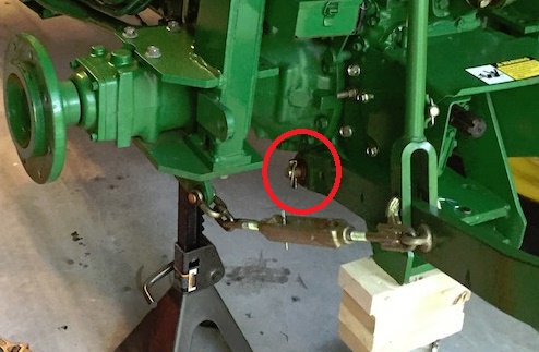

Great pics of your mid PTO addition. I could only add a suggestion to replace the quick lock pins that keep the lift arms attached with bolts and lock nuts. When brush hogging, the brush can rip them off (don't ask how I know that :) ) and leave an arm slipping off and a potential for breaking a casting. Very little occasion to have to remove those 3 ph arms so having quick lock pins there doesn't seem like the best idea.
As well, getting a brush hog that is compatible with an iMatch quick hitch is a treat that you won't regret. All my attachments are iMatch compatible except for my old 5' rototiller.
This pic shows your tractor pic with that quick lock pin circled in red.

Thanks for the advice. I won't be taking the lift arms off on a regular basis so I will replace the quick lock pins with a more secure setup; bolts or some other design that will not be prone to coming off. I will be doing mostly bush hog work, so your advice is much appreciated!

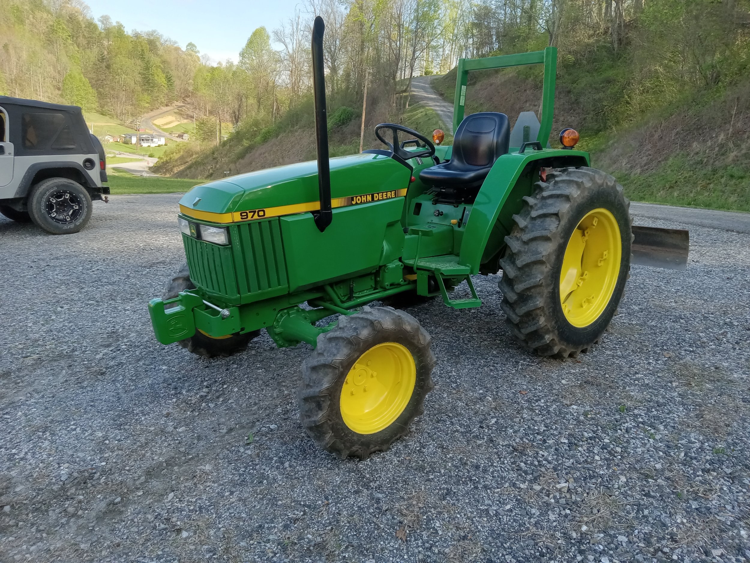

Hi Joe it's normal for the 970 john deere they never recenter the steering wheel because of it being hydraulic. On the two wheel drive or four wheel drive you can spread the wheel base causing it to be more stable on hills. I service mine once a year and the air filter every other oil change. The engines in this year model are bullet proof and never give any problems mine is a 92 model. Your tractor will handle a five foot finish mower with no problem!
