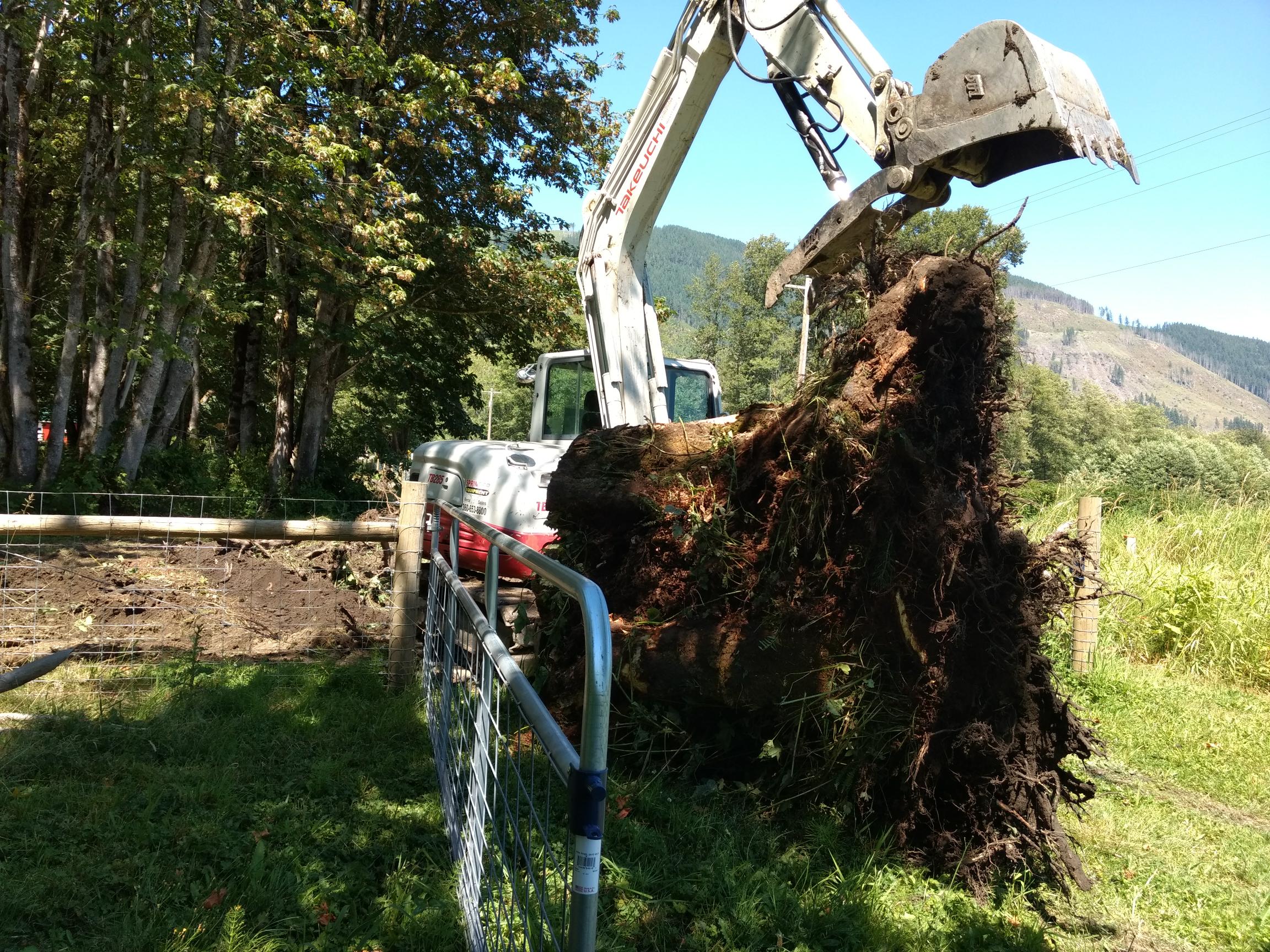

Here's some recent work (20k lb excavator- took me at most 1 hr to extricate this stump):
Most stumps I bury, which requires digging huge holes (easy with an excavator like this). The one above, however, I decided to dump further down on my property; I couldn't carry OR push the stump, in which case I had to roll it, operating the backhoe going backwards. I would NOT be able to have done this with any CUT backhoe.
In another month or so I'll be renting a smaller excavator to clean out ditches. I can knock off hundreds of feet clean-out in no time. With a backhoe you have to keep raising and setting the stabilizers. Do not underestimate the value of your time: keep in mind that doing something the first time seems like spending a lot of time is OK, and it probably is, but later on, once you have a lot more things to maintain, doing it a subsequent time you start to feel the need to get it done a lot faster.
