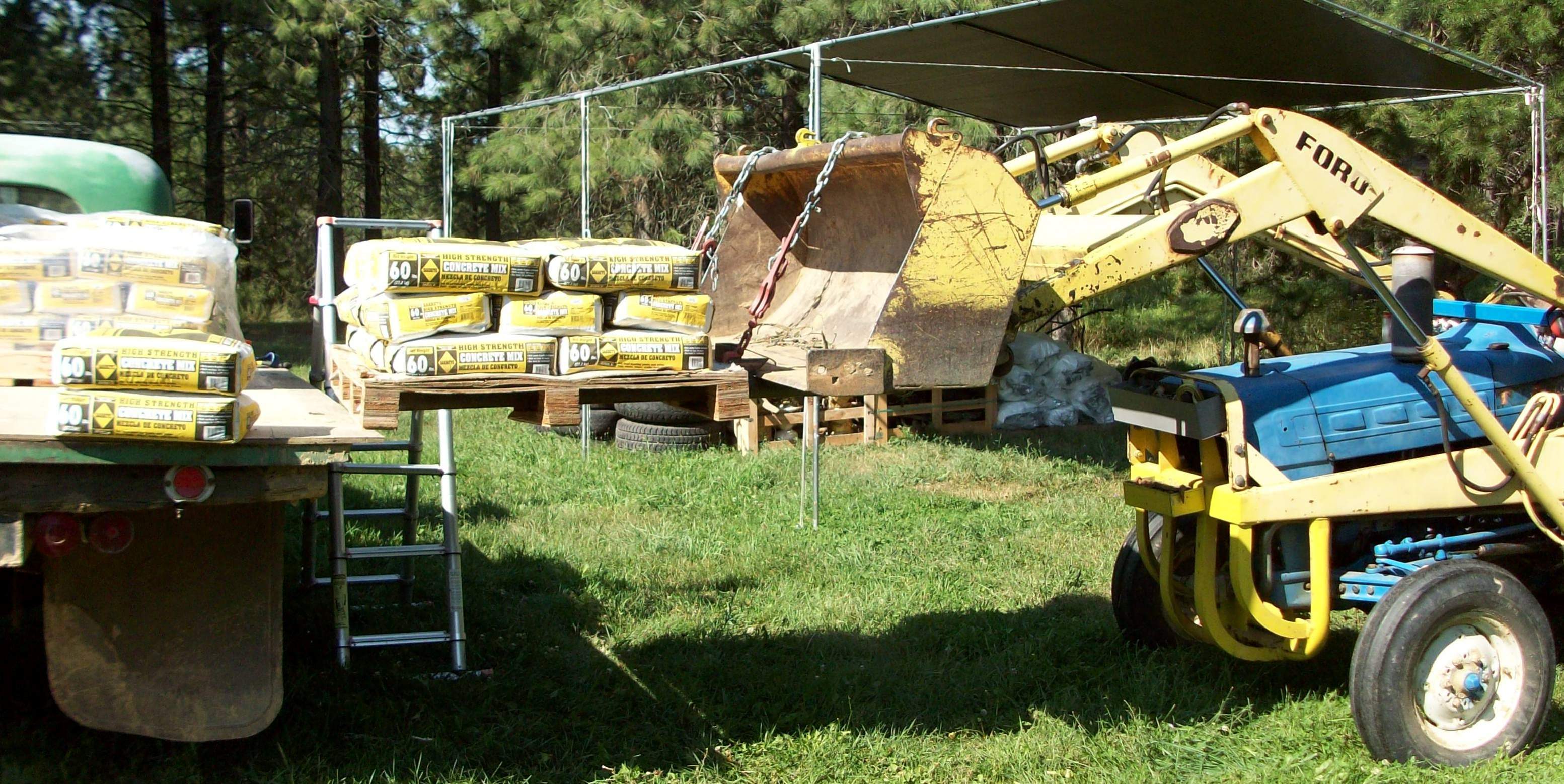

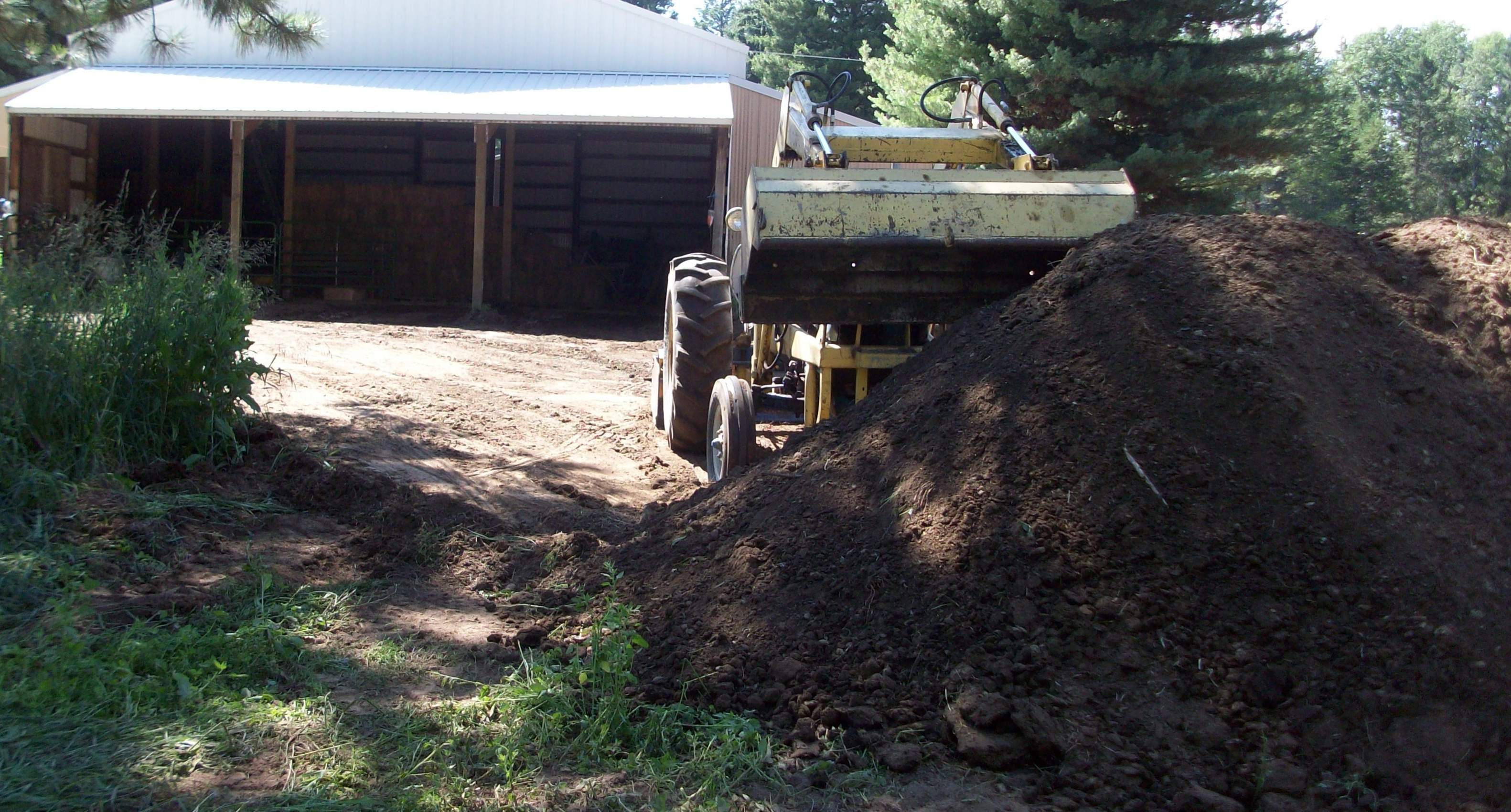

Nice 850 Soundguy You have a real spear- i have been cheating a little bit using a round add on bucket pallet fork- will get a real spear this next year but it has worked well so far it does take a little extra push to stick the round bale though here's the 3000 after cleaning out the horses run outs barn run out cleaning-ford 3000 001.jpg and to show the lift capability of the standard ford loaders- 1440 lbs. of concrete being removed from my 1940 international DS 30 International dump truck 100_2231.jpg
Nothing wrong with the kubotas - but to get into one that will lift and carry the round bale weight on the FEL that is the norm- will cost considerably more than one of these older tractors, but they certainly can be found but for more money...
