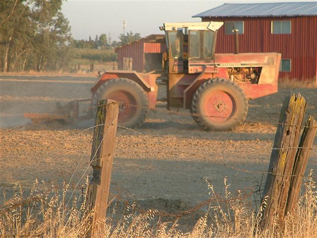

Two of my neighbors have 35 hp Bransons and seem to like them. Heavy tractors, pretty simple--much like my Mahindra 5525 (54 hp engine, 45 hp pto).
Another neighbor does 30 acres of irrigated alfalfa. He uses a MF 294 for planting with a Brillion seeder, for discing (when needed), and for raking with a dual side delivery rake setup. When he established the field a few years ago, he used a D7 Cat to pull a subsoiler to break up the hardpan down to about 2 feet depth. He does shallower ripping with an IH 4366

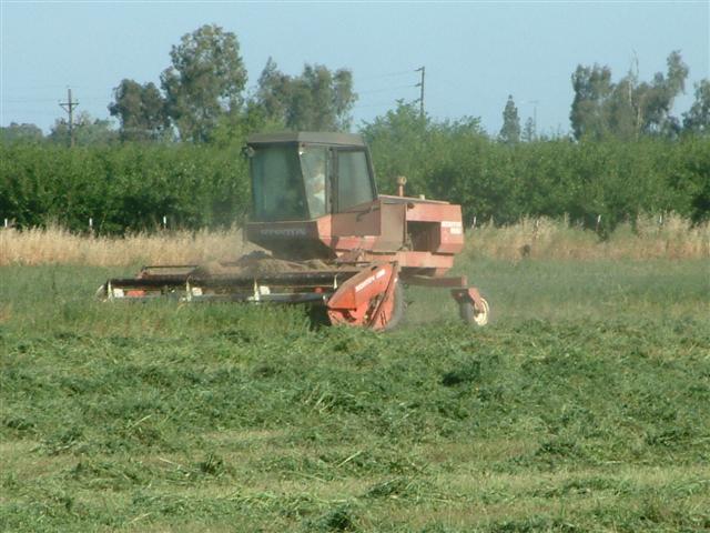

He mows with a Hesston swather (13-ft head)

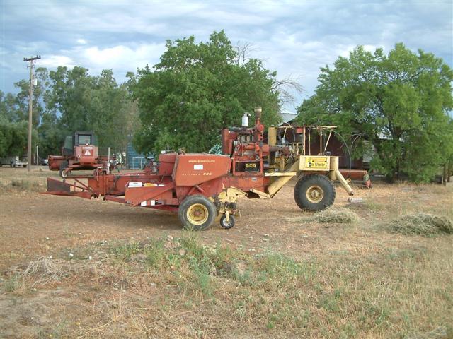

and bales with a self-propelled NH500 baler
