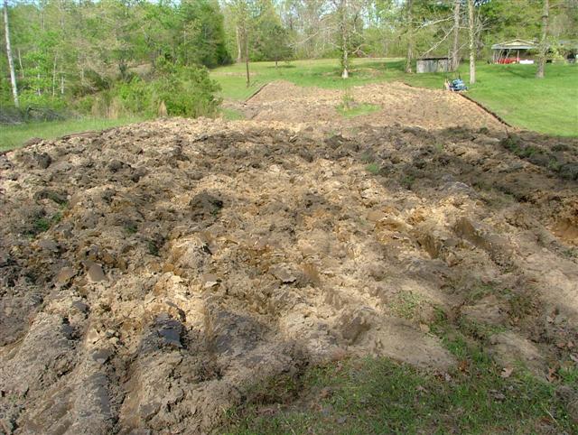

I did my first plowing today. There is a learning curve and it got easier as I went along. There was some roots to cut and a few of them tripped the shear mechanism thing. I found it snaps back in place.
The grand day out finished when I was going over a already plowed piece and the tractor bottomed out on a high spot and I got stuck.

What did you use to plow with?
Solo
   / First time plowing
I was pulling with a Ford 3910 (47hp) and the plow is a Massey Ferguson 42, two bottom moldboard. It bogged a bit in the wet ground at the gully.
How deep should it plow? Is the depth adjustable? Next weekend, I'll run a disc harrow over the plowed ground.
   / First time plowing #4
Looks good. Sounds like you had a good day in the seat.:)
   / First time plowing #5
The depth should be adjustable.:D
How deep you wish to plow may depend on what your soil conditions are and what you wish to accomplish.:D
After the disking your back may be a little sore!:D
I did have a good day, thanks. I got sunburned, a stuck tractor and sore muscles but It was still good.
   / First time plowing #7
If your plow is a 12 in. you should plow at about 6 inches, a 14 in the depth should be at 7 inches and so on.
It's a 2X14 or maybe a 16". I'll need to check the manual tonight,:D I think it's a 16".
