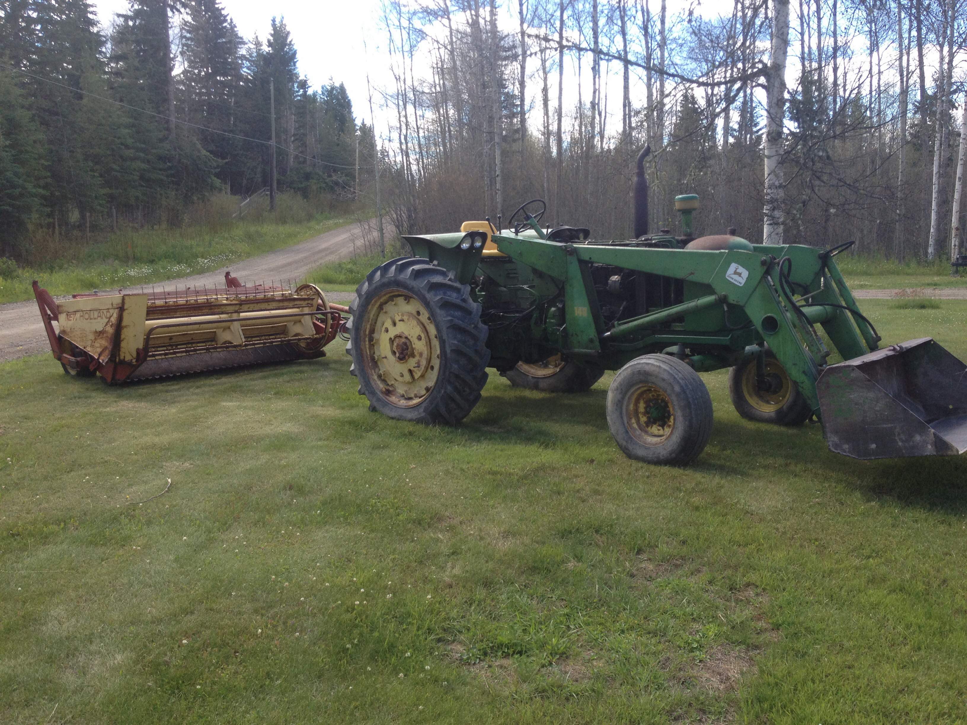

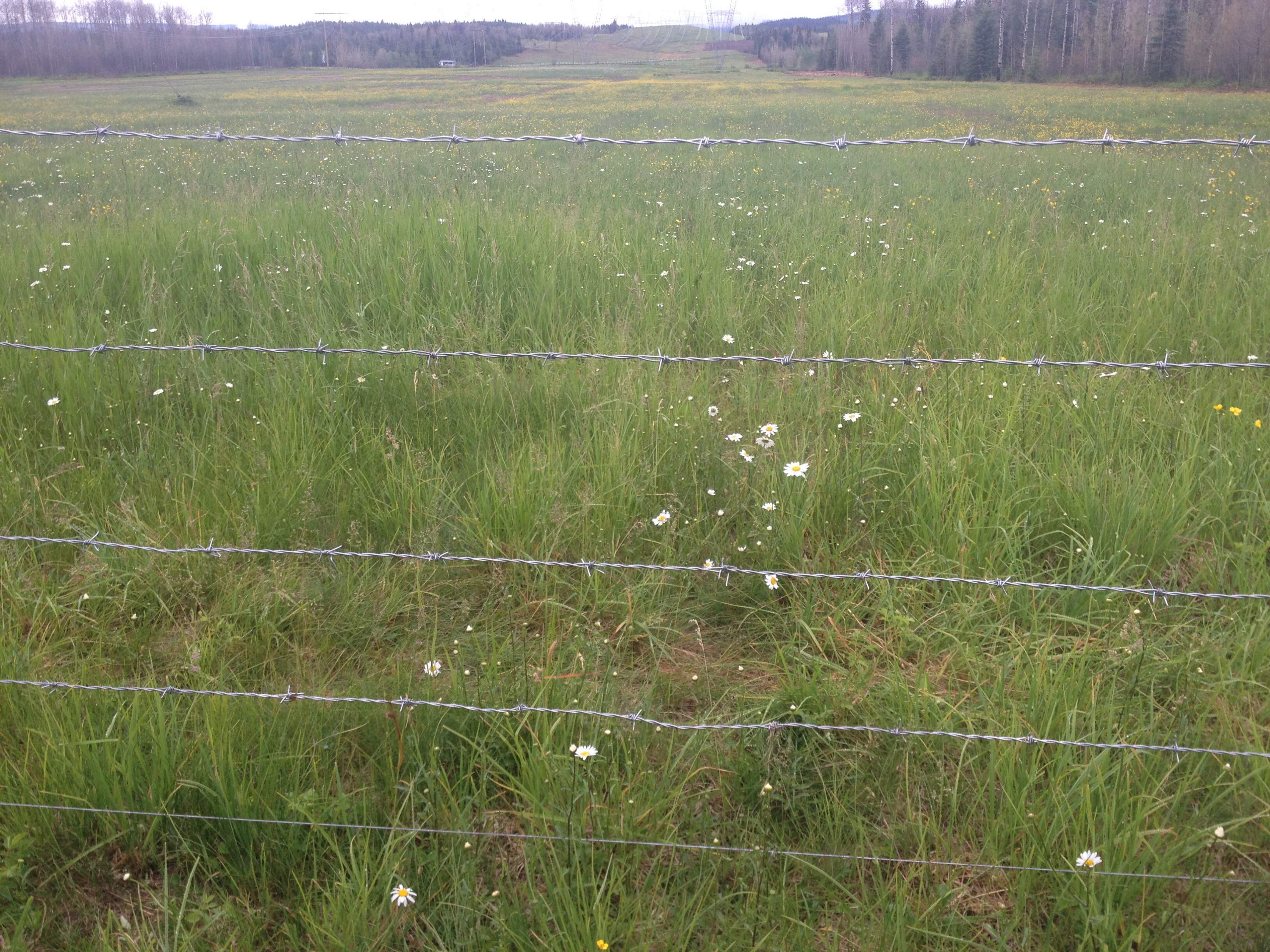

image.jpgimage.jpg was looking great up to a couple weeks ago when the daisys and buttercups started to sprout up. I picked up a new holland 478 mower conditioner. Gonna grease and adjust everything up, weld the tire back on my tractor and try all my equipment out ahead of time. About a month left here until cutting time

Also wondering if my grass base looks strong enough to do good if spraying for weeds with something like grazon?

On weeds, my cows loved butter cups and some other selective weeds.
I used Grazon P+D one year. The P was for brush and the D was 2-4-D, a popular broad leaf herbicide. I don't have any brush any longer and quit renewing my applicator license so I can't buy it. But I do go to the local farm store and buy D in quart bottles (not restricted) and mix at 1% (1 gallon in my 100 gal tank). D is a broadleaf herbicide and that's what you want for weeds in a grass patch.
I like D as it works the year you put it out and keeps working. On completely eliminating weeds, unless you spray often forget it. I have a field I have worked with a crop for over 30 years and every spring here they come. I notice it mostly when I have plowed the field. I guess plowing brings them up to the top where they can germinate.
