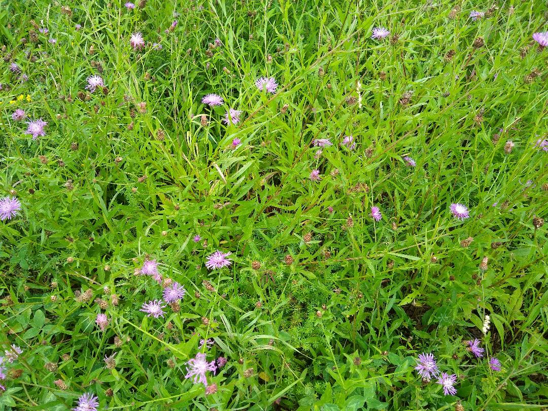

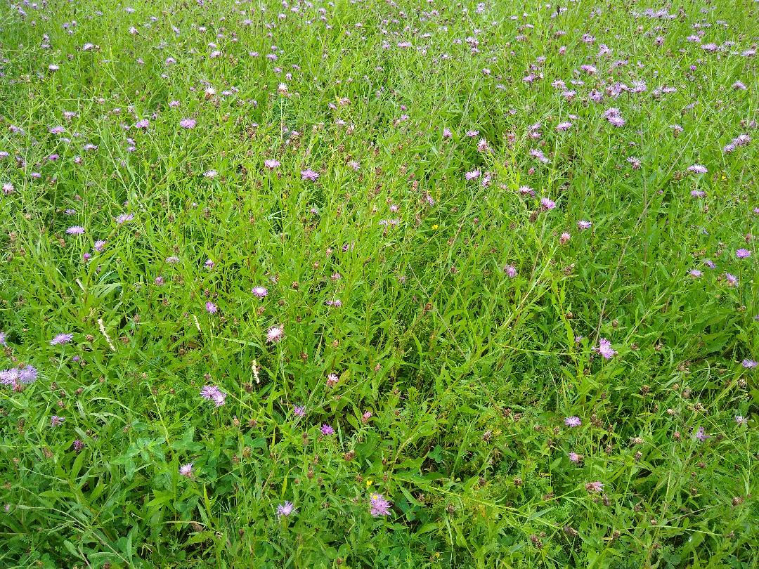

So tomorrow they deliver a new Woodmaxx 78H flail mower. I'll be powering it with a Mahindra 2545 shuttle. 45 hp with 39.5 at the PTO. Since I have never used one before are there any sit tips that I should consider before I go knee deep in this. I read that this model should be run with just the roller touching. And the front slightly up. IMG_20190731_124423056.jpgIMG_20190731_124429008.jpgIs this true? I'll be mowing about 7 acres of this.

Go for it . . . from your pictures you provided . . . that is nothing that flail can't handle.
