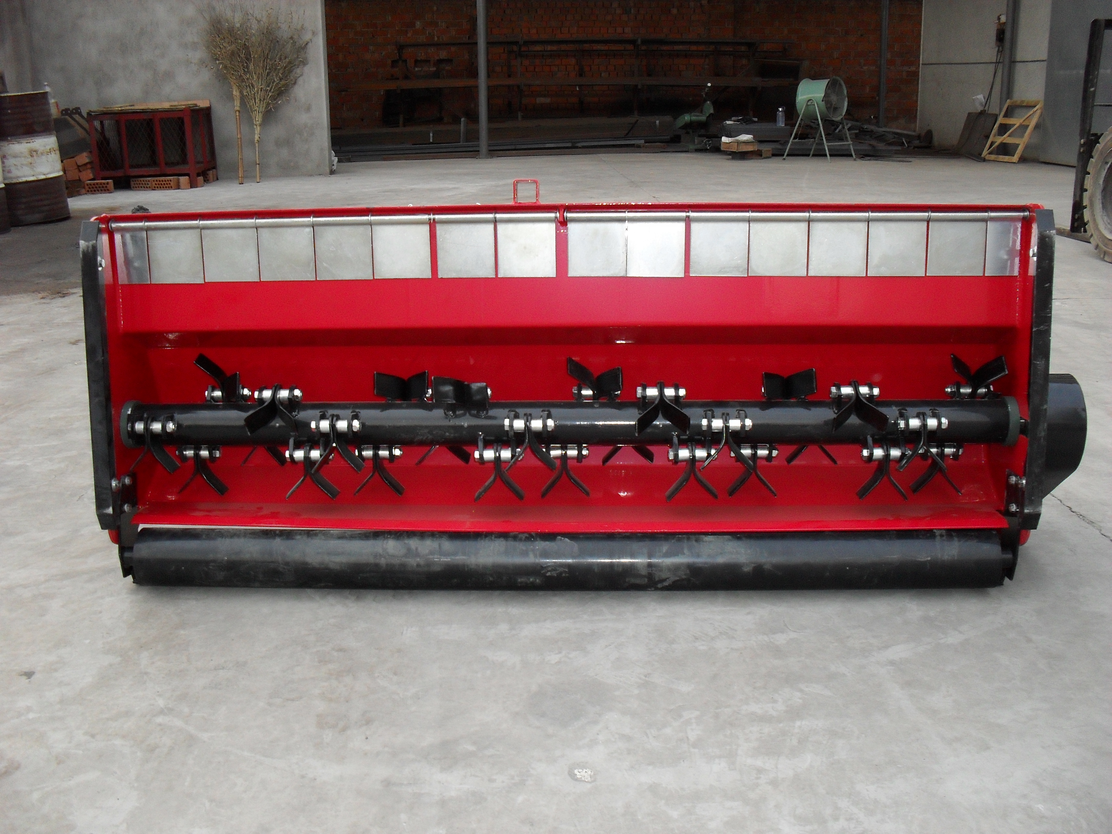

So I lowered the cut height by one position, 3/5 instead of 4/5, and the cut quality is greatly improved. Not perfect, but acceptable. Thank you all very much for taking the time to help.
At a glance, the blades that came on my unit have a similar edge to what you'd see on a new push mower blade. Hopefully, I can procrastinate on sharpening the 54 individual edges until it becomes a winter project.

Flail mowers don't like to mow high and/or thin sporadic growth. They actually need to create a vacuum to pull the growth toward the cutters..
This makes a ton of sense. Insight appreciated
EF mower is light duty flail mower, I only recommend customer cut grass less than 15 inch height if with flail hammer, less height grass if with the small Y knife you bought.
I suggest you to drive slow, sharpen those Y knife, lower down the roller position. Hope this could help you.
Flail hammer is more suitable for you, but not this Y knife.

The closer the flail mower knife is to the sod the more efficient the pressure gradient becomes to create a vacuum to lift the brush up and cut it and then recut it as long as you travel slowly while mowing.
It takes very little time to sharpen flail mower knives with a wet well grinder as neither the side slicer knife nor the cast hammer knife become hot to the touch and one pass with the gauge set at 37 degrees is plenty as long as the knife is clean of grass dust.
This can be down using using a diluted bleach solution with dawn dish soap and a small parts scrub brush with stiff metal bristles.
