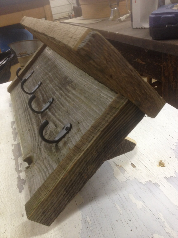

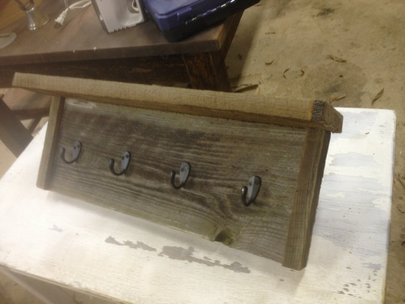

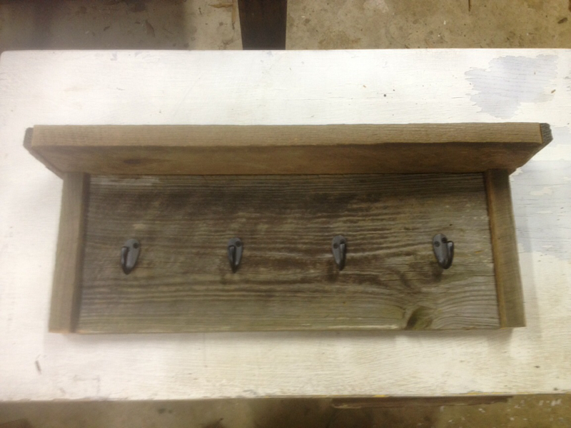

Started small...a key rack. I have tons of spare wood and plenty of ideas.

Very nice! Barn wood is absolutely beautiful when it takes on those colors.
I do have a question-what do you do to make the new saw cuts look aged? I couldn't see any place where it looked like fresh cuts, so I'm assuming you must have a method to make them disappear or blend in with the rest of the patina.
In any case, it looks great. Thanks for sharing.
   / First project with the salvaged barn wood
Very nice! Barn wood is absolutely beautiful when it takes on those colors. I do have a question-what do you do to make the new saw cuts look aged? I couldn't see any place where it looked like fresh cuts, so I'm assuming you must have a method to make them disappear or blend in with the rest of the patina. In any case, it looks great. Thanks for sharing.
On most of my pieces, I cover the cut edges with trim strips from other pieces. I've cut several boards for a table I'm working on and I have to have clean edges to glue, so I save the rough edges to trim out the smaller pieces I make. Also, for corners and such, one of the tricks I have used is putting an old, almost worn out belt on my belt sander and smoothing the corners with that. It doesn't take too much off, and slightly burns the wood and gives it a more aged look.
   / First project with the salvaged barn wood #9
Got it. I wouldnt have thought to try a sander. I'm planning on a couple of projects in the next few months so will keep that tip in mind. Thanks!
