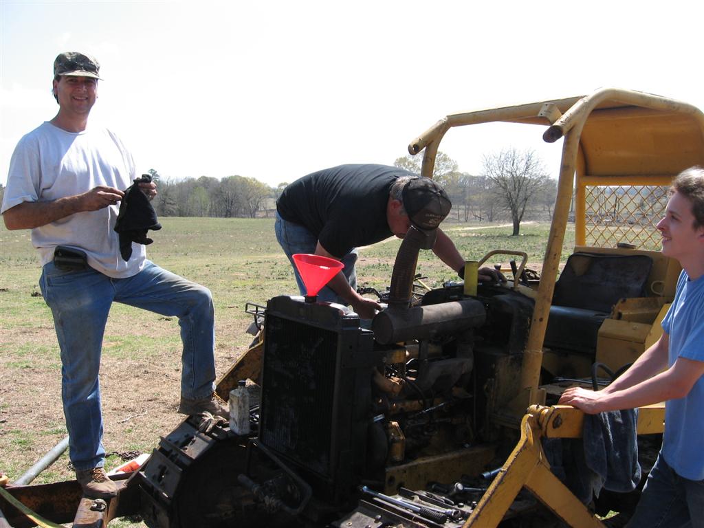

Dude, give us the broken camera story, you know it dropped and was crushed by the dozer. Not the greasey hand story.
When I'm up at the weekend place I never know what I'll be doing or where I'll end up or what I see. So as you can see on my hip I always have my camera. This time is was helping my BIL put in a new engine in the JD350. We arrived at the right time, he was just about done and couldn't get it started. The injection pump was out 180 BTW. :D
Yep we dig pics man!
