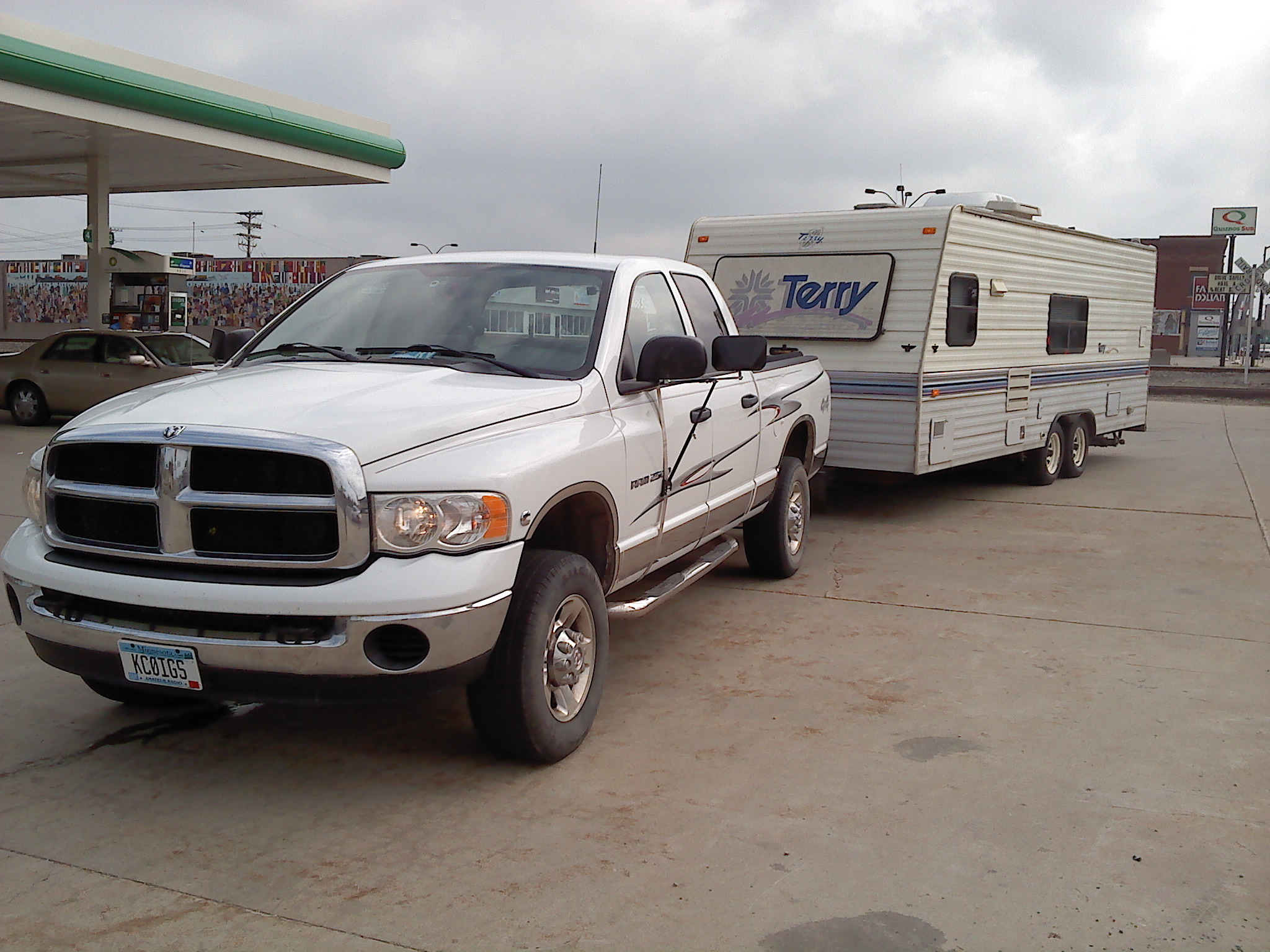

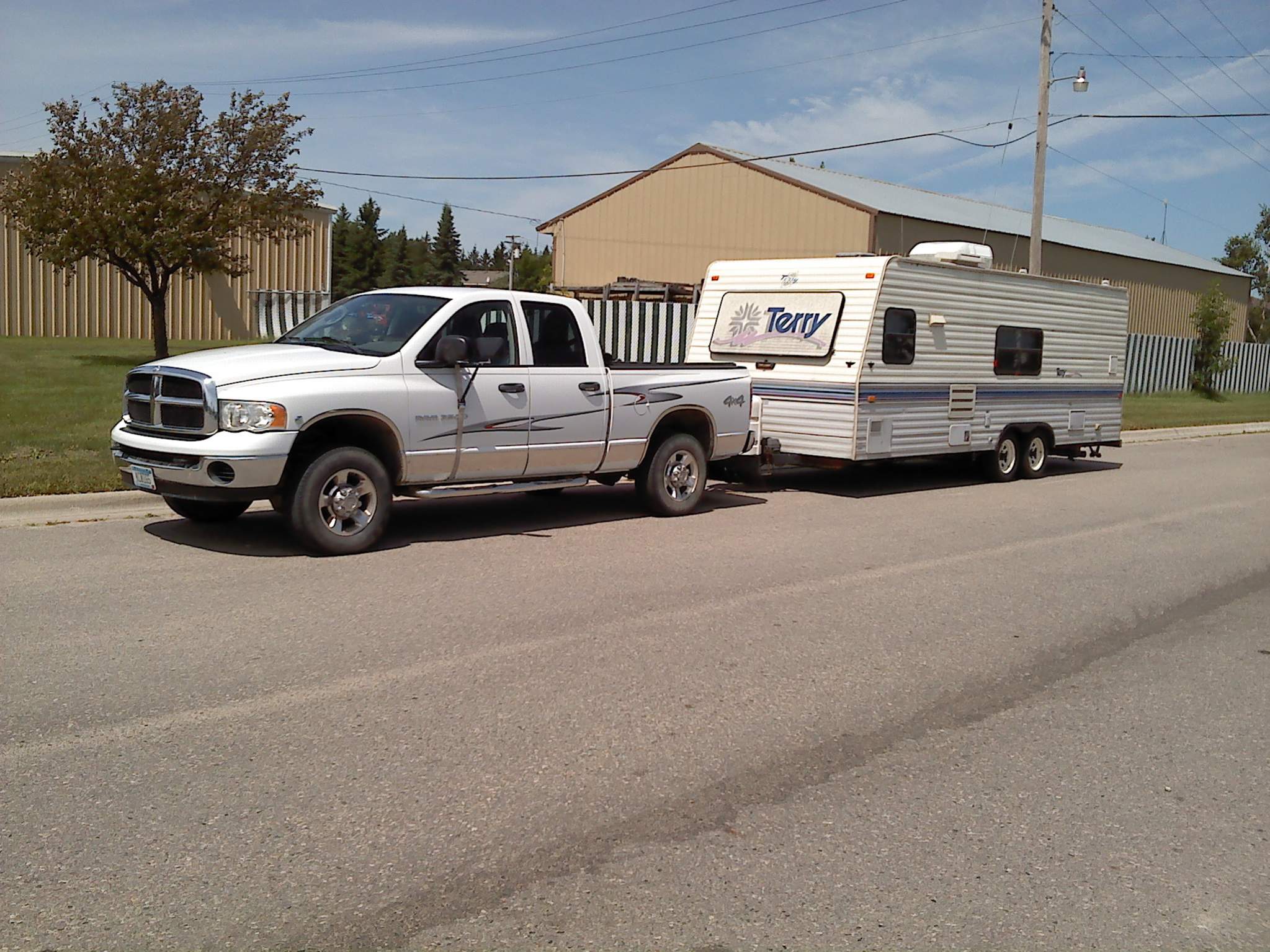

Last fall, as maybe a few on this forum may remember, I bought an '05 Dodge Ram 2500 CTD for my various truck duties. Throughout the fall, winter and spring, I have hauled firewood and tractor and boat all over the county, and while generally impressed with the power put out by the 5.9 Cummins, I haven't really had a chance to let it stretch its legs with a decent load for more than an hour at a time.

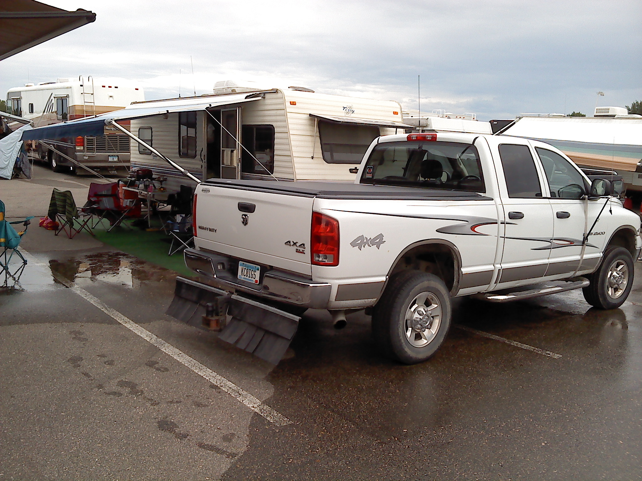

Enter Paul. Paul is my oldest son. He just graduated from high school and joined a band. They have been working hard all Summer and somehow managed to get signed to play at Sonshine. Sonshine is a major Christian music festival in Willmar, Mn. We live in Warroad... the opposite end of the state. I eagerly awaited this trip as a chance to pull out 24ft, 6000 lbs. camper for a 520 mile round trip.
For reference, last time I pulled this camper, I had a 1994 GMC 1500 Suburban w/5.7l engine. I averaged 6.5 mpg with that configuration, struggled in headwinds and dreaded any little hill that presented itself before me, so was hoping to do much better. I wasn't disappointed.
I averaged 60 mph for most of the trip and even pulled 65 for a couple hours of interstate each way, so I wasn't necessarily poking along, but I wasn't in any races either. Just making good time. My Dodge has the automatic, so I put it in tow mode and took off. I immediately noticed that the Dodge never even hinted at downshifting out of overdrive, whether we were bucking a headwind or going up hill. The turbo would just spool up and the cruise control would keep it within one mph from where I had it set, no exceptions. Another thing I noticed was I could actually pass slower motorists with relative ease. Even so, I tried keeping a light touch on the peddle, as I don't have a transmission gauge yet and I don't want to wreck the tranny by doing stupid stunts.
My wife commented on the extremely smooth ride, once we had a decent load on the truck. For the record, we use an equalizer hitch, so we can transfer some weight to the front axle for handling purposes, but I doubt this truck really needed much help in that regard, as everything looked pretty level when it was first hooked up. At any rate, I cranked a little pressure on the equalizer just to be sure.
MPG? Wow! What a difference! The old Suburban got 6.5 mpg, the Cummins got 11. Even with the higher price of diesel, we were definitely money ahead for the trip, as well as a much higher level of confidence in the ability of our tow rig to get us there without undue stress or overheating due to running too close to the rated limits of operation.
Now I'm looking for an excuse to go out again!
Joe
