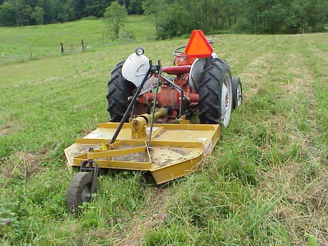

<font color=blue>I use the check chains all the time with my brush hog. It keeps it nice and level, and I never have to worry about it.</font color=blue>
Hi, RichZ. Could you take a picture from behind the tractor with the mower on? I am having trouble figuring out how check chains work. My BrushBull doesn't have them.

Hi, Mike!! Ask, and ye shall receive!!!
By the way, the check chains don't come with implements, you have to buy them seperately.
Here's the picture...
I hope it helps.

   / First Choice Vs Kingkutter #63
RichZ, thanks for the quick reply!
How do check chains work? Wouldn't the lower 3ph arms serve the same function?
   / First Choice Vs Kingkutter #64
Mike, the chains hold the implement in place better than the lower arms. You hook one end of each chain to the ends of the top link pin. Then, you raise the implement on the 3ph. Next, you attach the other end of the chains where the implement connects to the lower arms. You attach just enough chain to hold the implement at the level you want, and you lower the 3ph all the way. The chains hold the implement in place. You don't have to worry about the lower arms slipping over time, or when you hit the inevitable rocks. Nothing could be more stable.
   / First Choice Vs Kingkutter #65
Rich,
The check chains sounds easier then what I had been doing. I was adjusting the cutting height with the arms in the fully lowered position. Adjusting the arms with a wrench goes slow compared to adjusting a link of chain. Field adj would be easier, too. Thanks for the tip.

   / First Choice Vs Kingkutter #70
<font color=blue>...Is there any advantage to check chains...</font color=blue>
The major advantage is with older tractors where the hydraulics would "leak down" (chains tied to the top link mount as upside down V)
Using the chains as "flex arms" so they move with the terrain as a number of people do... I find to be very dangerous... at times the cutter can become very violent and will tend to "lift" up in the air... that "little bitty top link assembly" won't control spit by itself... /w3tcompact/icons/frown.gif
