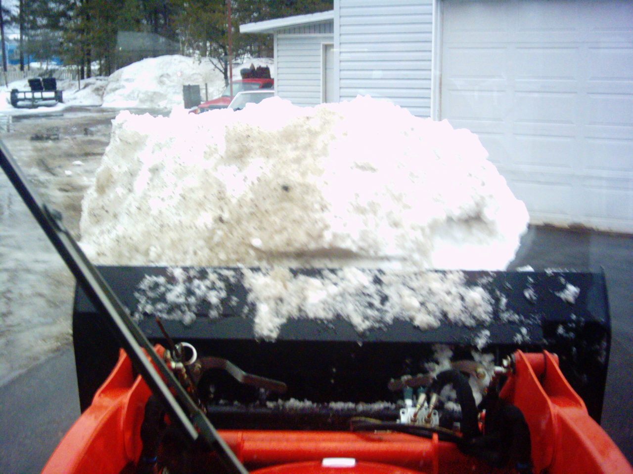

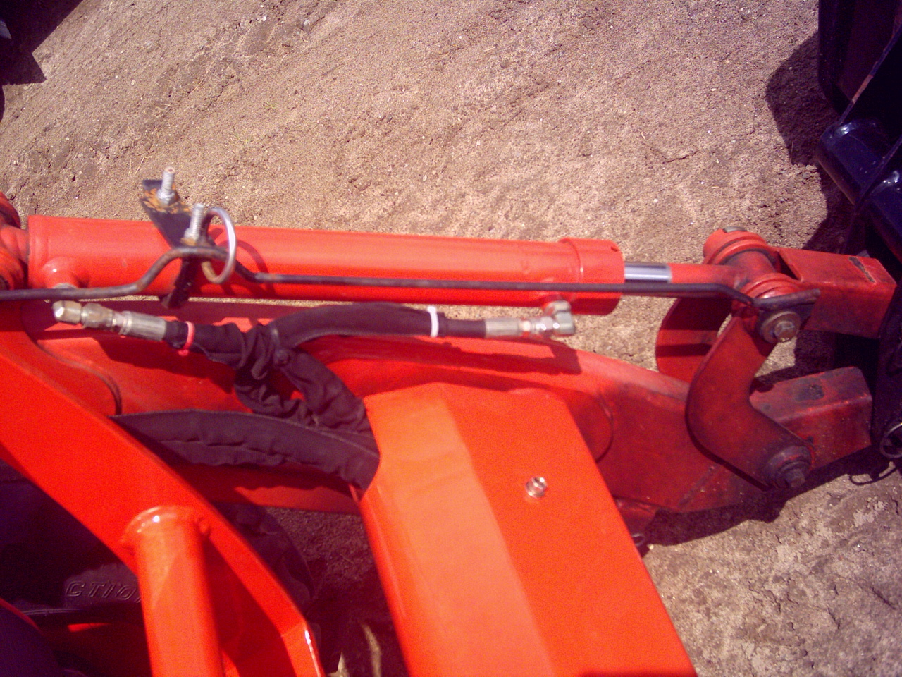

Same thing happened to me. I did remove the rod and guide, built another rod and made an ajustable guide, so whatever implement i'm using i know when it's leveled.:cool:
   / First Casuality on my new Kioti! #7
I too have dislocated the rod numerous times when rolling the bucket to full down.
Do you have any pics of your mod?

Here are some pics of the mod, i did mount it on the left side, since my diverter valve is installed on the right. I did do this on my DK45SEC, put no more tractor=no pics:( It was simple enough to do, took about 20 min.
