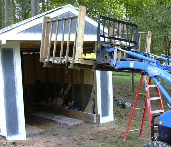

</font><font color="blue" class="small">( Any of you see a safety problem with building a basket for the forks to climb into and do high work such as second story on the house etc? )</font>
Screwed 2 pallets, some 1x6's to complete the floor, and some old porch railing to make a man-lift. I drive into place, raise the loader, chock wheels/keep in gear/set parking brake/drop implement on ground/lock the joystick, and use a ladder to climb up. Works well. See attached picture.
Mark

   / First 2 days of a TC45DA.
#14
Markie,
