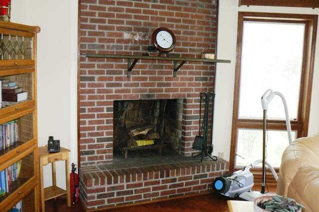

Well, after a couple of years, I'll be replacing a gas furnace with a heat pump. Decided that I'm going with a ventless fireplace insert for backup heat. Since we've been here, the missus always wanted a new mantle for the fireplace (which we never use).
Since I know nothing about fireplace mantles, any sugestions on what to look for or ideas for bolting somthing in?

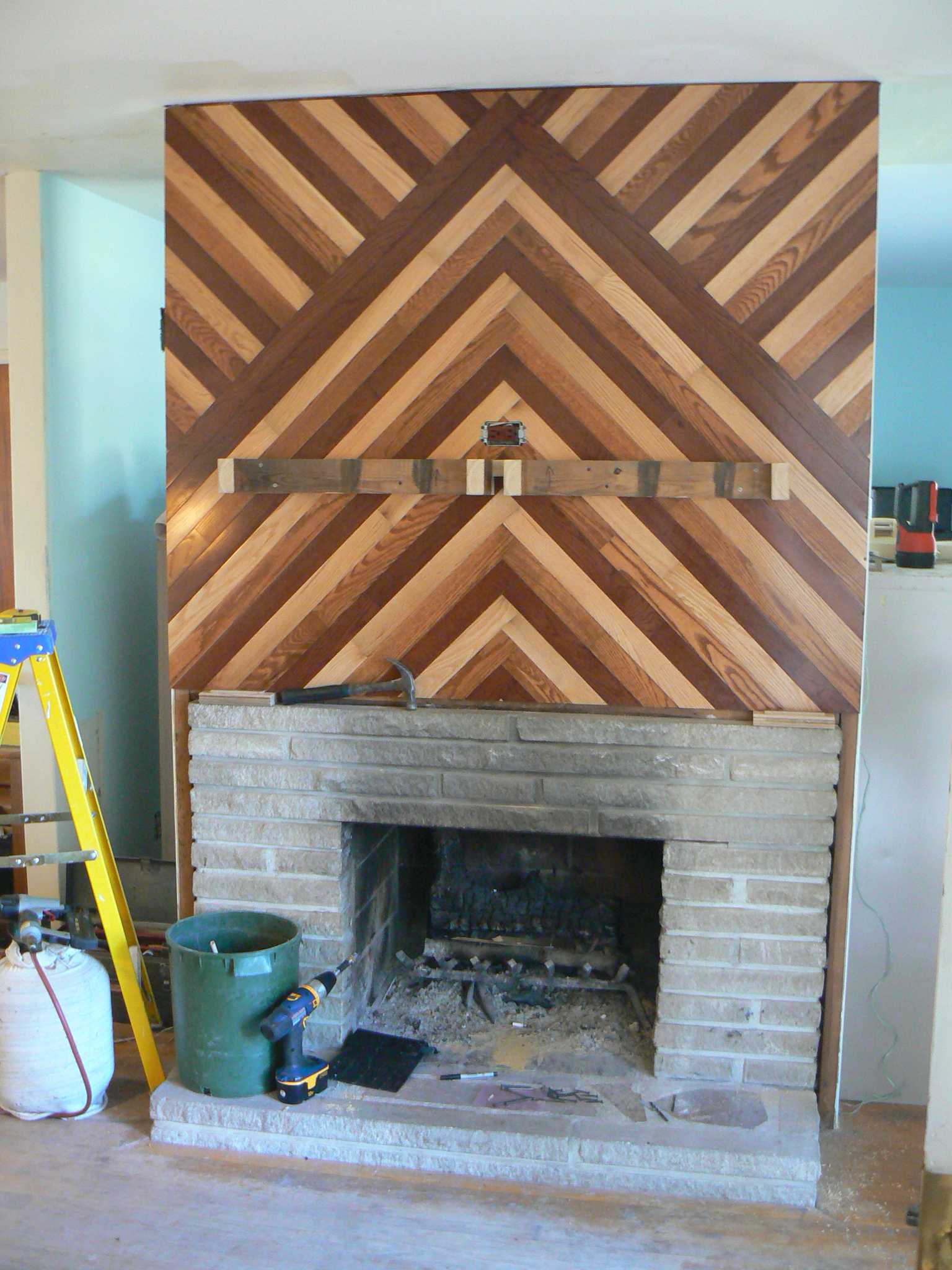

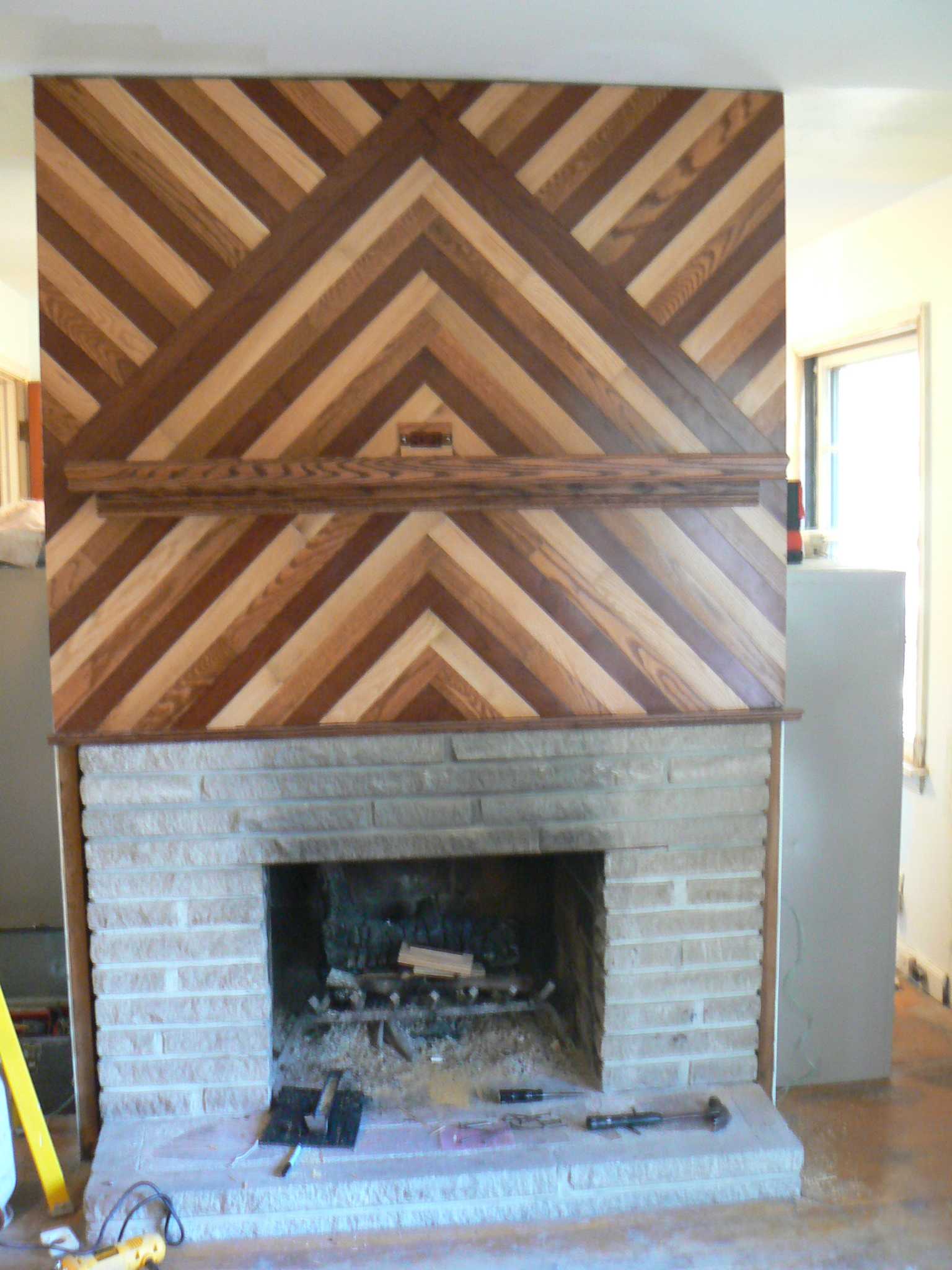

Here's a couple of pics of one that I made for my best friend. The mantle was built using several different oak moldings tacked to a frame. Basicly a box with the back open. The mounting support is a 2X4 trimmed down a little so the mantle can slide over it. It's attached to the fireplace with some Tapcons.
The back of the fireplace is three different shades of oak flooring tacked and glued to 1/2" plywood. Best part was that I had all of the materials so it didn't cost anything to make.
