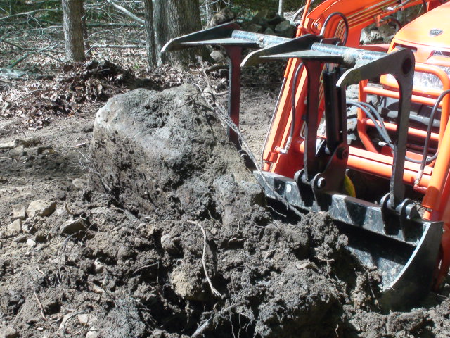

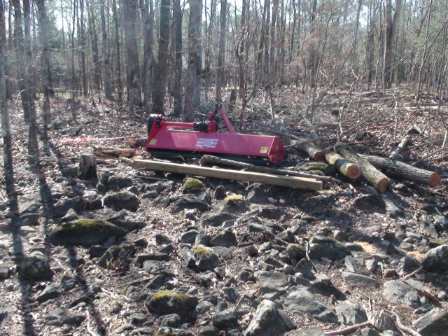

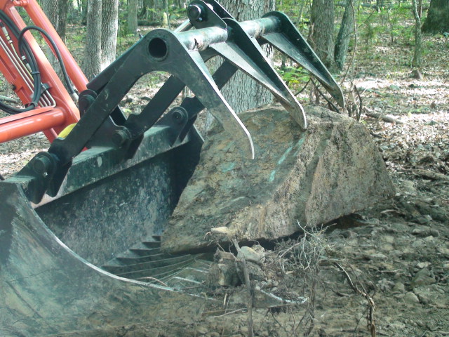

Yep. Large scale maps of most types for anything are great for an overall look. But in my experience at the micro level are not as good.
Example: When I bought my property a few years ago, I knew it would be a troublesome piece to get septic approval, underground power installed and overall drainage. A few pics are attached of what I dealt with. A neighbor down the road built a basement access home on a hill side culminating at a large pond. They had no large rocks on their property. Mine looks like a glacier ended here and dumped its largest rocks in the front half of the property. Other neighbors also had no large rocks.
It appeared the original owners were unable to get septic approval as there were several backhoe pits dug at various locations at sites obviously not suitable. I made my initial try at septic approval and failed- twice. I then hired a soils engineer for a reasonable price and a track hoe. The soils engineer thought we may not be able to make a septic work and totally disregarded the front half of the property as it would not work. With his experience he directed the track hoe to various places and finally found the mother lode of septic drainage soil, which put the drain field ~ 200' down slope from the proposed home site which set on rock.
So my point is each site has its own unique soil conditions and a soils engineer can provide the exact information you need for a reasonable price.

Wow, that is some really rocky land. You could easily break an ankle there.
